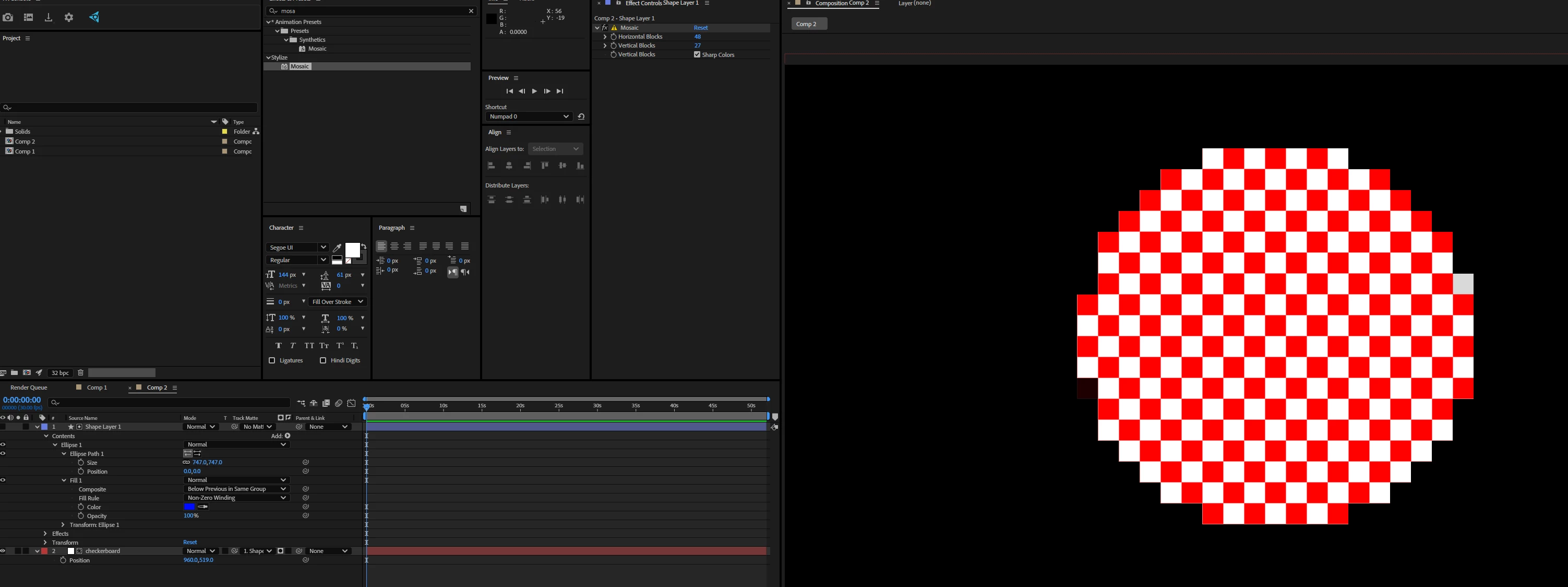

ShiveringCactus
ago 8, 2025 8:45 a. m. UTC
I think I'd do this using the Mosaic effect on the circle layer and settings the block width and height to match the size of the squares.  I did this by knowing the size of the squares, then taking my Comp's width and dividing it by that number (e.g. 1920 / 40) and then doing the same for the height (1080 / 40)
I did have to cheat a little to line up the squares, but as I expand the shape the underneath blocks pop into existence.
