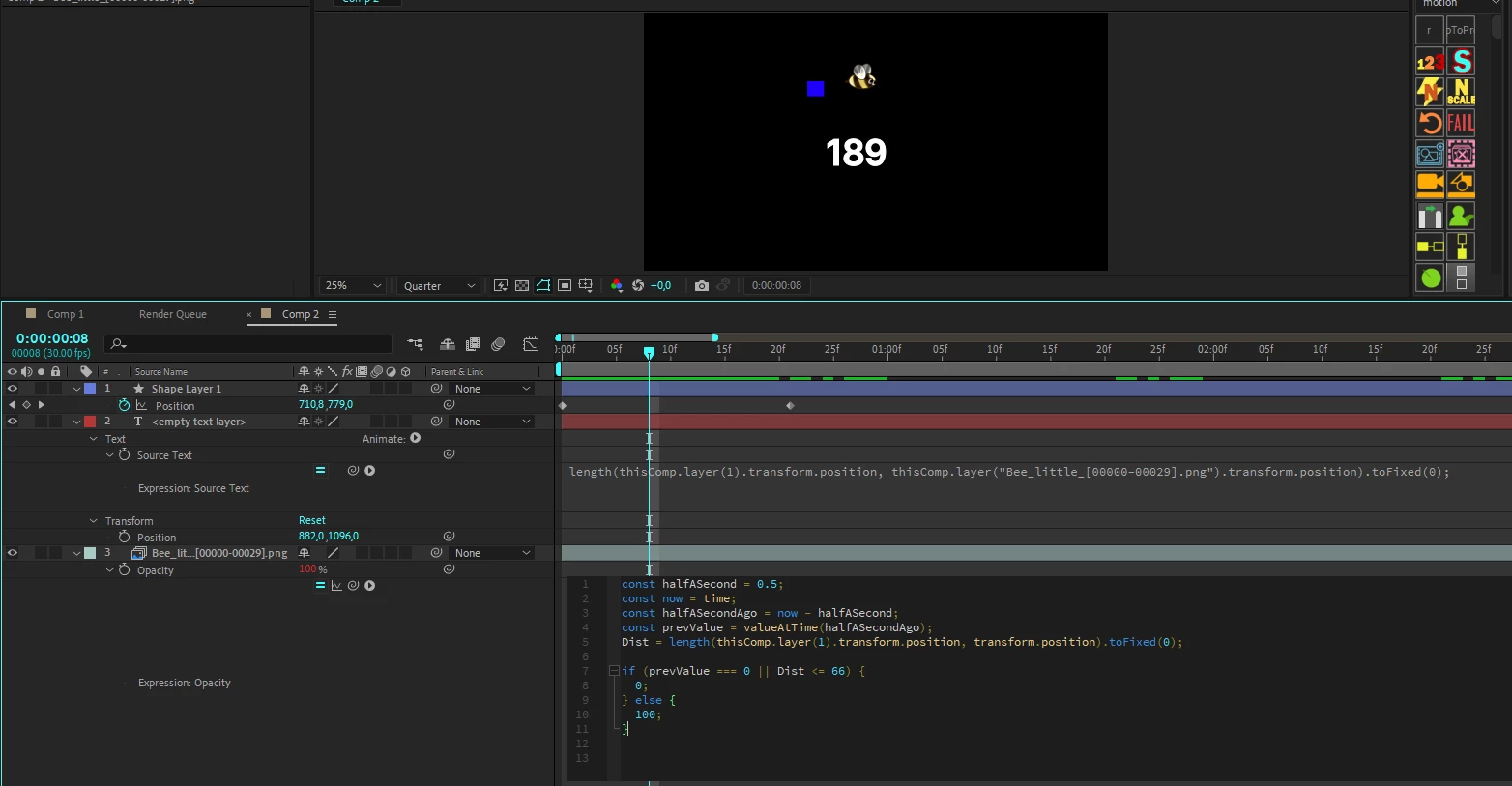

I have a certain structure:
With the Text layer, I display the distance between the two layers and, starting from the minimum number, I prescribe in my condition at what distance the opacity of my object will be 0 and he disappear
(Blue square is moving and bee need to dissapear when square come close to my bee)
But the problem is that the object does not disappear forever and after increasing the distance the object reappears, I tried to fix it using valueAtTime() but I dont understand rly how it works
I really need help, maybe I didn’t explain well, because I don’t speak English very well, if you have questions, ask
const halfASecond = 0.5;
const now = time;
const halfASecondAgo = now - halfASecond;
const prevValue = valueAtTime(halfASecondAgo);
Dist = length(thisComp.layer(1).transform.position, transform.position).toFixed(0);
if (prevValue === 0 || Dist <= 66) { // Number in my Dist var. is the closest distance i can see in my Source Text
  0;
} else {
  100;
Correct answer Moistoff
This is structure
November 5, 2022
If you want the layer above another to disappear when it gets close, and you want the layer to fade out, try this expression:
t = length(thisComp.layer(index - 1).position, position);
tMin = 60; // End of Fade Out
tMax = 300; // Start of fade out
linear(t, tMin, tMax, 0, 100)
When the layers are 300 pixels apart, the opacity will start to decrease. When the layers are 60 pixels apart, the top layer's opacity is at zero.
As the layers start to move apart, opacity increases when they are 60 pixels apart, and the top layer is 100% when it is 300 pixels from the center of the top layer.
If you want the layer to stay invisible after the layers separate, the easiest thing to do is set an outpoint.
Mylenium
November 3, 2022
length() measures in any direction, so of course the bee will respond accordingly. If you want it to be permanent, you have to filter the output trhrough a linear() expression so the value overflow simply stops responding.
linear(Dist,0,66,0,100);
Mylenium
MoistoffAuthor
November 3, 2022
And after what line should I enter this?
MoistoffAuthor
November 3, 2022
This is expression in set on my bee in Opacity
MoistoffAuthorCorrect answer
November 3, 2022
This is structure
Dan Ebberts
November 3, 2022
You probably need somethng like this:
t = time;
val = value;
while (t >= 0){
  if (length(thisComp.layer(1).position.valueAtTime(t),position.valueAtTime(t)) < 66){
    val = 0;
    break;
  t -= thisComp.frameDuration;
val
