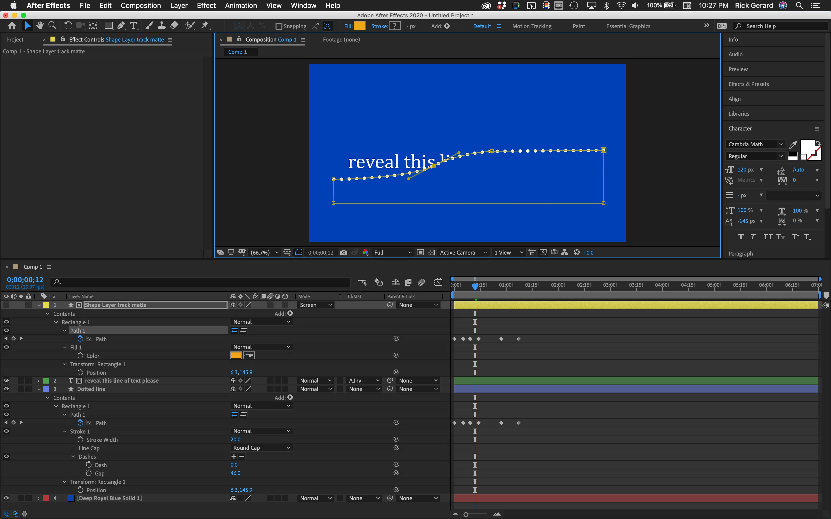

You can just keep your two text layers and animate a shape layer as shown in my screenshot. I used your movie as a guide. It just took a few keyframes.

If I understand you correctly you want to have the animated dotted line reveal the text layer. I'm assuming you created the dotted line with a shape layer and animated the path. If that is the case then I would duplicated the shape layer, put one copy above the text layer, the other below, select the top shape layer, press the 'u' key twice to reveal all modified properties, turn off the stroke, add any solid color fill, and fix the animation so that you have a filled rectangle.
You can then use the filled rectangle as an Inverted Alpha track matte for the text layer. The comp would look something like this:
You can see the path in the screenshot.
