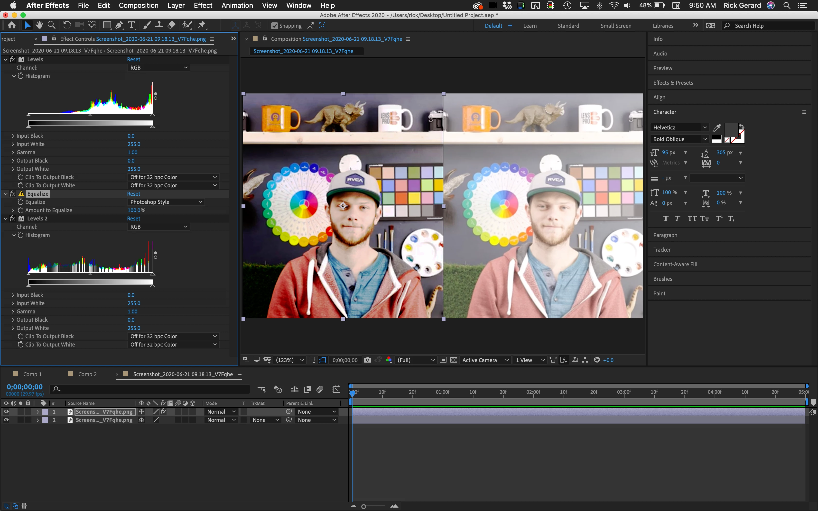

I took a screenshot of the presenters "overexposed" right side of the frame, added the 8bi screenshot to a new AE comp, duplicated the layer, and set the two layers beside one another. I added Levels first with no adjustments so I could get a good look at the pixels I have to work with, then applied the Equalize effect to the frame, then put a copy of Levels below to see how many holes I ended up with the initial fully automatic color correction. This is a 32-bit comp, but as you can clearly see, Equalize gave me a pretty good fix, and the Levels display shows a full range of color, but all of the holes in the histogram show the potential color values that have no information. The only way to fill in those color values is to have a higher bit depth image to start with.

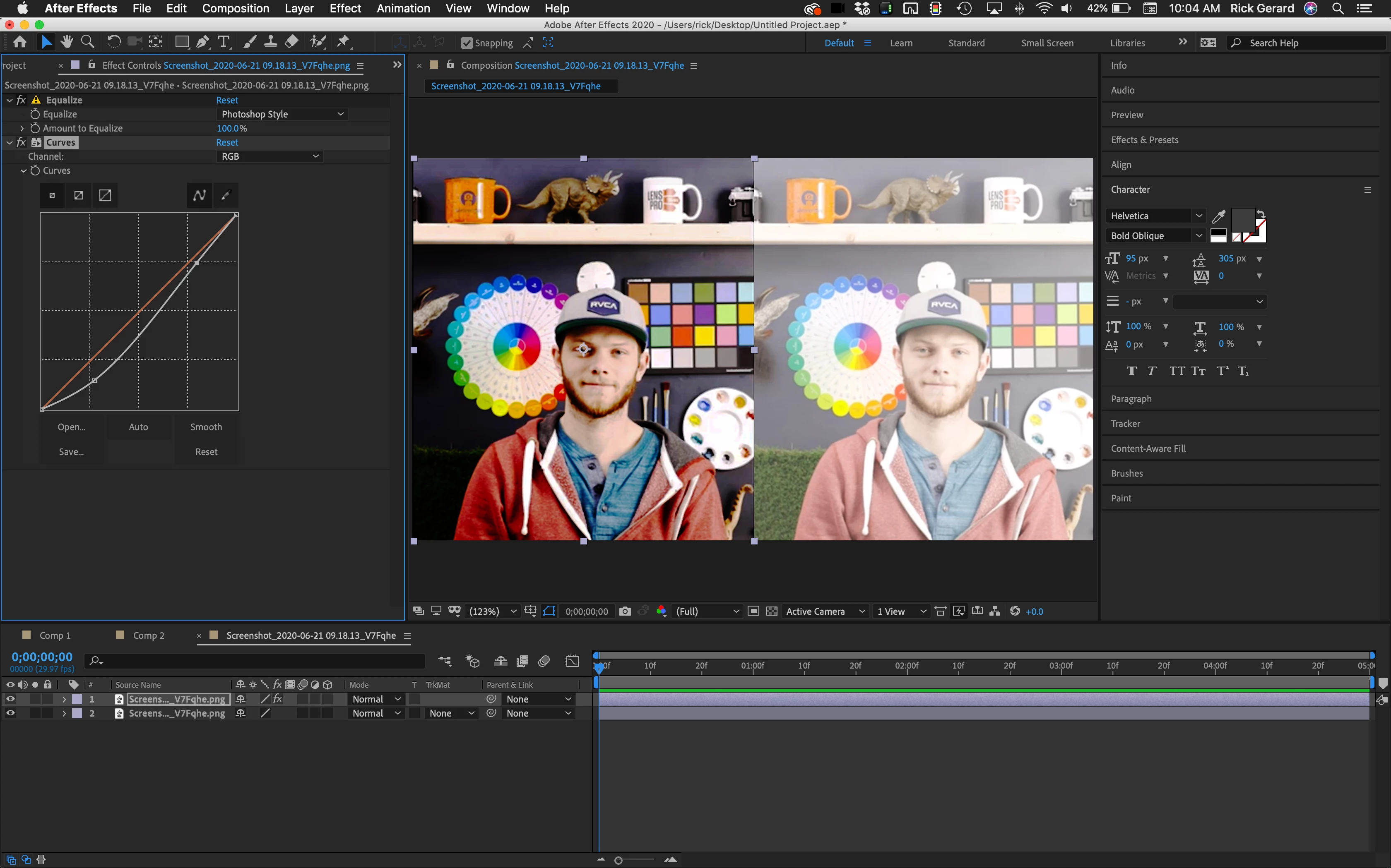

I almost matched the presenter's final color grade of the overexposed (??) footage by simply applying Equalize and then adding a couple points to Curves. Looks pretty good for about 20 seconds of work on an 8-bit image.

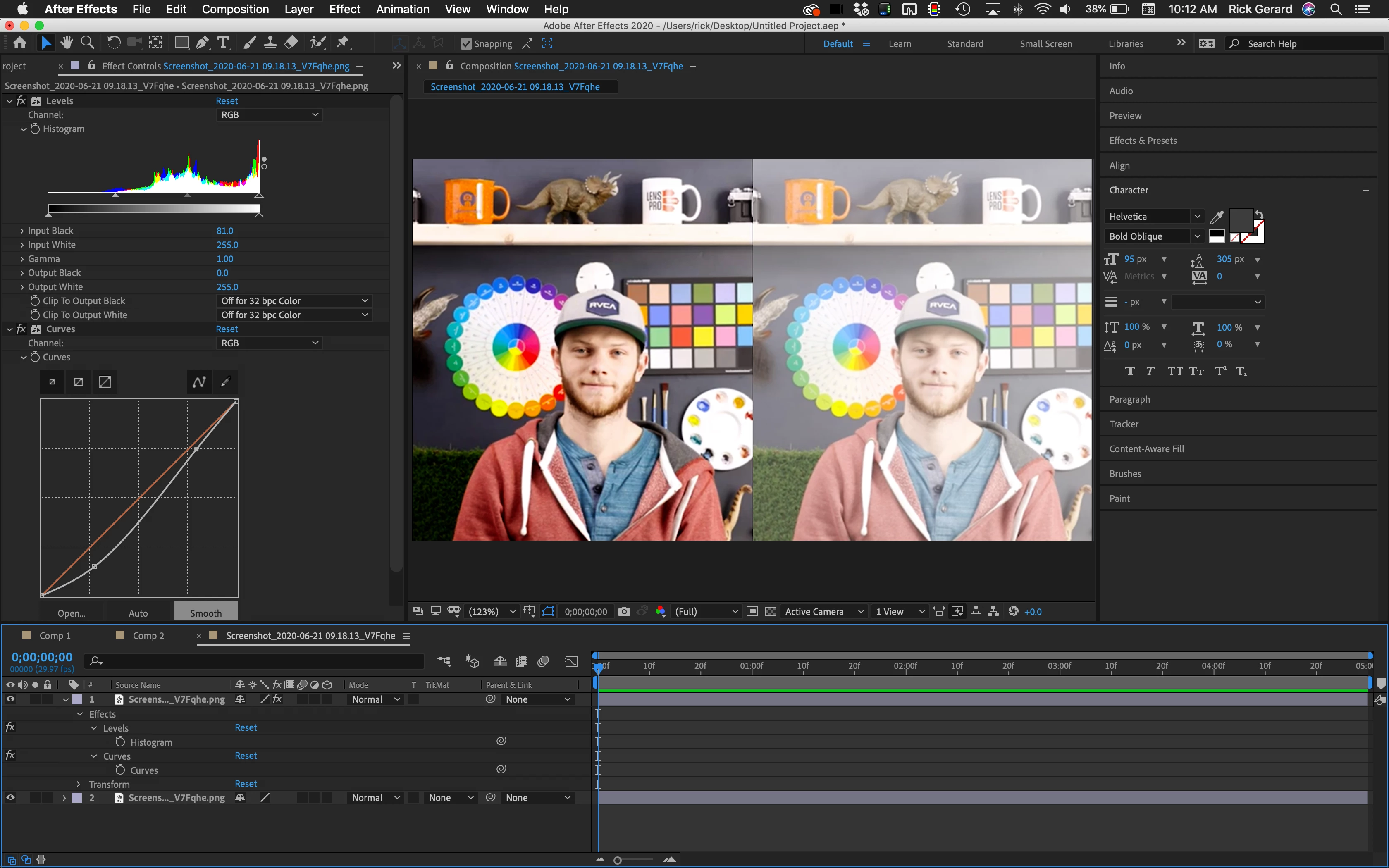

Here's another approach, another 10-second fix for the footage to get the Over Exposed footage looking properly exposed. Just two steps. Add Levels and adjust the input black level up until it just approaches the first dark pixels on the left. Second, add Curves and crush the blacks a bit and be careful with the whites. It looks pretty good with almost no work.
