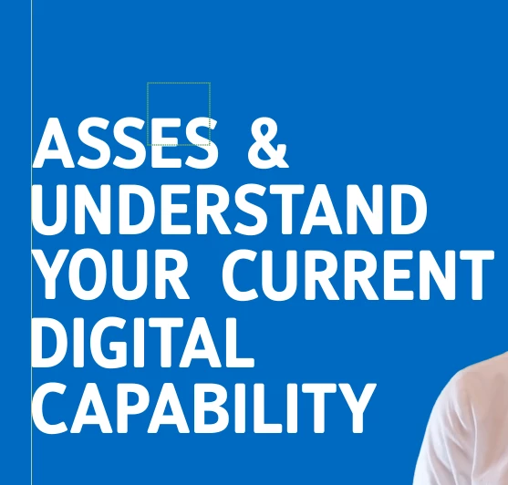

Right, so I'm trying to write a script that will auto align multiple different text layers, so one after the other. See below:
At some point, the layers will need to enter a new line. For example, 'Understand' has to be on a new line.
The way I'm setting this up, is by having the a slider with those if/else statements on it, to tell the current layer "the first word in this phrase is # layers below" So for 'Understand' it would be 2.
