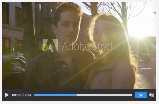

    Here is a tutorial from my friends at Video Copilot that shows you how to put an evil alien skin on a face. Depending on your shot you may be able to use similar techniques to remove the lens flair. If your shot is anything like this one from Adobe Stock:
    then it's going to take a lot more work to clean it up.
