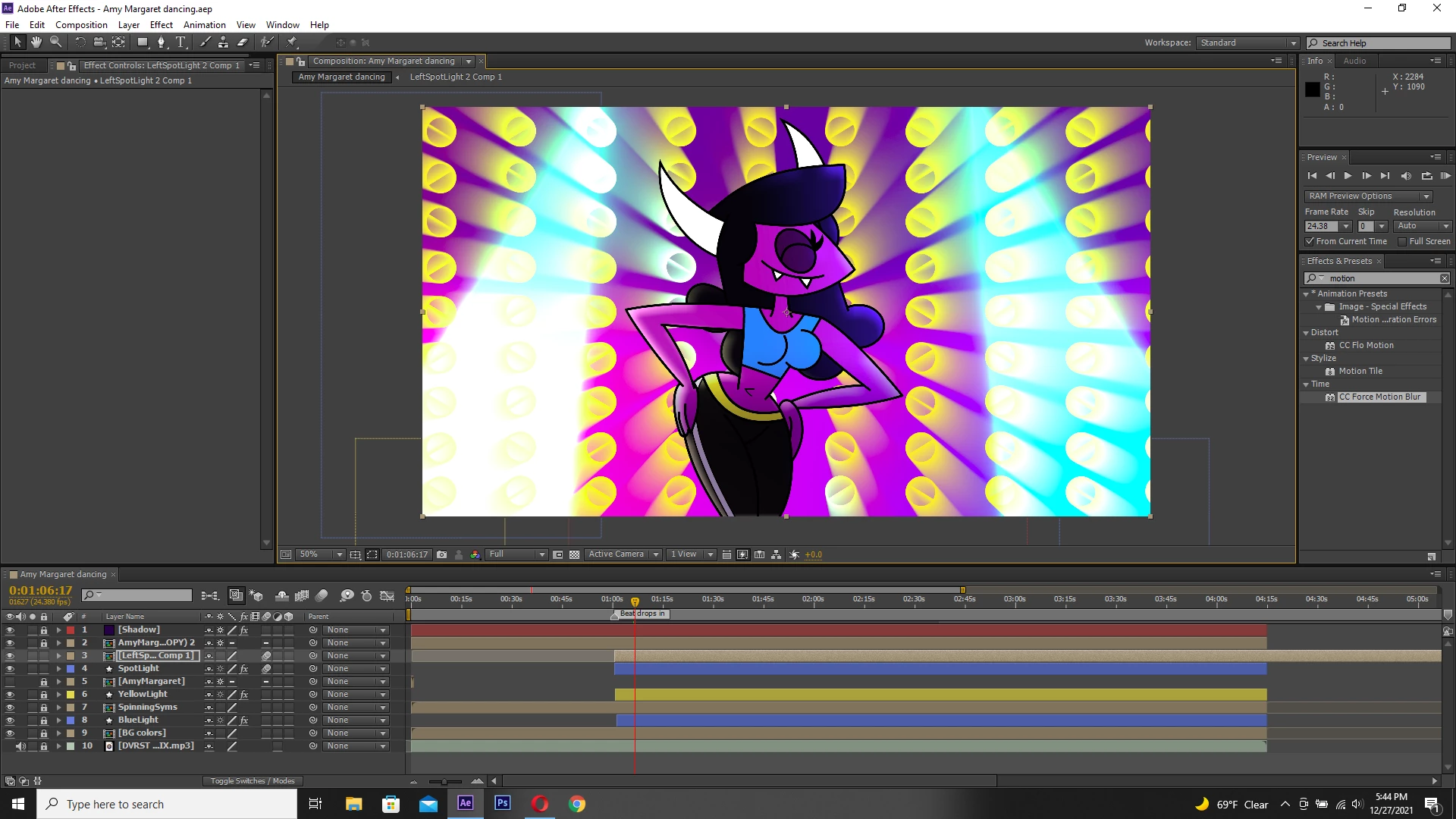

I have a video file of a PNG sequences that was originally exported and THEN brought back into After Effects CS6. I have the Project Setting and Color Manager set to 8 bit and CIE RGB. But when I export it, the colors are washed out and sometimes dark when exported again. And here's the file that I'm working on with the CIE RGB selected.

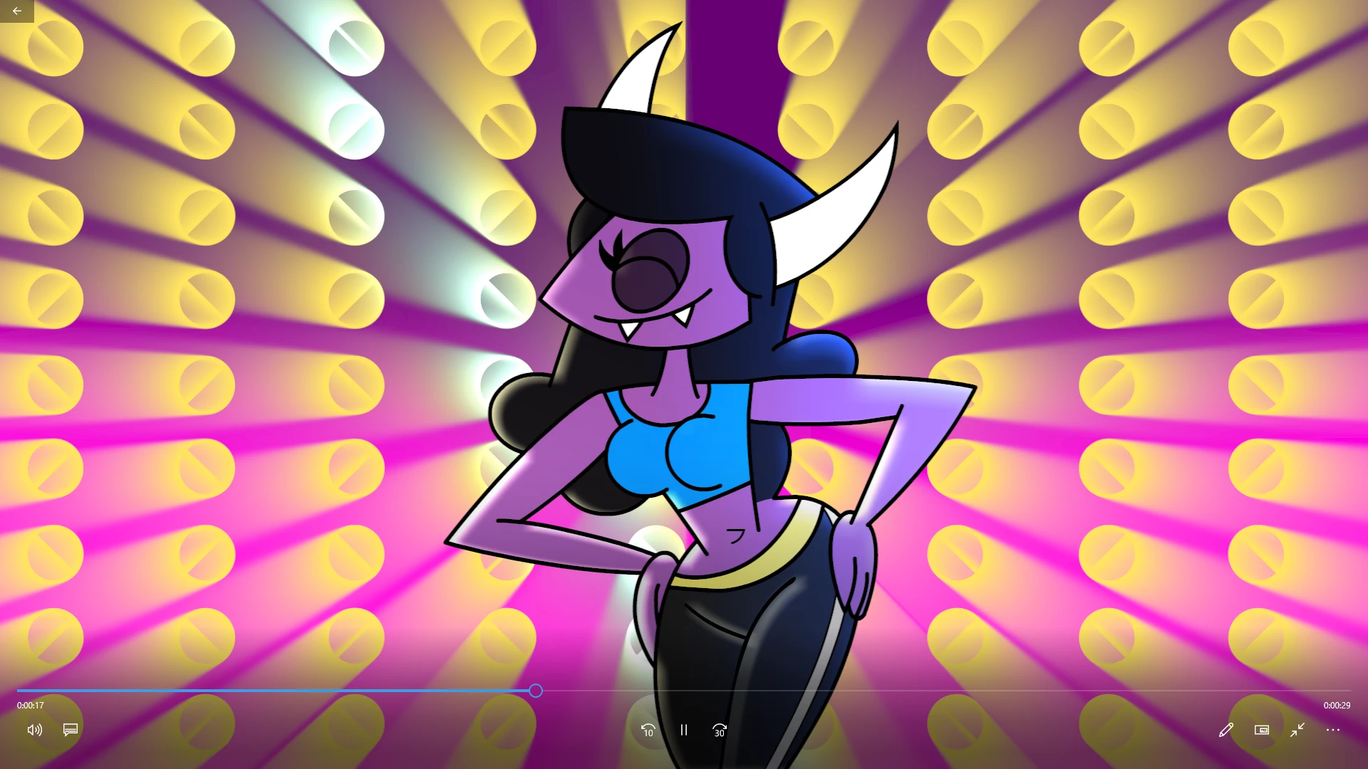

December 30, 2021
