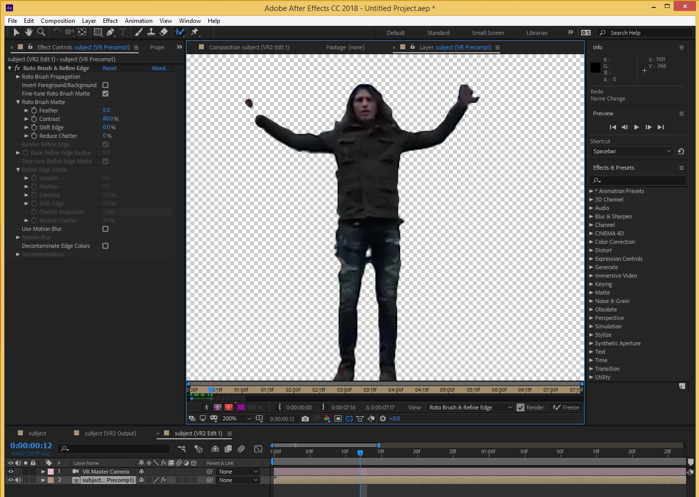

3. Select rotobrush tool, double-click on "subject...Precomp1" layer in VR Edit 1 comp that opens
4. Rotobrush some frames (quick and dirty for demo purposes)
5. Click Toggle Transparency Grid (see Fig. 2) - transparency works

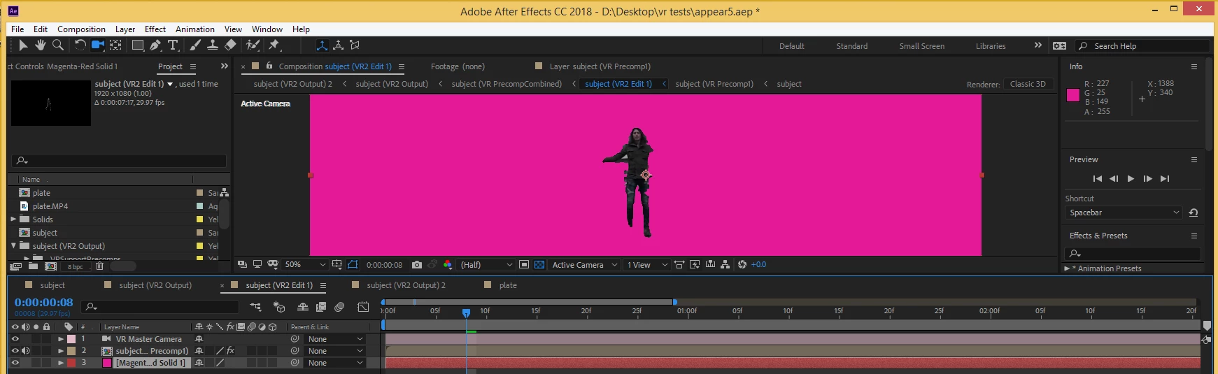

Here's the VR Edit with a solid put behind it:

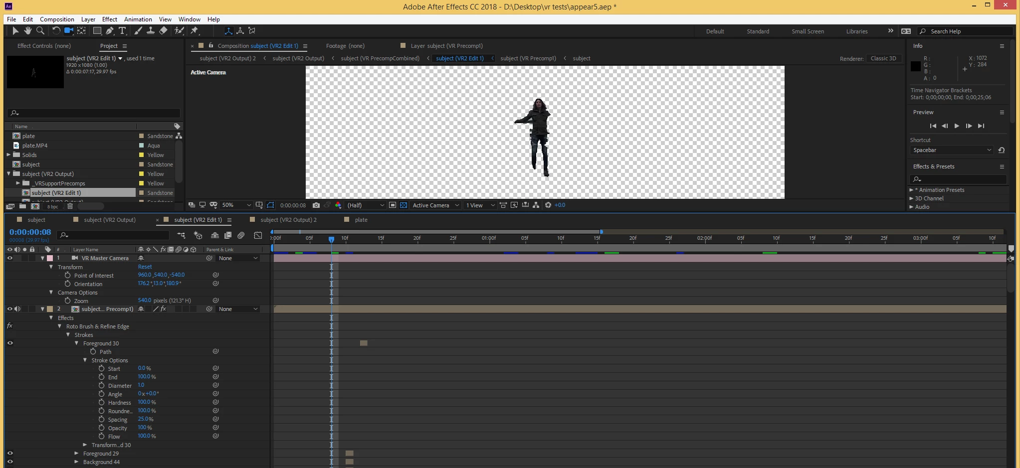

Here's the VR Edit rotobrush layer with checker:
Here's what it looks like without the solid...

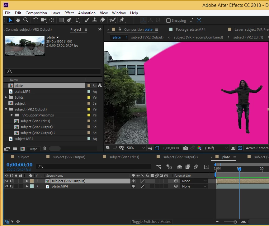

After your tip with the solid behind the rotoscoped VR Edit I noticed one funny thing. If I leave the solid in, it actually shows it on the background as expected, distorted to fit equirectangular view:
...but if I take the solid back out, the transparency is gone again.

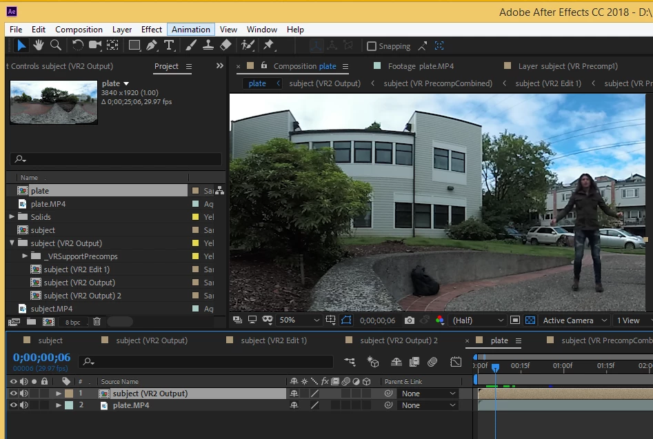

I'm confused. What is wrong with this screenshot:
It looks to me like you have placed your actor in the scene.
