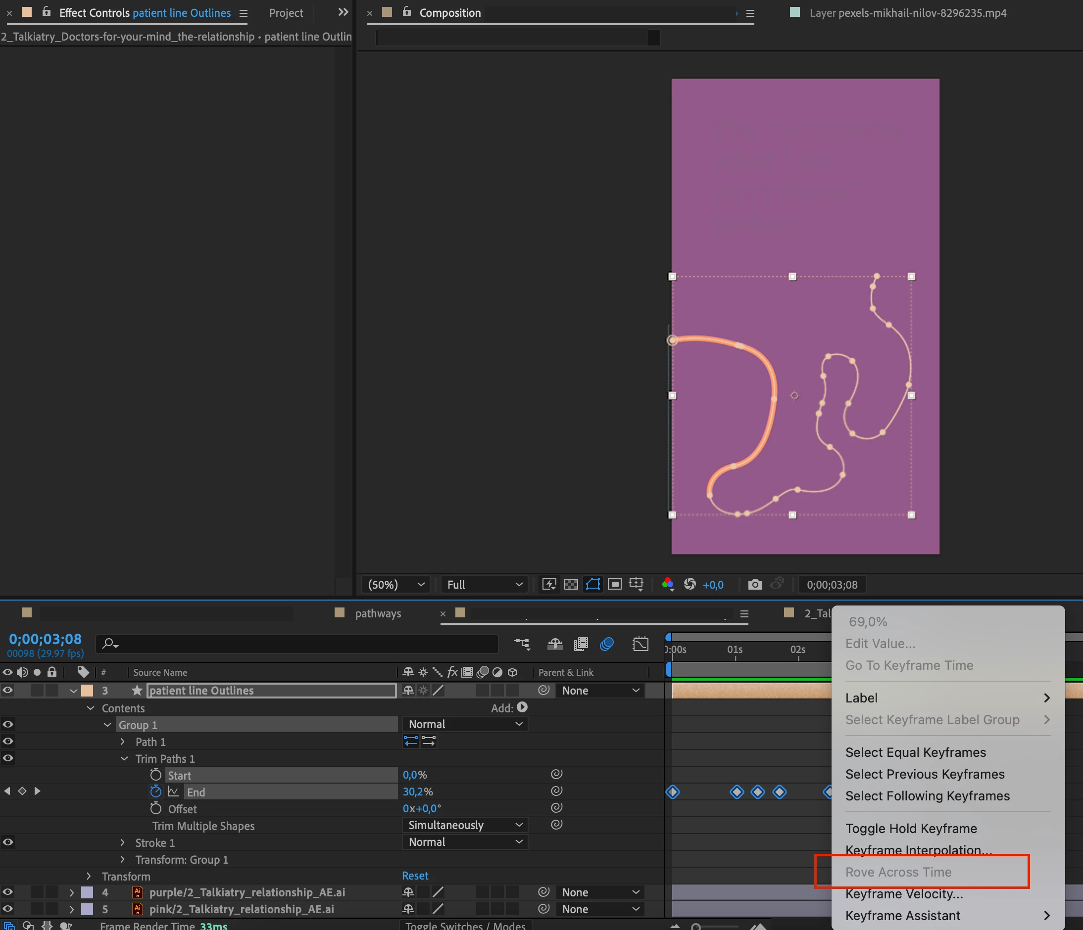

I'm trying to animate a complex line's end going back and forward. I need it to have a logical, constant speed, but the "rove accross time" function is greyed out...
Does anybody know how to do this?

Mylenium
November 2, 2022
My mistake. Rove only works for 2D and 3D properties as otherwise there's no way to calculate a speed vector. Refer to this:
https://helpx.adobe.com/after-effects/using/speed.html
That said, there's most definitely some script to even out keyframes and adjust the values, so check AEScripts.com.

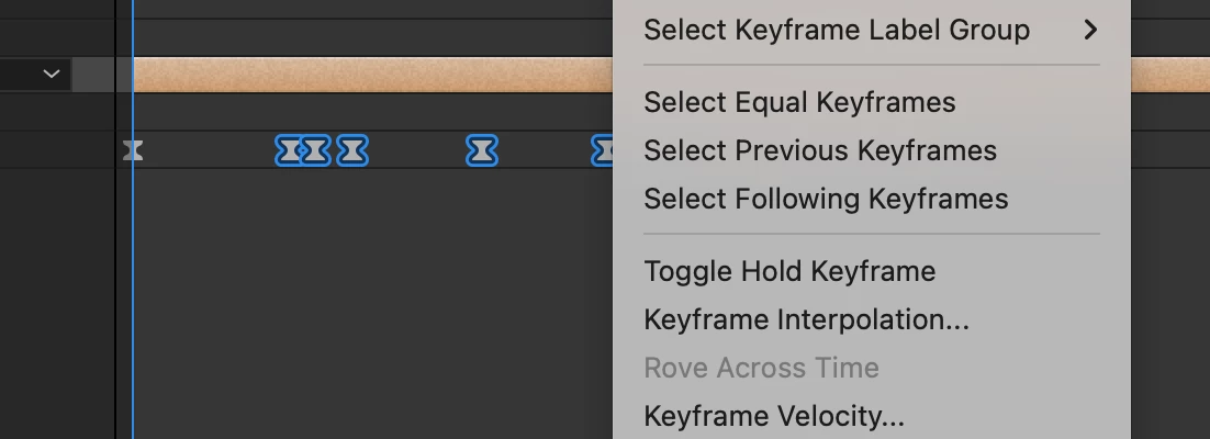

Mylenium
Mylenium
November 2, 2022
Select only the inner keyframes, not the start and end.
Mylenium
lume360Author
November 2, 2022
Still not working... 😞
