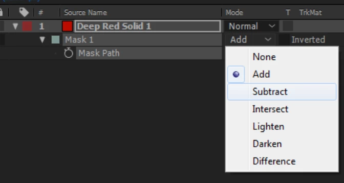

Somehow the image i put as a backround shows up only there where i cut the person...

there are a few ways to rotoscope so it will be helpful to show us what exactly are you doing with screenshots. the way you are describing your problem in the last response seems to be related to how your mask mode is set. when you use masks and set it to Add (the default) - it will show only the image. when set to subtract - it will show everything else but the cut area.
