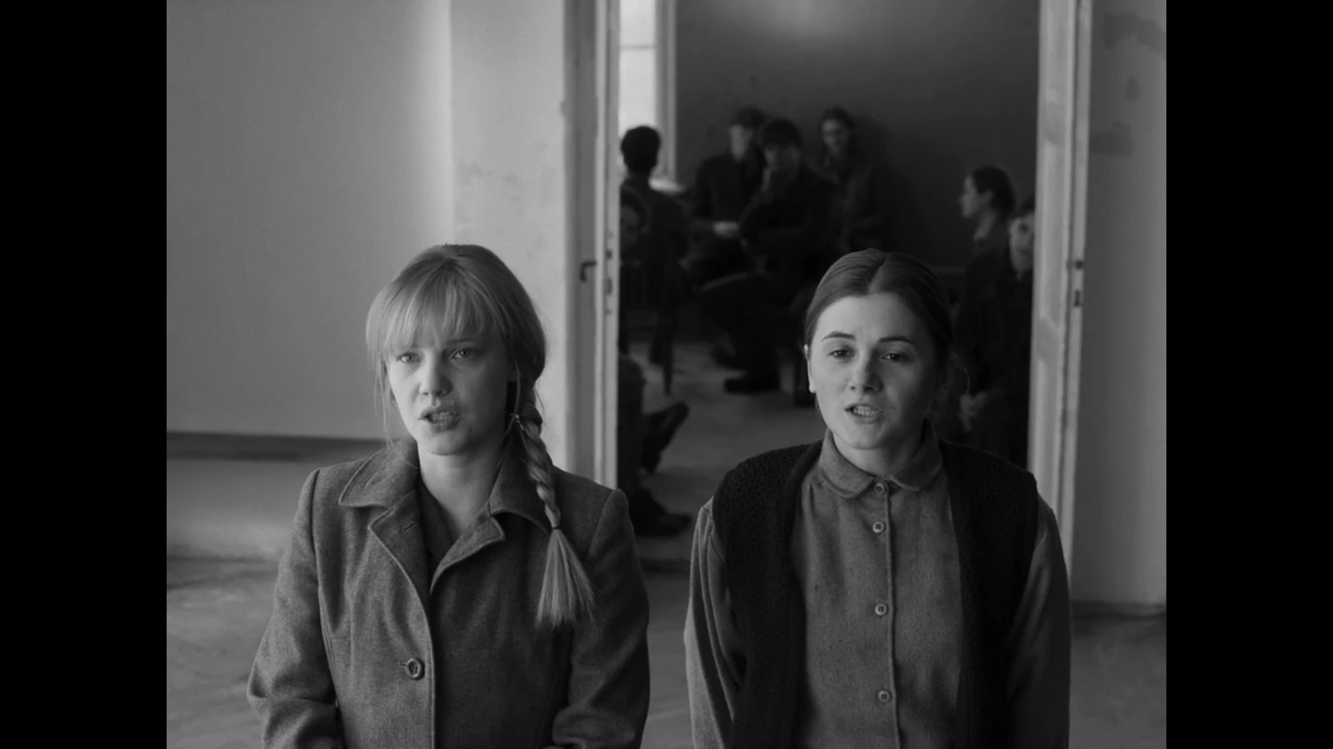

Okay, yeah. This is not my footage but I'm posting a black and white to simplify: I would like to keep the hard edges sharp, while softening low contrast areas (skin tones, fabrics, material surfaces etc.)
I see what you're getting at in the first reply, but I am not trying to soften a particular range of luminence. When I try that approach, it softens the edges where the edge is a white against a black, for example. That low-contrast area that I want to blur (let's say, the coat, the face) has an edge against the background that I don't want to blur. Maybe I was not clear on the approach.
I think I need an expression that selects pixels by proximate high contrast areas. I can sort of see Find Edges doing that, but I don't know how to translate that into a usable matte layer that I can keep sharp over top of a blurred layer.  With Find Edges with a "Multiply" blend on top and the blurred one on bottom I am sort of getting there, but there is no control over how it defines the edges.. so in color it's not quite usable.

Thank you for the suggestion. I'm struggling to get the right effect. I should say it's a normal photographic image, not a text block or something. I want to keep the edges sharp, while softening the bits inside the lines.
I'm seeking a way to select pixels by contrast with some threshold, so that I can build a matte and choose which to apply the blur to. Like, if difference between adjacent pixels in luminence is >X, then select both of them.
