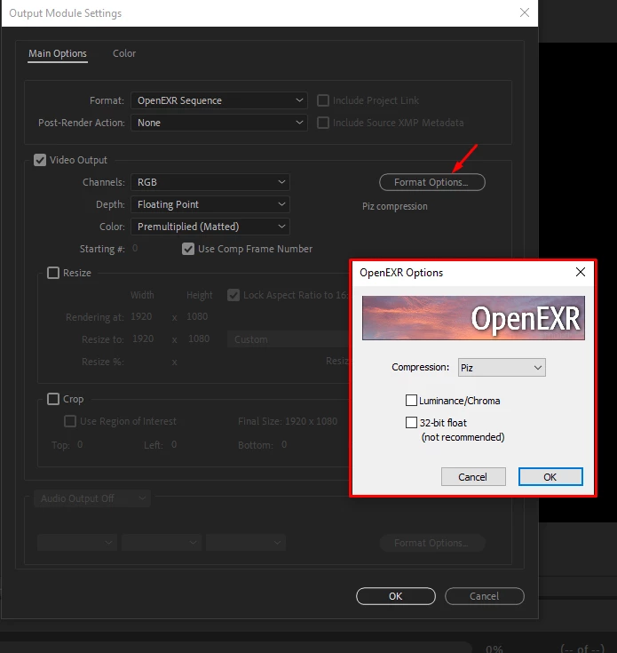

I would like to set the output module Format to OpenEXR Sequence with ExtendScript but I couldn't find how. With the OutputModule documentation I tried to do this:
const renderItem = app.project.renderQueue.items[1];
const outputModule = renderItem.outputModules[1];
outputModule.setSetting("Format", "OpenEXR Sequence");
// => After Effects error: Invalid Value for key: <Format>. Property is read-only
I also tried to apply the template but it doesn't seem to be registered as a proper output module template:
// Doesn't work
outputModule.applyTemplate("Custom: OpenEXR Sequence");
alert(outputModule.templates.join("\n"));

Moreover, is it possible to set the EXR compression options with code?
Thanks!
Mylenium
July 19, 2023
Query the properties with getSetting() first to check. That said I think that compression dialog is just not accessible as it doesn't respond to the standard CoDec hooks. Same quirk as with oder CoDecs' sub-settings that don't use the standard API interfaces.

Thanks @Mylenium for the answer!
Yes I did try getting the settings, this is what I have:

As you can see, the only parameter that is exposed is "Format" which is readonly...
The solution I found is to manually make an output module template with OpenEXR as the format, then saving this as an .aom file and loading that when creating a new file.
Thought it seems the output module settings are not tied to the After Effects file but rather the whole user preferences which is not really portable. And it seems I can't load it programatically...
