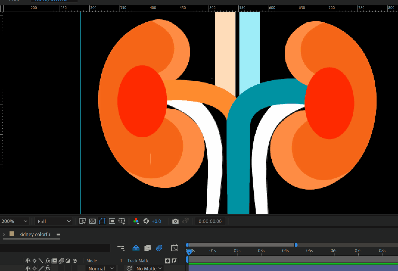

How to solve this weird thing- Displacement effect

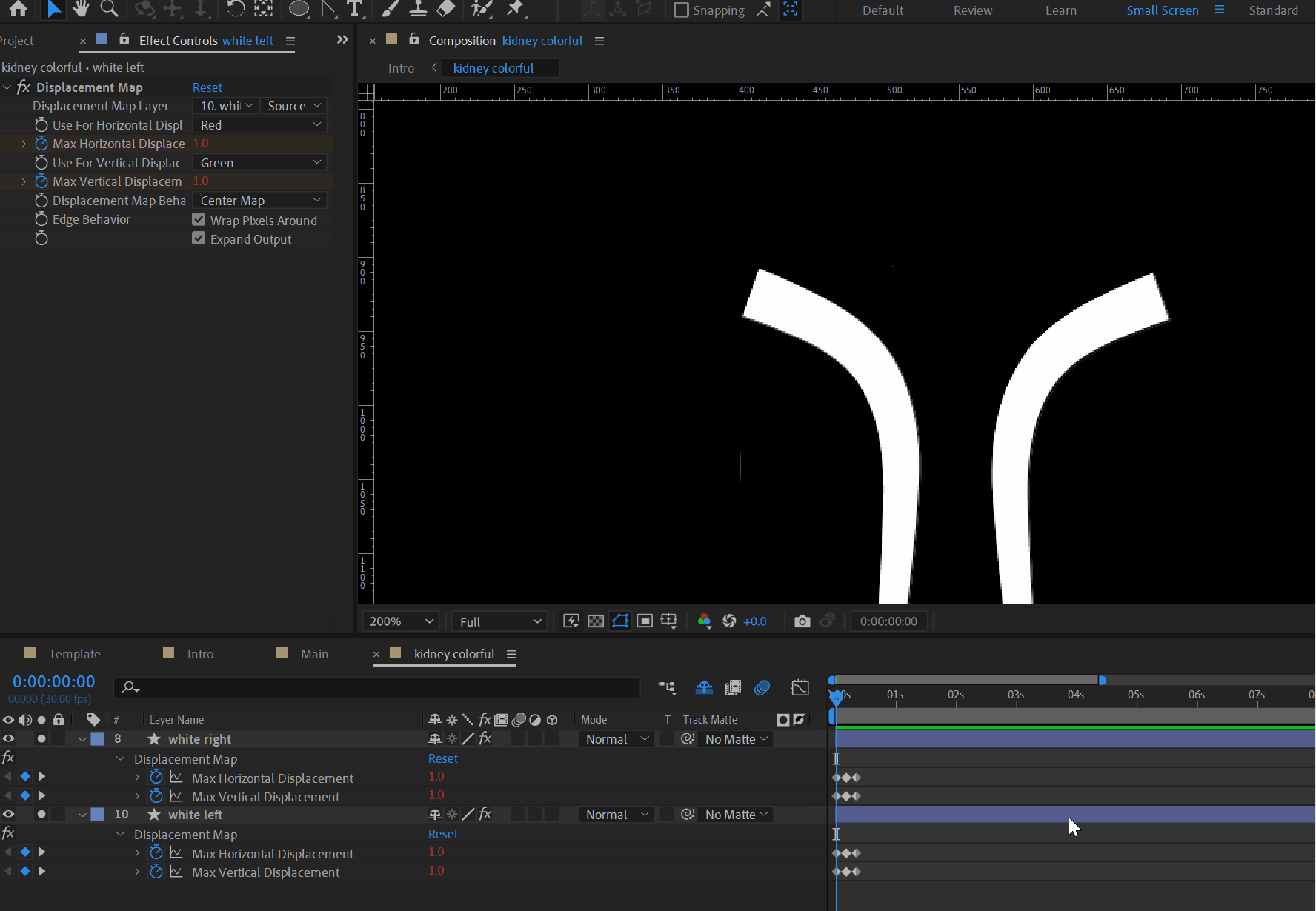

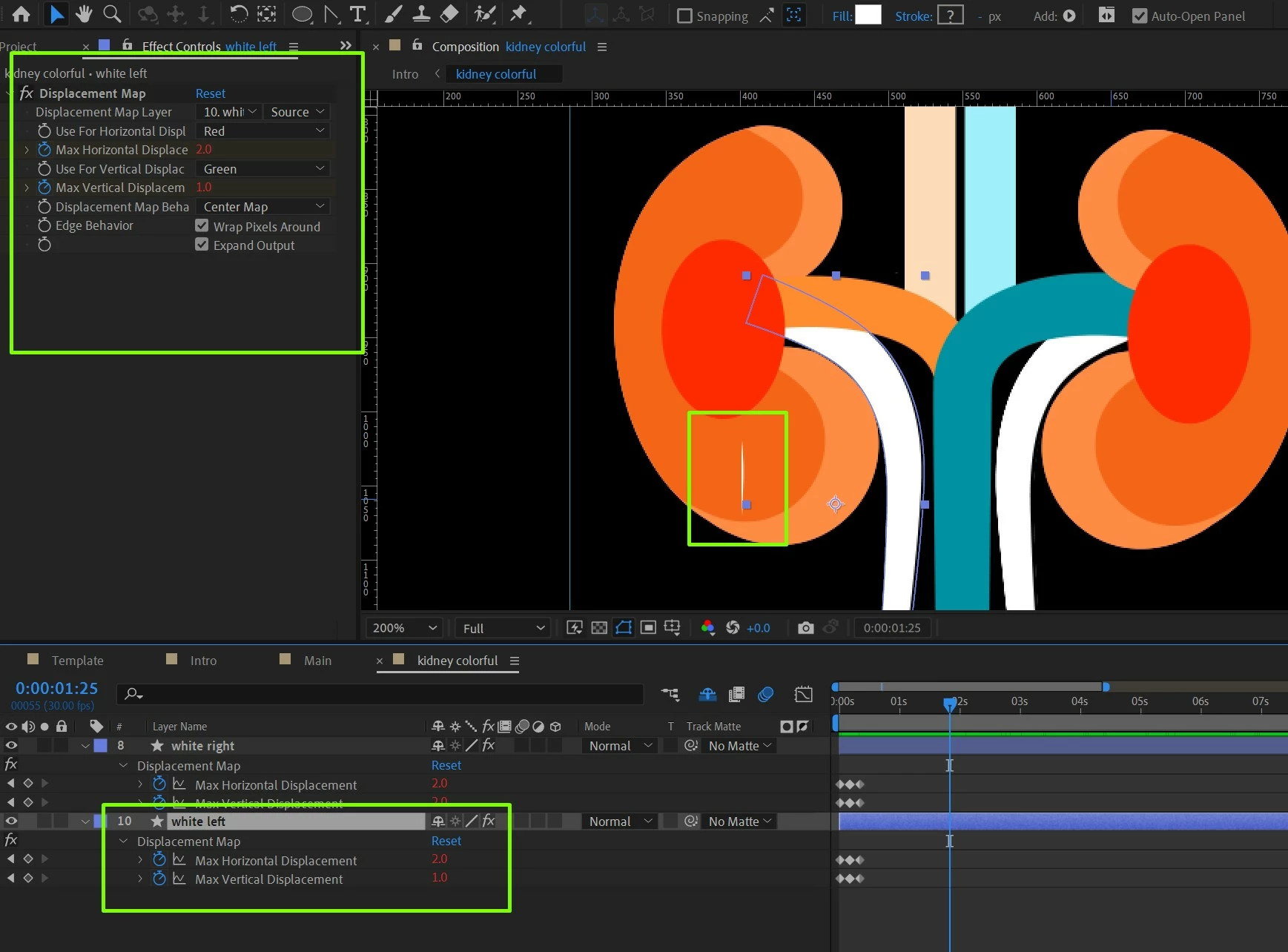

I need some guidance. I have applied displacement effect on two shape layers. one is totally okay, but another one is behaving odd. I need to solve this. Please someone help me. why am having this weird glitch thing and how can I solve it. Thank you.

On your displacement effect, you have Wrap Pixels Around checked.  So the edge of the stripe is appearing on the other side of the bounding box.  Unchecking this should solve the issue.
If it doesn't, try precomposing and mask out the area.

😮 😮 😮 YOU ARE SOOO RIGHT!!
It worked. Thank you so much!! 😮
