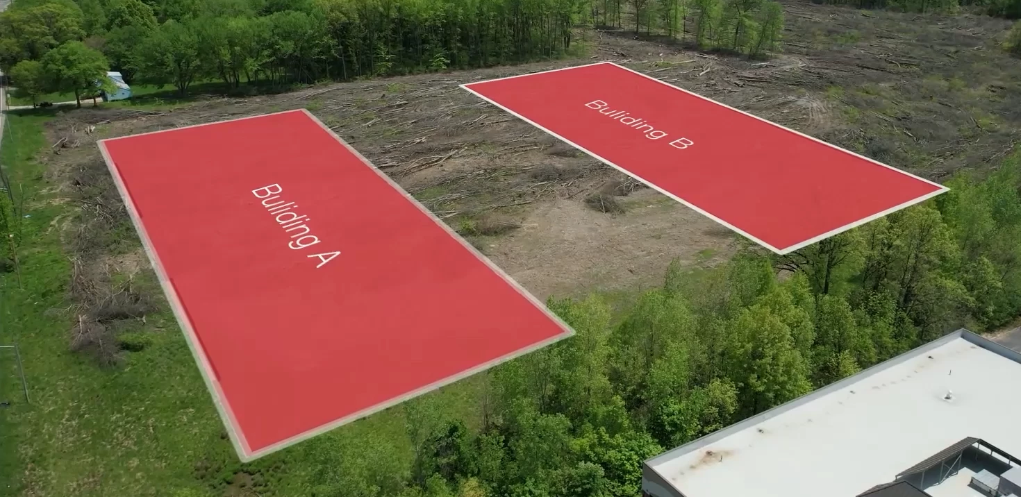

Thank you for all the useful tips.
If the 3D camera generated by AE will have a different angle of view, wouldn't that cause some funky movements of the placed plan during pan movement in the shot (some skew movement and distortion in perspective)?
I'm adding a footage example I'm working on and an image showing how the building should be placed.
Szalam
June 21, 2022
If you know the kind of lens on the drone, you can set it in the camera tracker to help things along, but your client may not care about things that much. A simple track may be all you need.
If you're concerned about distortion (and I don't blame you; drones have rather wide lenses), you can get as into the weeds as you want to with it. If I were doing this, I'd use Lens Distortion Matcher from Red Giant. You can use it to undistort the footage prior to the camera track (giving you a more accurate track) and then you can use it to easily redistort your new assets so they sit better in the shot. It's my secret weapon for this sort of thing.
