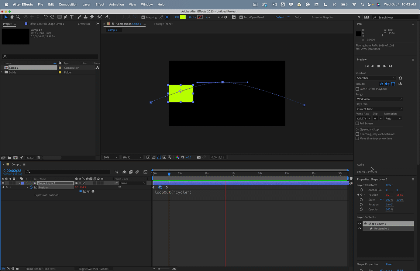

Oct 4, 2023 4:46 PM UTC
If you have keyframes that you want to cycle through, all you have to do is add
loopOut("cycle")
to the property. If the animation is simple, this is an easier solution than Time Remapping.
