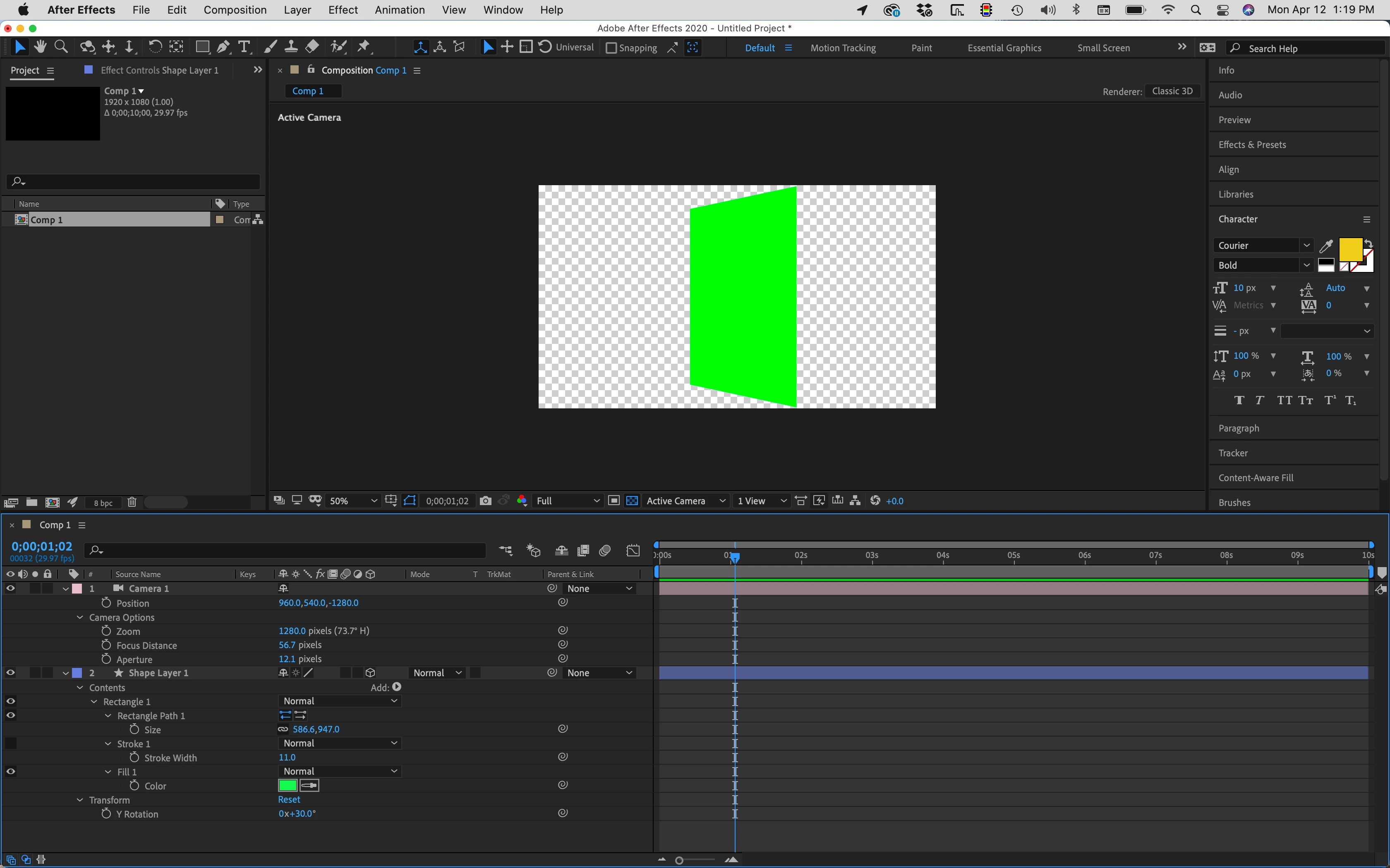

I am creating a rotating card in after effects bu whenever I rotate it the top and bottom of the card gets distorted you can see in the video please tell me a solution for this please

If you have not added a camera, and you have not used the camera tools in 2021, then the default Active Camera is about the equivalent of a 35mm to 50mm lens. If you want to minimize the distortion add a new camera with the zoom set to about 20,000.

That problem is really hard to diagnose because I don't know what your timeline looks like. I see a perspective shift that is consistent with a fairly wide lens. The anchor point may be displaced in Z. If you want to minimize the perspective shift as the layer rotates move the camera back and increase the zoom value to frame up the card. Perspective is controlled by the camera position, framing by focal length (zoom in AE). Take a look at these 3 screenshots. The layer is rotated 30º in Y in all 3 and it is the same size and at comp center. The first is a 28mm lens at the default position. The second the Z value is set to -5000 and the Zoom value has been increased to fill the frame. The perspective is a lot less. In the last screenshot, the Z position is -20,000 and the zoom is also about 20,000 and there is almost no perspective shift.
If changing the camera position doesn't fix your problem let us know. Please embed a screenshot that shows all modified properties of the layers giving you problems.
The only other possible problem is that you have your comp set to rectangular instead of square pixels. We can't know any more without a detailed workflow description and embedded screenshots like the ones that I posted that sho all modified properties of the layers.
