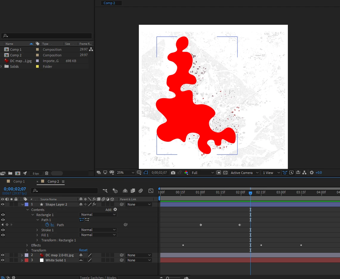

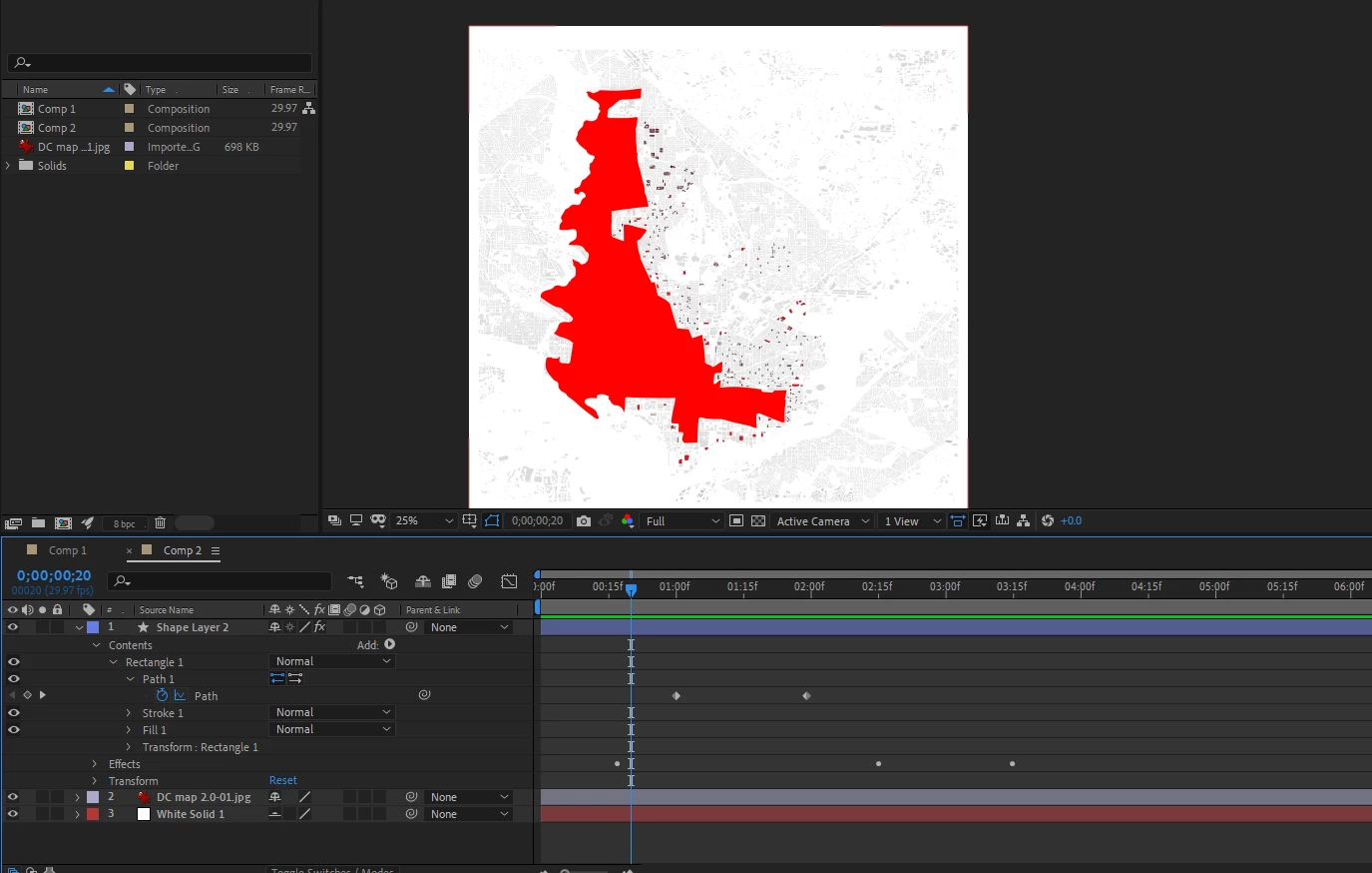

When I try to morph two somewhat complicated shapes from illustrator together, they do this weird flip while morphing. I am not sure how to fix this. Any help would be much appreciated!
I will leave the files here since the process would be quite difficult to explain otherwise.

When you create a path, you will always have a First vertex (marked as a big path point). When morphing, the place for the first vertex points of your multiples paths should be over the same area. Even it is possible that you need to create intermediate point on your masks to drive the animation smoothly.
September 7, 2020
I just checked and it seems like the first vertex points are in the same area. How should I go about creating intermediate points?
Jose Panadero
September 7, 2020
Between your main keyframes, add new keyframes with some new points to the path to drive your animation in a smooth way.
