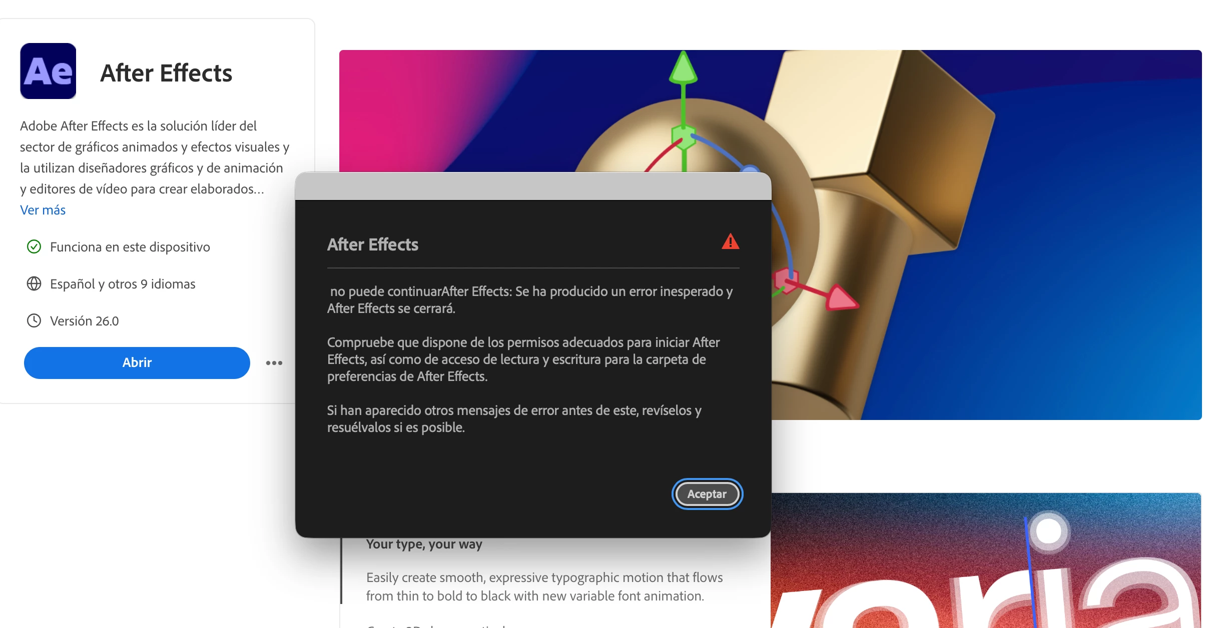

Hello, I'm having this problem. I'm a Mac user and from one day to the next I couldn't access After Effects anymore. I need help solving this problem, please. I've already deleted everything, uninstalled all Adobe software, and the problem persists.
