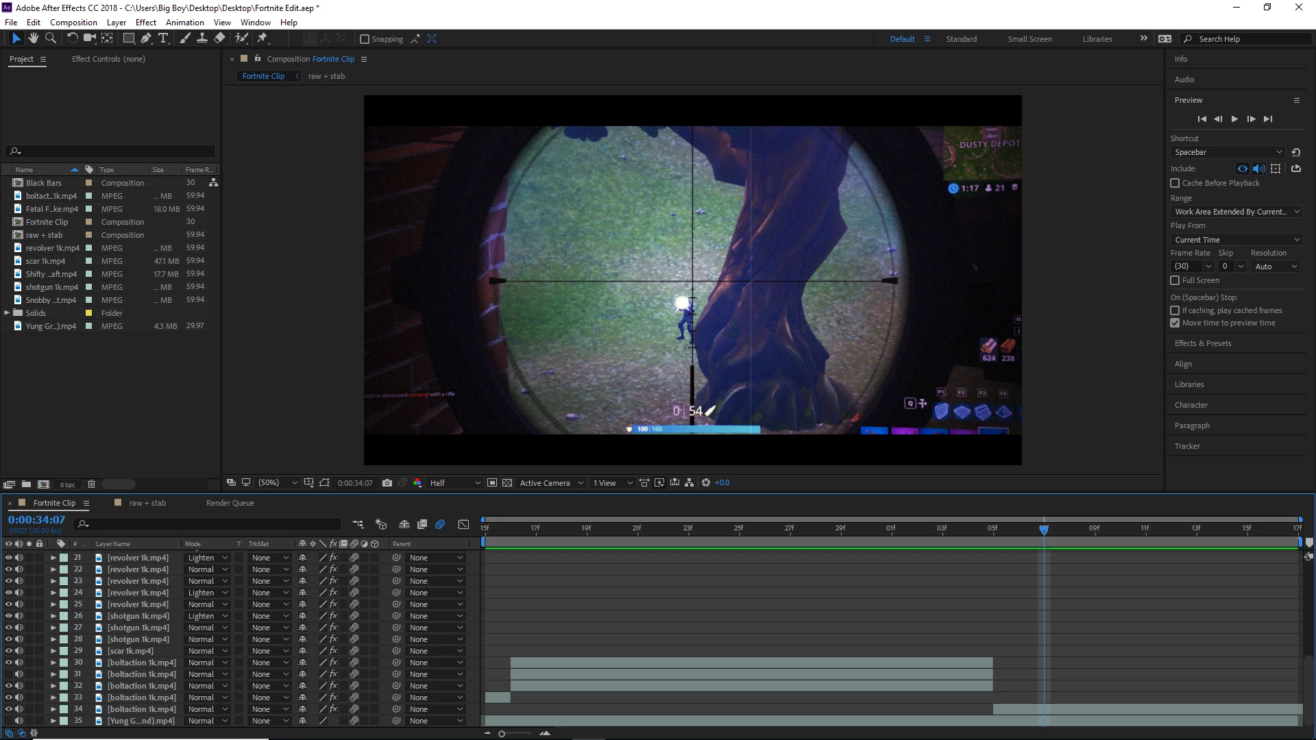

I clicked "Trim Comp to Work Area" assuming I could get back to see everything else I've completed.
  • April 19, 2018
  • 4892 views
I clicked "Trim Comp to Work Area" assuming I could just undo it after a while then add a new clip, etc. But when I tried looking for a way to undo it, there was none.
I have a screenshot of my problem and and I can't see past the "comp lines" or whatever they're called.
I have my comp fully zoomed out and I still can't see everything I have worked on up to this point.
This is really bad for me because I have a deadline (kind of) for this and I was nearly done for the night.
Correct answer Roland Kahlenberg
Trim Comp to Work Area is destructive. The only way back is via Undo. However, you will lose all work done from the time you invoked your less-than-favorite feature to invoking the Undo. If you have a saved, previous version then that may come in handy but it all depends on the work you did since invoking TCWA and how/if you can replace assets/properties to suit your needs.

Thank you for your help but sadly I closed after After Effects auto-saved while I was in that mode so now i'm probably going to have to redo it.
