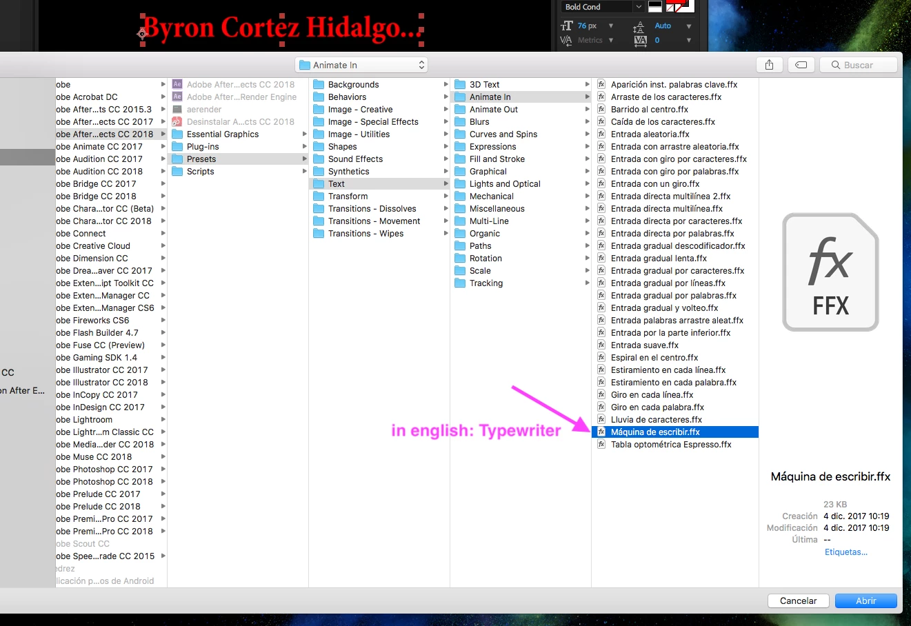

    Hi bash-lucid, try this:

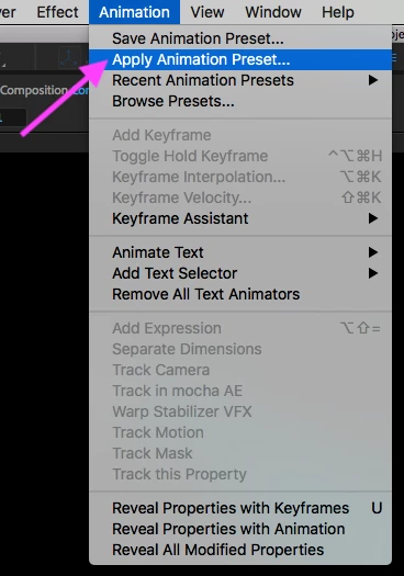

    Go to the Animation menu / Apply Animation Preset...
    Follow this folder path and choose this preset: Typewriter.ffx

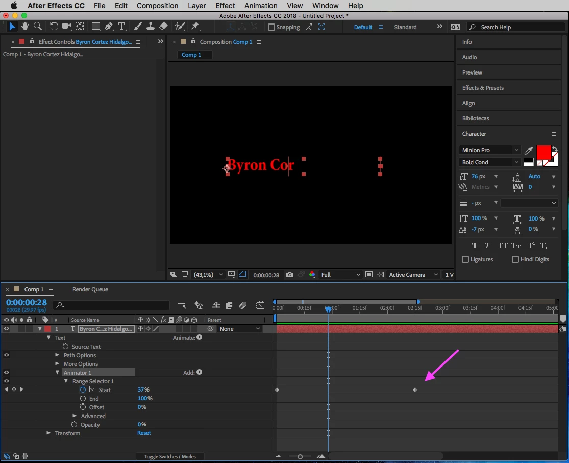

    Then go to the Animator 1, in Start you have to play with keyframes to set the timing that you want.
    And go on with others text layers with the same steps.
