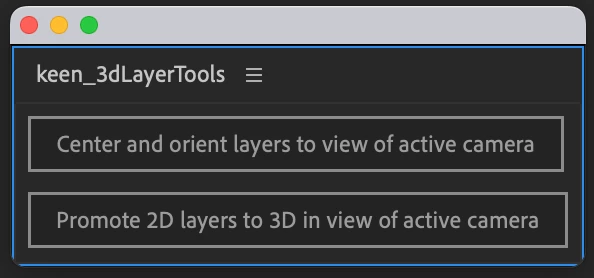

Ah. It seems like someone made a script that does what I need:
http://www.renderbreak.com/2014/07/after-effects-script-keen_3dlayertools/
Namely: "Promoting 2D layers to 3D in the active camera’s view, keeping the apparent 2D positioning."
I'll see if it actually works, since you're saying it's impossible, I'm not sure.
