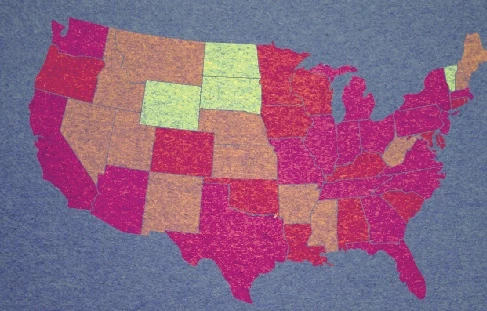

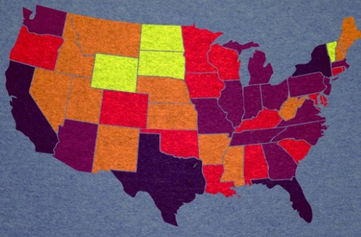

    warpigs666
    December 3, 2017
    Thanks guys. Here's some screenshots. They're wildly different.
    Illustrator:
    After Effects:
    Any idea what could be causing this? I've tried just importing the .ai file and changing the map layer's blend mode, and then also importing the .ai file without the background, importing the background separately, and then changing the map's blend mode and it still just looks like this.
    I have tried to figure out if this has something to do with color profiles but either it doesn't or I'm just not understanding how to make the right changes to get it to import correctly.
    Mike_Abbott
    Mike_AbbottCorrect answer
    December 4, 2017
    Check that your Illustrator document isn't in CMYK colour mode.
    File > Document Color Mode
