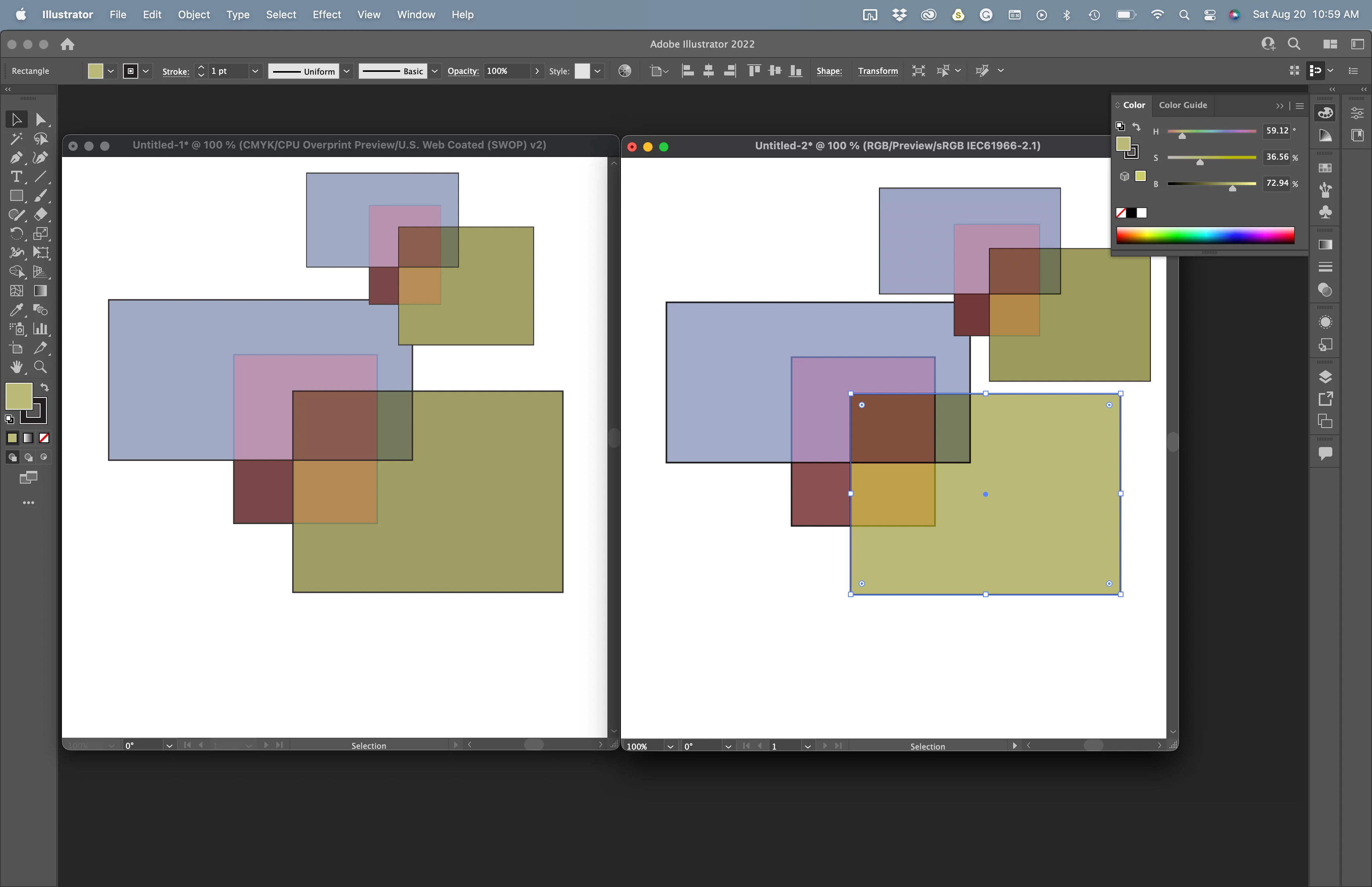

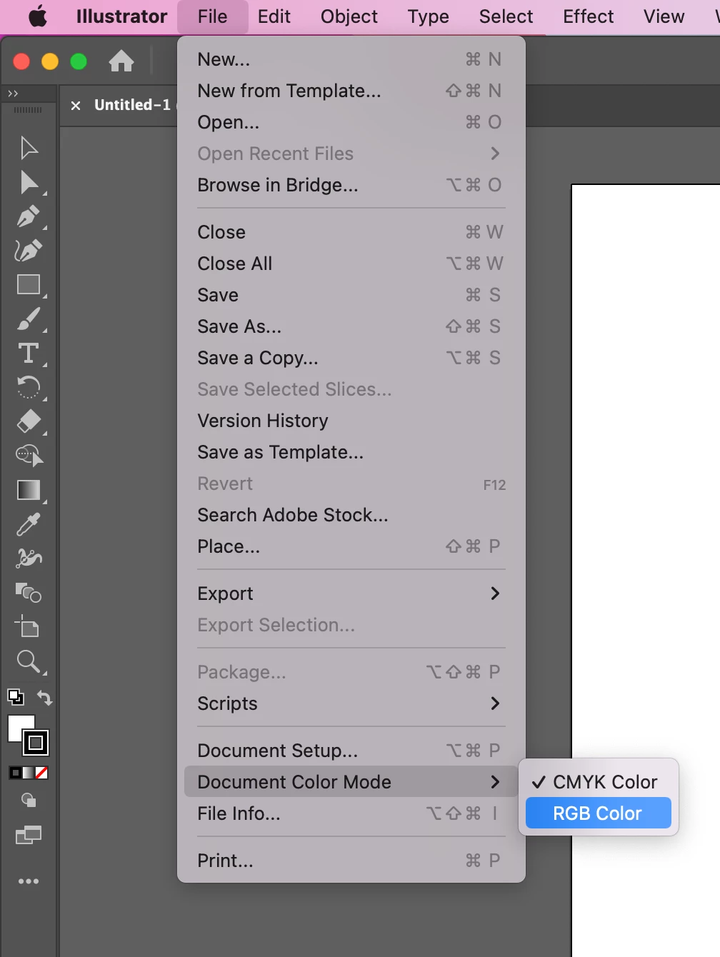

If the document changes its appearance in Illustrator when you select File/Document Color Mode/RGB, then you will have to do what you have to do in Illustrator to make it work.

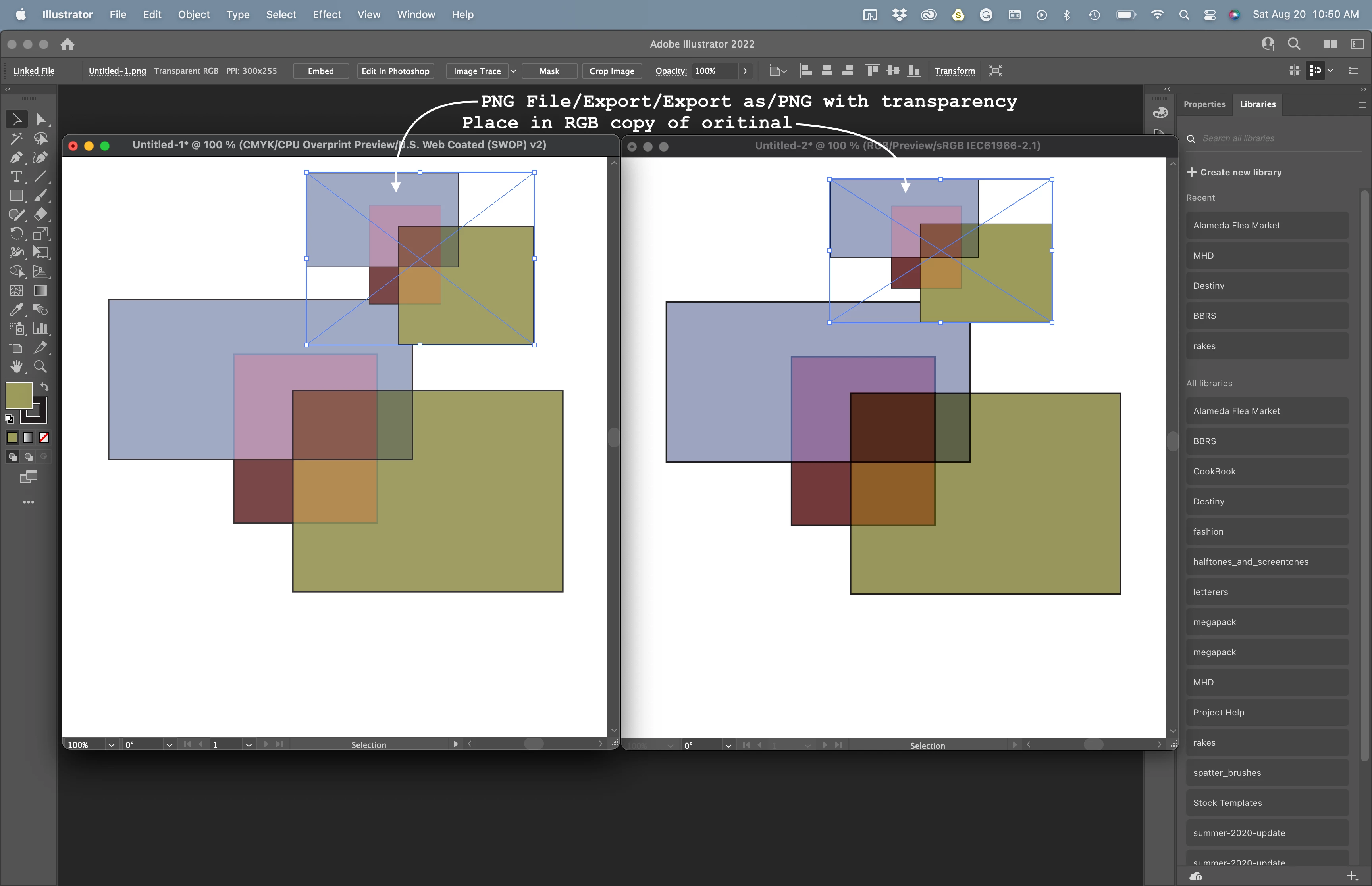

I took your description, normal below multiply, overlay above multiply, exported a PNG from the CMYK document, then copied the shapes to an RGB document and placed the PNG in both. The RGB PNG accurately represents the CMYK document, even when placed in the RGB document.
Using the placed PNG file as a guide and adjusting only the Saturation and Brightness HSB sliders for the three layers gave me a more accurate conversion. Color management also plays a part.
It would be nice if converting an AI file to RGB didn't foul up blending modes. It looks like it is possible because the RGB PNG (png does not support CMYK) conversion appears to be perfect. It isn't, and I don't know any way of making it perfect. If you can use PNG files, bu upsizing the AI file or the PPI when you export so scaling isn't a problem, converting AI layers to PNG files may be the easiest solution.

Try saving a duplicate Illustrator file and then change the duplicate Document Color Mode to RGB.
With both the CMYK original and the RGB duplicate open in Illustrator, use Window > Arrange > Tile to view the two documents side by side.  If the RGB duplicate needs any color adjustments, then make them, save, and then import that into After Effects.

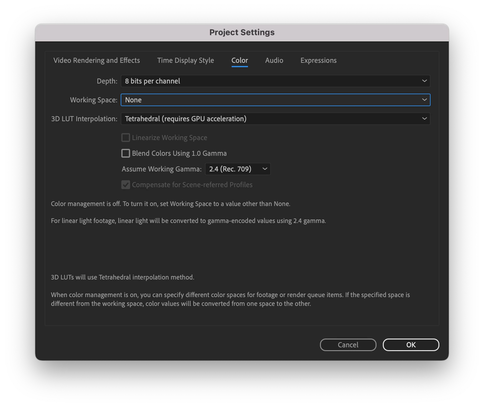

On the After Effects side, what is the Working Space for color set to in the Project Settigns?

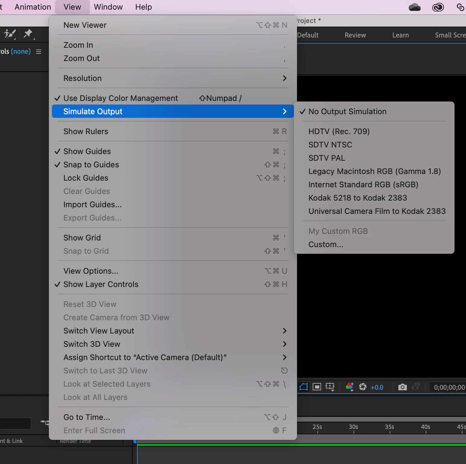

If you're using a Working Space, what are the Display Color Management options set to under the View pulldown menu?
