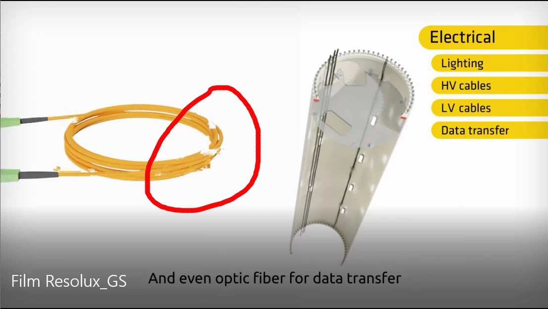

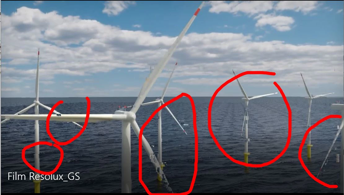

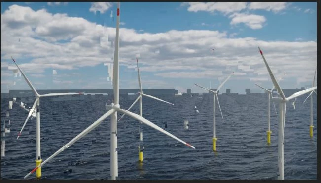

I have been terribly dismissed by the image quality of imported mp4 in my AE project.
Some images (not all) are damaged with "displaced" pixels. (see attached screenshots).
This happens when exporting in mp4, via MediaEncoder and also in .mov via the "rendering queue" of AE itself.  I also noticed that the image is also sometimes damaged on the viewport of AE.

MP4 is a lossy interframe compressed format that should never be intentionally used as a production format. In almost every case, there is at best one actual frame for every three predicted frames, and that's where the errors occur. A second pass at rendering will also seriously degrade the footage.
You should be creating your digital masters by rendering to a frame-based, lossless, and for any serious work, at least a 10-bit production format to avoid these problems.
Sometimes transcoding your original MP4 render to a production format will fix a few of the decoding issues causing your pixel shifting.

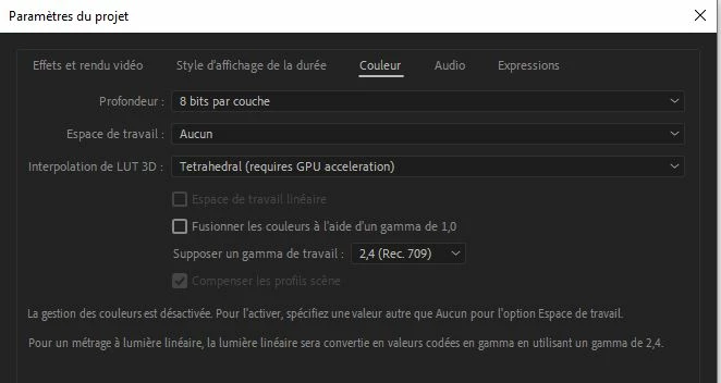

I found a setting about "bits per color" in the "Project settings" in AE (see screnshot below) Is it the place where I can set the "10 bits production format"?
