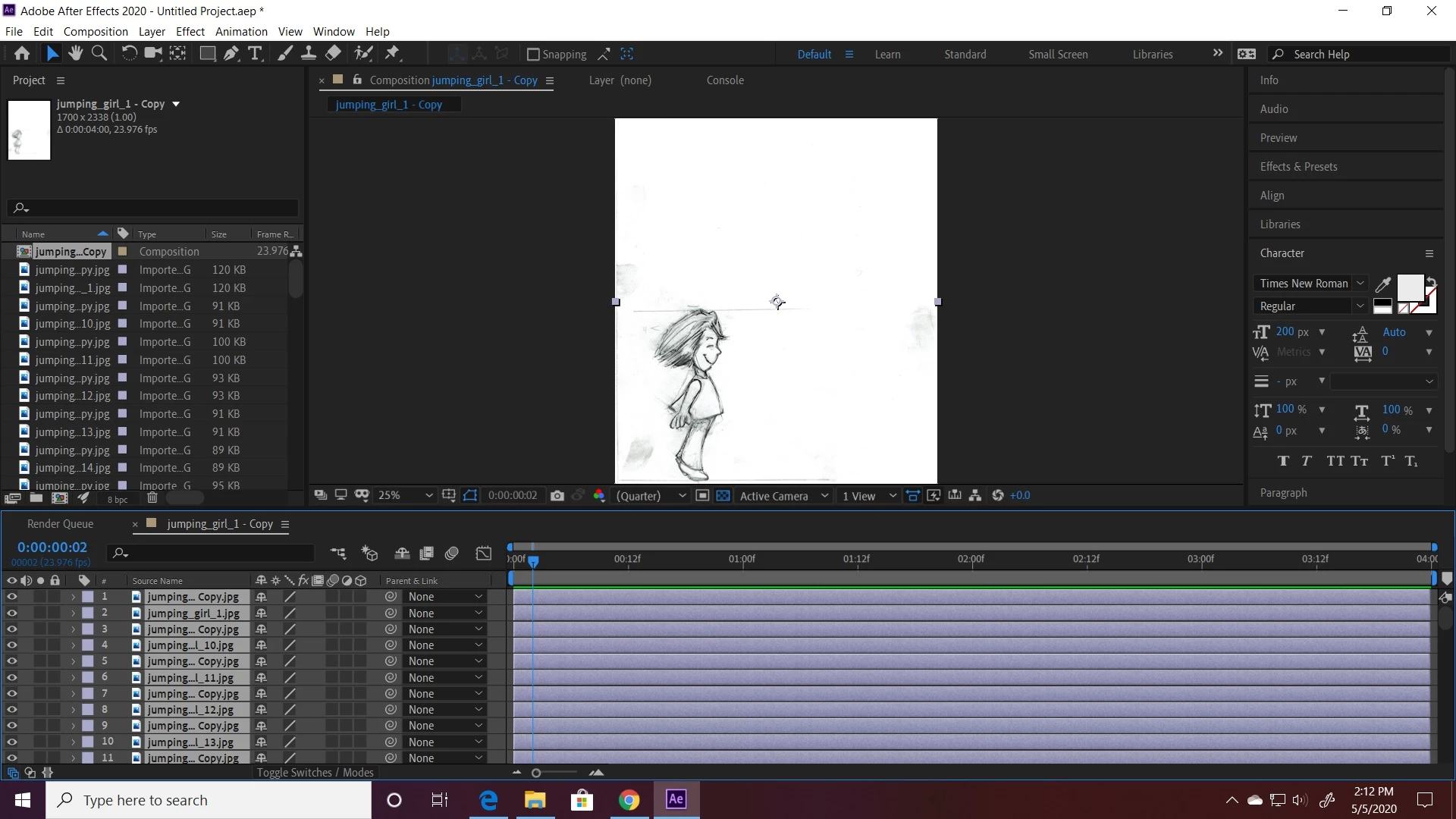

Thank you Kyle for getting back to me.  Alas, your advice did not work, although I can tell i am closer.  Attached are the screenshots for what i got.
    When I placed the time indicator on 1 sec (2 frames, yes?) and then trimmed, you will see that it wouldn't trim there. (2 different attempts with different results)
  I took the keyframe assistant/sequence layer step to see if i would get the stair step look that I should be getting at least, but in the final scrnsht, you can see that i did not.
    Again, I appreciate the help.  Looking forward to hearing back!

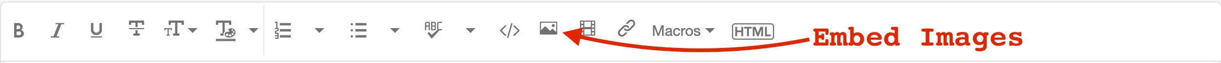

You should always be able to embed images if you use the toolbar:
