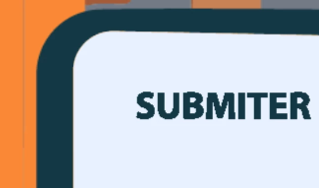

Imported layers from illustrator have broken edges
Imported layers from illustrator have broken edges. I have outlined texts and I have the continuosly rasterize option activated, and nothing seems to help.
What can be causing this issue? The rest of the imported ai files work fine, it's only this ai document.
nishu_kush
nishu_kushCorrect answer
Oct 16, 2025 2:47 PM UTC
Thanks for sharing the screenshot. Try changing the Quality and Sampling from Draft to Bilinear or Bicubic. Check out the screenshot of reference.
Let me know how it goes.
Nishu

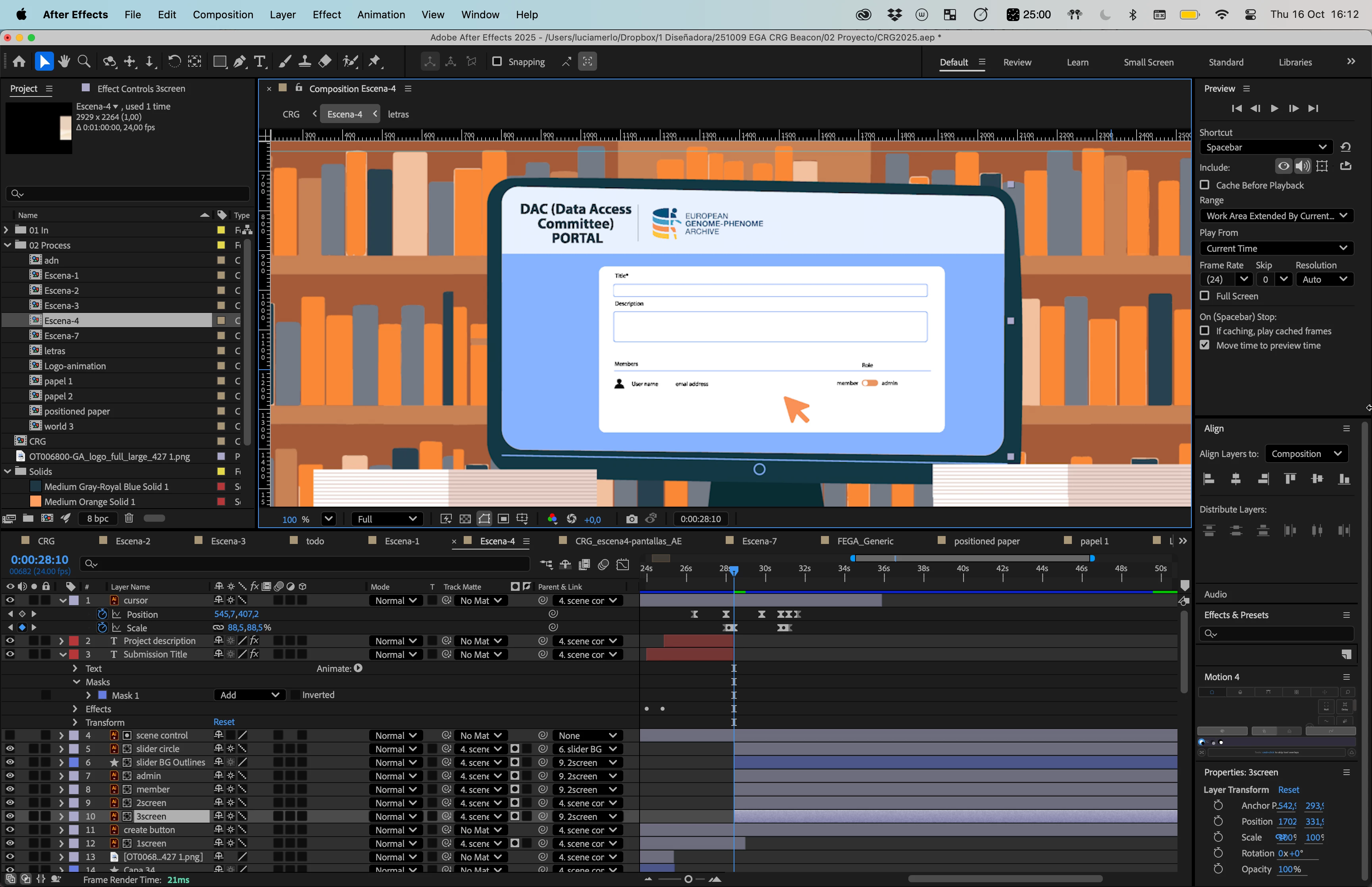

lume360Author
Oct 16, 2025 2:13 PM UTC
I'm zooming in to compare layers that render differently.Here is the full UI.
nishu_kush
Nishu
