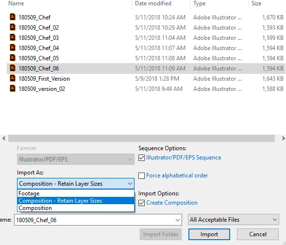

These are my options when I import it.
This is my screen when I drag the composition in. Every single layer is the same; anchor point in the middle of the composition, layer the size of the composition. When importing this particular scene i chose the option: "Composition - retain later sizes"

For people that have the same problem;
I accidentally stumbled upon my solution: Uncheck the box: "Illustrator/PDF/EPS Sequence". Apparently I clicked on it without realizing.

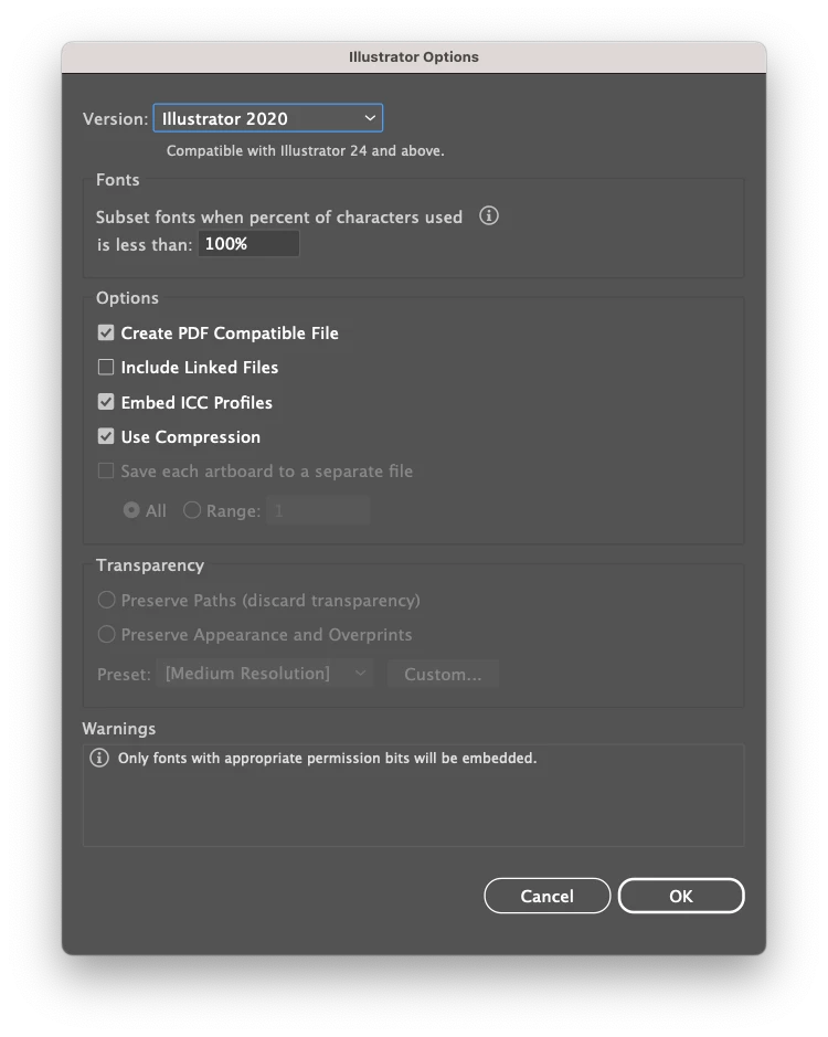

Feb 13, 2024 1:14 PM UTC
Another related scenario where importing as 'Composition' or 'Composition - Retain Layer Sizes' also doesn't seem to work (i.e. it just imports as one layer) is where your illustrator file has been saved without 'Create PDF Compatible File' ticked in the save options. To solve re-save a copy with this option ticked and all the layers should come in seperated.
