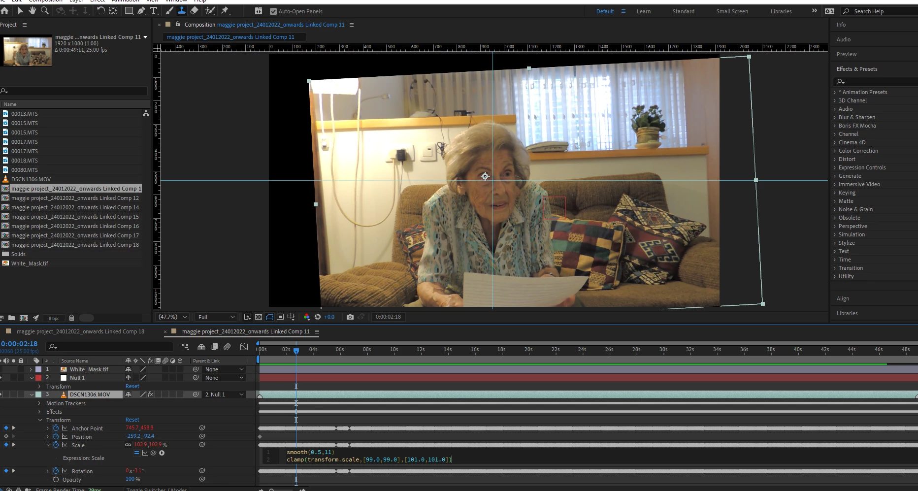

dear community,
For a project i am trying to stabilize faces from various videos. I analyzed the faces with detailed face tracking, then used stabilizator. I attached the keyframes from face tracking to the stabilizator's track points.
i prefer a stabilization including scaling, because my subjects are changing their distance to the camera from time to time, but there are many points that the tracking does not work fluently, and extraordinary zoom ins and zoom outs occur. Is there a way, to control it with a function, saying that it limits to max scaling to 110 percent and min scaling to 90 percent? I tried the smooth function, but even that had a limit
thanks a lot and best regards,
ik

You can do it using the clamp expression or even a conditional expression. There are some videos on youtube regarding the use of both expression. Take a look.
iklimdAuthor
February 9, 2022
thank you jose. the clam expression worked! is it possible touse two expressions at once? i would like to use both clamp and smoooth at once
