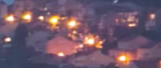

What the shot is is a timelapse shot with water and boats and a close land and buildings in the foreground and mountain/hill-type areas of land on the far sides of the water. It's the areas past the water, in the distance that I'm using these masks on. So the timelapse video was originally a shorter video (and has been lengthed a lot) and it had started in the evenining/sunset when there were lots of lights on all over the mountain type area. The person I'm doing it for wants it to seem like the shot lasts for a whole 24 hours and in the day time wants all the lights off. So the masks were to mask out most of the lights on the opposite side of the water where there's >400 lights.
I've added a screenshot of a section at 200% zoom from the 4K comp showing some of the lights I'm trying to remove to give an example.
I did try using adjustment layers in the main composition to remove them but that started slowing down things a lot. For the close parts of the shot I recreated things more precisely (like building walls) and added things like trees over areas (I don't know for sure if those are going to be okay) and for some lights in the distance I added cut out buildings over and I think a tree.
In theory keying might have worked to help remove the lights (help define where they are) but I couldn't make that work for this.
I don't think it needs to be 100% accurate. The content aware removal seemed to be doing an okayish job with subtract masks with 2 pixel feathering. I'm working with the 4K footage but the delivery will be at 1080p so that should make slight errors less visible. So if the content aware makes it look like whatever the background was roughly it could be okay (though when they're near buildings it probably needs to be more accurate than when they're just over a mountain side area with no buildings).
