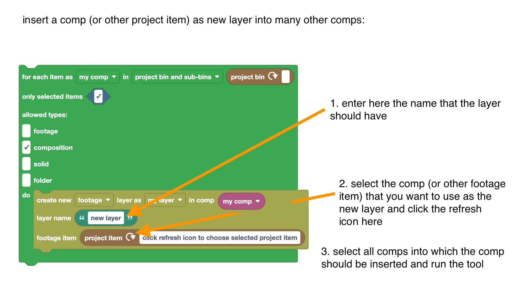

Mathias Moehl
November 2, 2022
Perfect job for Automation Blocks:
I attached the Automation Blocks script to this post, such that you can directy load it into Automation Blocks.
Mathias Möhl - Developer of tools like BeatEdit and Automation Blocks for Premiere Pro and After Effects
