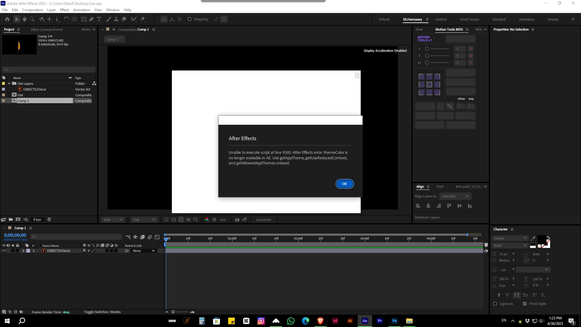

Issue with installation Duik Bassel
what the meaning? and what I do?

I'd recommend installing the Duik Angela over Duik Bassel because it's the new one. You might need to reach out to the Duik support and see if they can help with installation.
Let us know how it goes. Here's a tutorial that should get you started with Duik Angela: https://adobe.ly/4m8ER58

Apparently the version of Duik Bassel you have isn't compatible with the scripting changes that were made to accommodate the Spectrum UI changes for AE 2025. I don't know if there's an update of Duik Bassel to solve this, but you should check with the developer. Other than that the only thing I can think of would be to use AE 2024 for your project.
