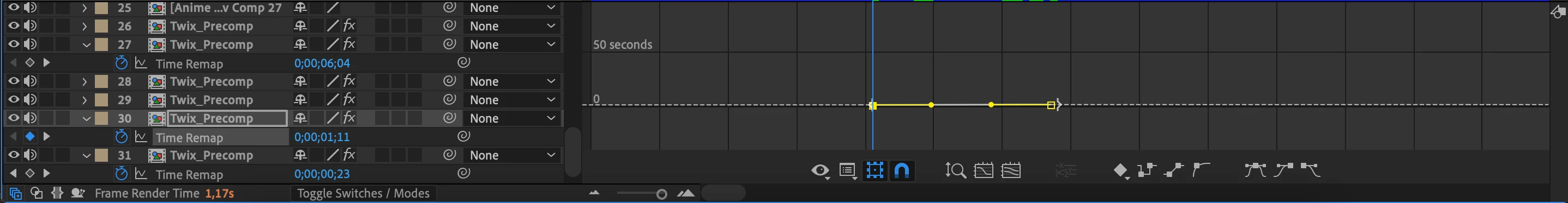

Hi I am working on a time remaping composition but when I easy easy the keyframes and go to the graph editor they just apear as a straight line? They are supposed to curve. If someone have experinced this or know a solution I will be glad to hear?

Well, have you actually used the auto-zoom/ fit? Your graph is covering a span of 75 seconds, when the actual difference in values is 4 seconds. That would of course look almost flat...

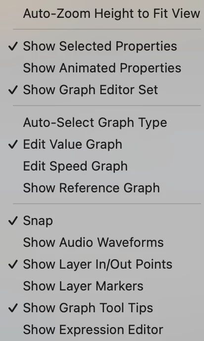

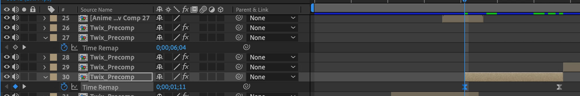

This is how it looks like in my project. I have tried chatting with an agent and reseting my preferences, but it still looks the same.
I also made sure that I edited on the value graph.
