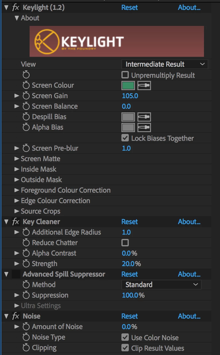

I've tried adjusting the screen gain but without much luck in Keylight. I also tried adjusting "screen pre-blur" which helped a bit but was hoping to avoid it if I can.
Should I pre-process the video before somehow os is there a better way?

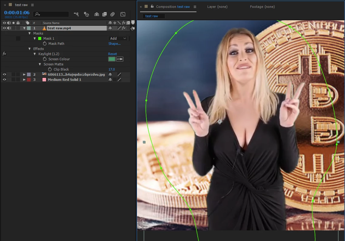

not sure how you got this result.
taking your shot to keylight does not give me that noise.
I do hope your raw versions has better information that what youtube made of it, because there's some work to be done on those edges. but nevertheless, it's a rather simple key work.

Without seeing your effect settings and ideally a full-res image of the original source nobody can tell you much. in order to eliminate the noise people have to understand where it might stem from.

This could be pretty easy.  Duplicate the chroma key layer.  Remove Keylight from the lower layer.  Use the upper layer with Keylight as an alpha matte for the lower layer.
