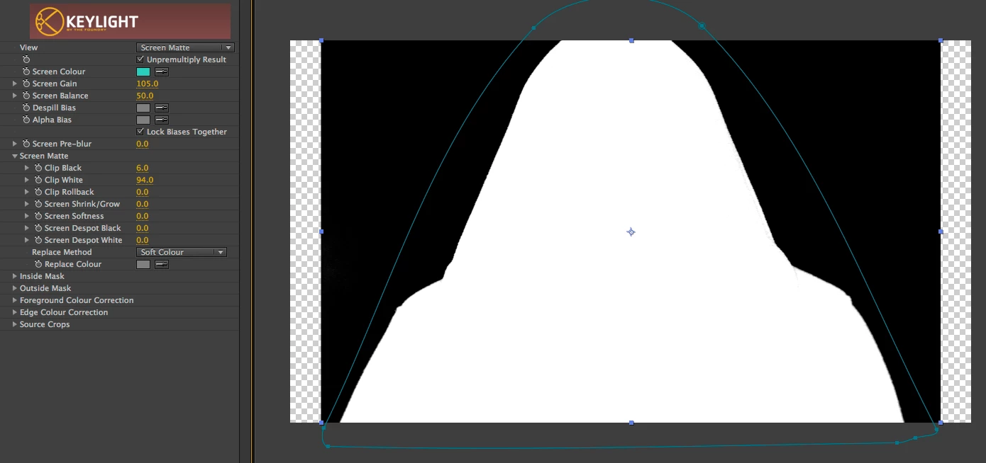

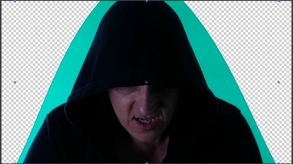

Firstly please forgive my lack of use of correct terms, I'm new to this.
I have shot some footage to the best of my ability.
  • Flat, evenly lit green screen,
  • Subject as far away from the screen as possible,
  • Shot on a Canon EOS 5D Mark IV.
Yet even though keylight seems to key really well, as you can see from the screen shots below,
when I play back the keyed footage, it is not sharp like it was before keying. It has a kind of black noise.
Please can someone help me fix this as I'm sure I'm probably making a rookie mistake but after nearly two weeks of trying to remedy this problem I am out of ideas.

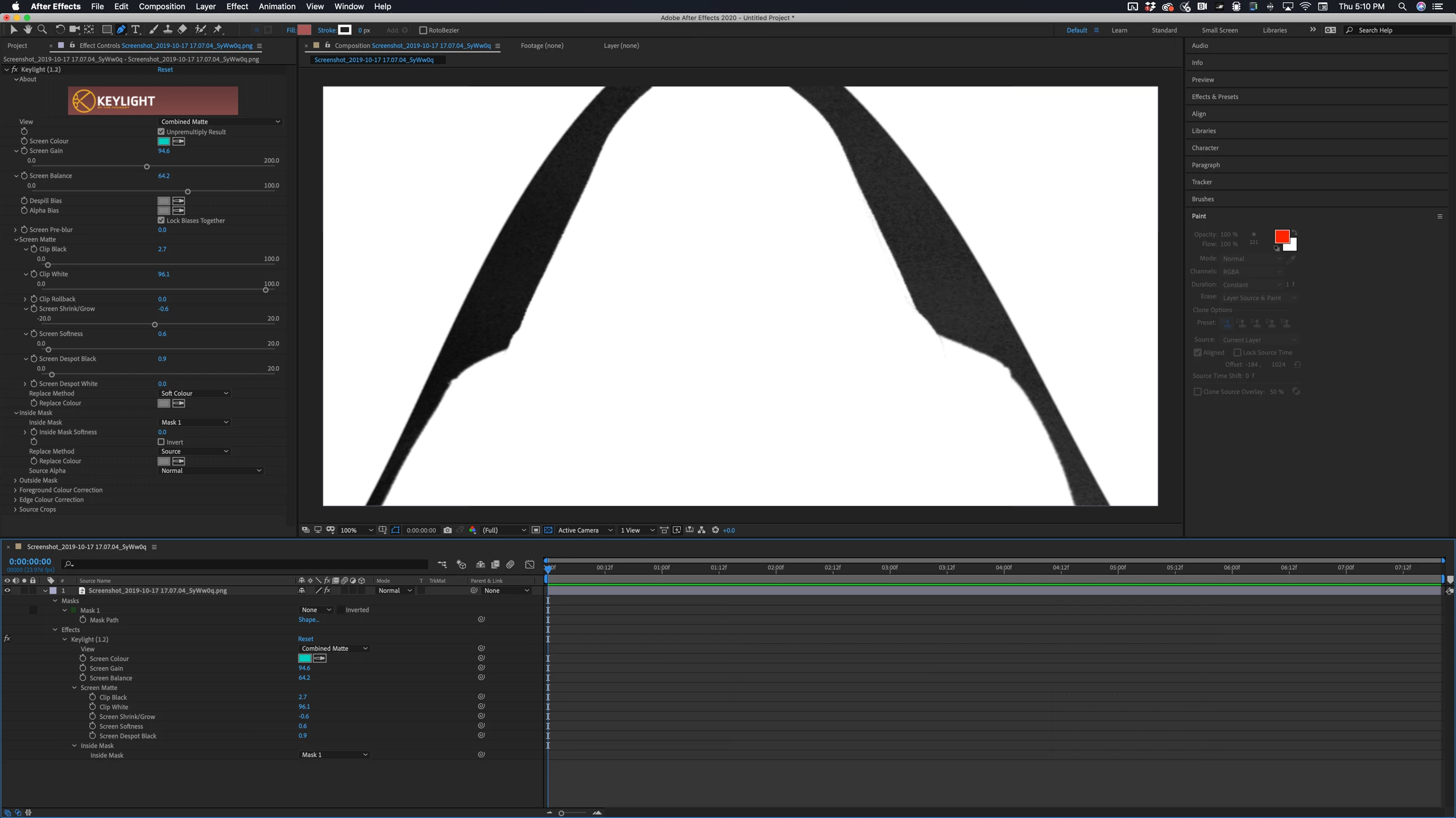

If you are getting noise in the black you have not properly adjusted Keylight. Have you checked the user guide? Have you checked the combined matte because the Screen Matte doesn't really show you anything? Cropped screenshots are almost completely useless in diagnosing problems. Select the footage layer you are having problems with, press uu, PrintScreen and then paste to the forum.
I took a screenshot of your screenshot then applied the typical minimum adjustments I make to a keying project. I'd be willing to bet that you have only fiddled with two or three settings. This would be my check before moving on tho things like edge color, light wrap and all of the rest that you really should do when you use any keying application.

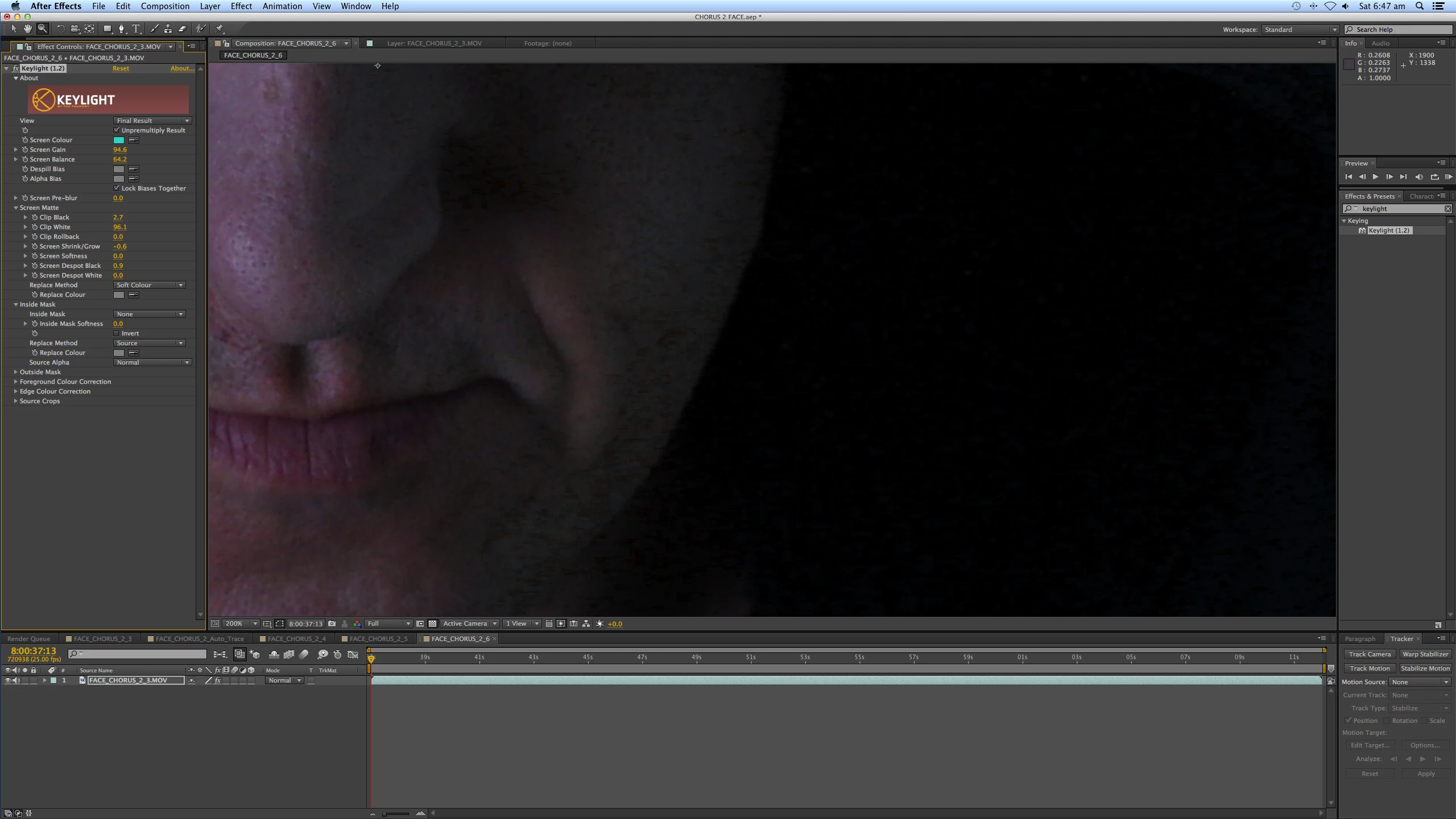

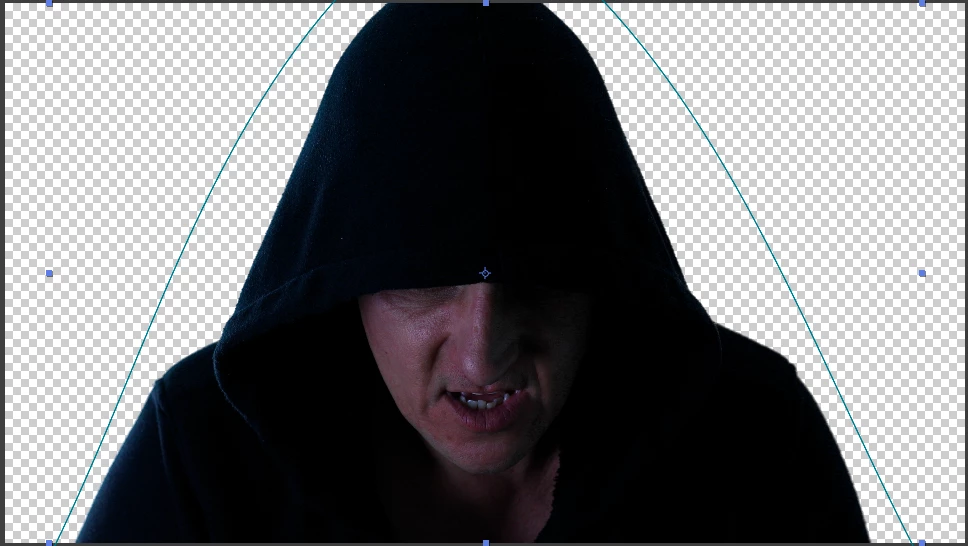

Original footage.
Keyed Footage.
