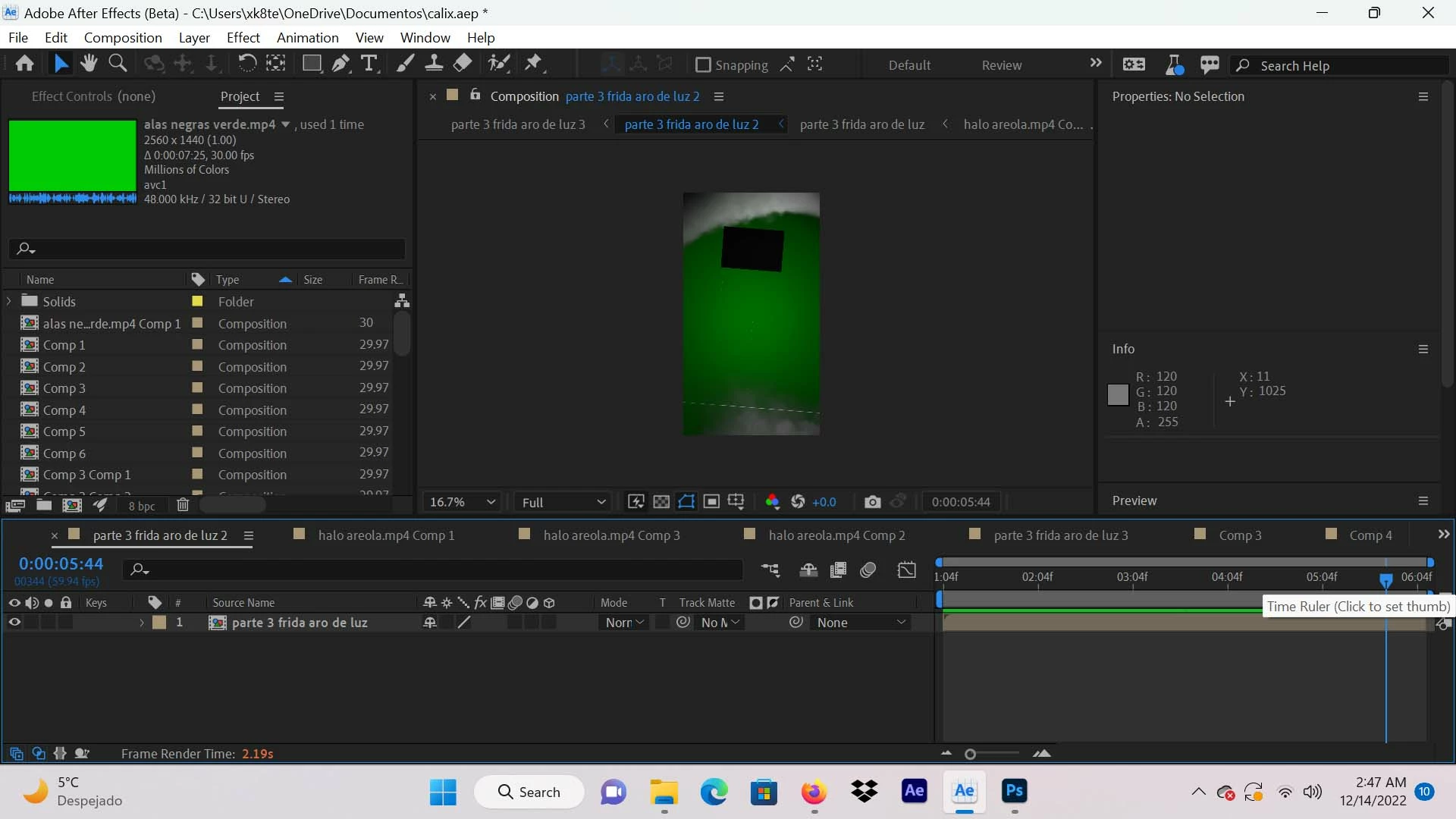

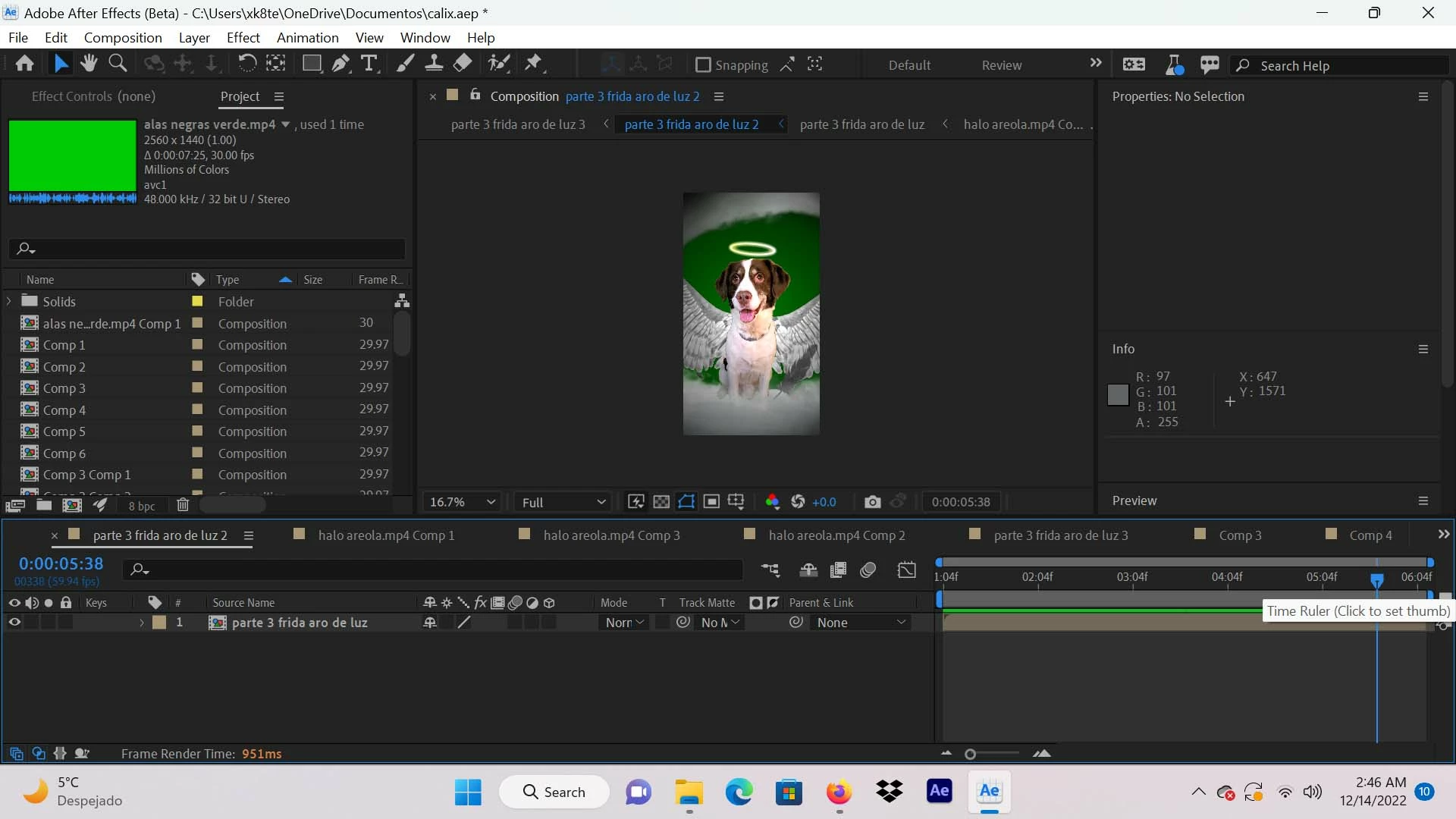

December 14, 2022
can you help me? i have the exact same problem, i use a lot of green screen footage  i already clean the cache memory  and  made a  purge and disk cache and nothing is working. please, can you tell me what did you do in your settings to solve this?
my specs
i7 12700f
32gb ddr5
gtx 3070
