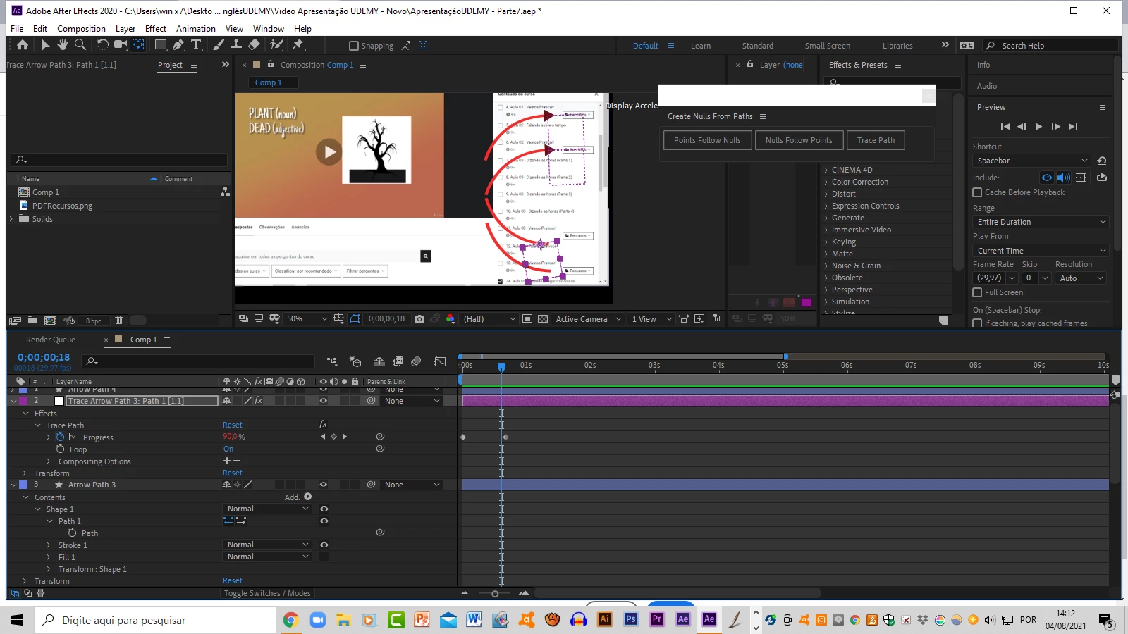

Thanks for the reply. I´m sending two screenshots for the sake of clarification.
In the first upper shape layers the arrowhead are working ok. But in the third one, as you can
see, as I move the playhead, shows the trace Path spinning along the path.
August 4, 2021
It may be important to add that I only created the first shape layer (first path). The others are just CTRL-C CTRL-V of the first.
