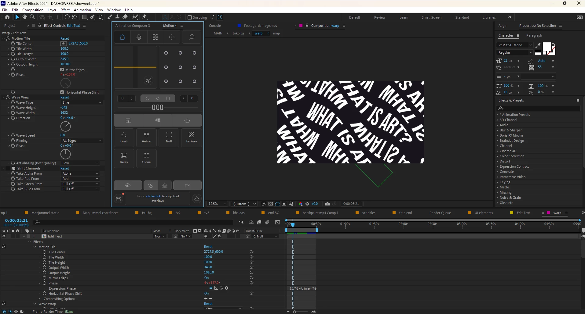

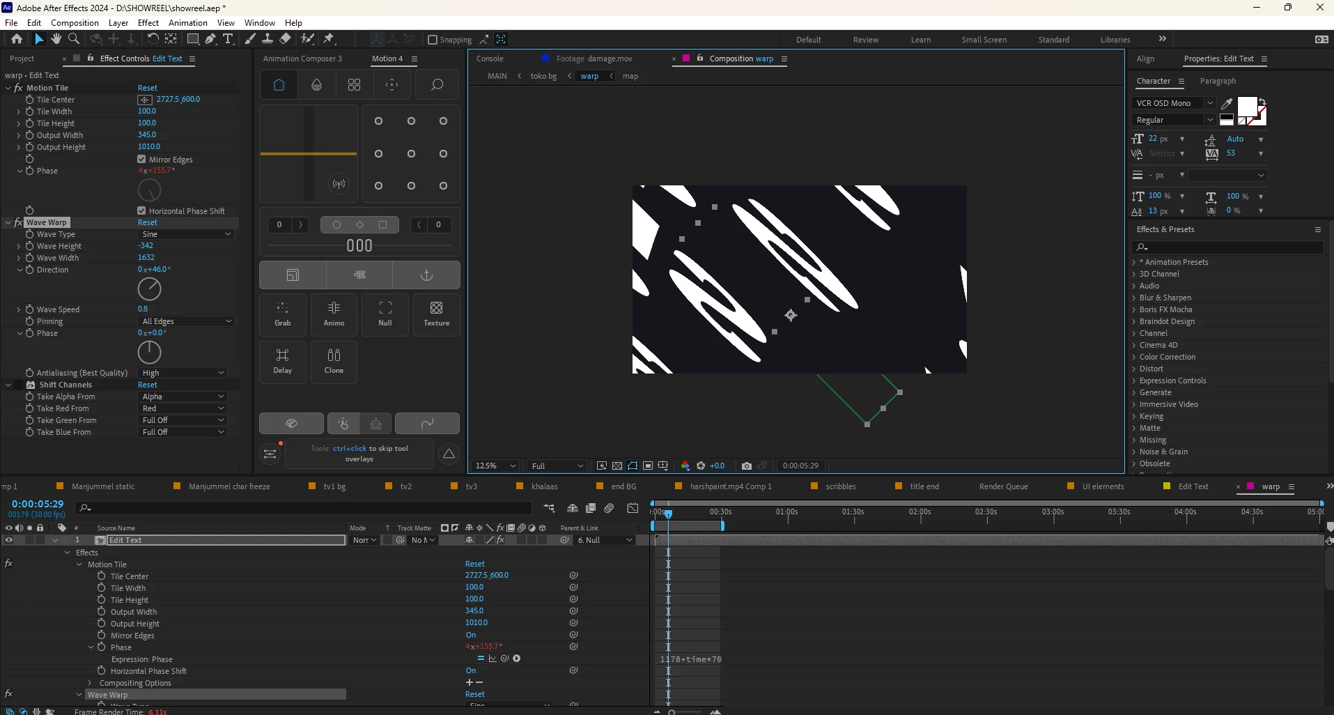

    Stumbled across this problem again.. but in my case, the layer just doesnt render at all, I can see it on the composition preview but render comes out with just the Background, the culprit here is again the WAVE WARP again as if I remove that specific effect, the text layer is visible again on the final render, even tried changing the anti-aliasing to medium and high, there again  new problem arise as the layer is now visible but its skewed beyond recognition. :')

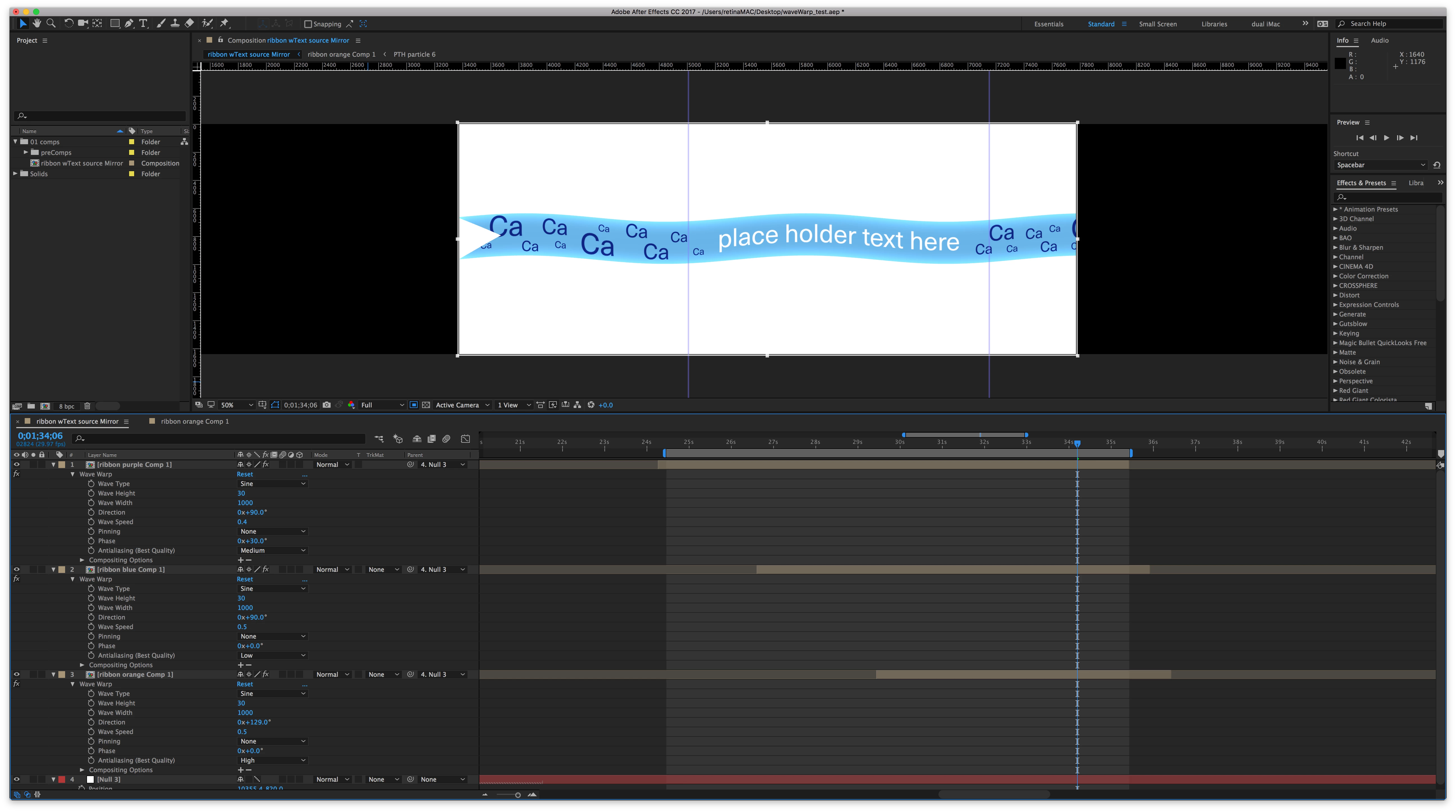

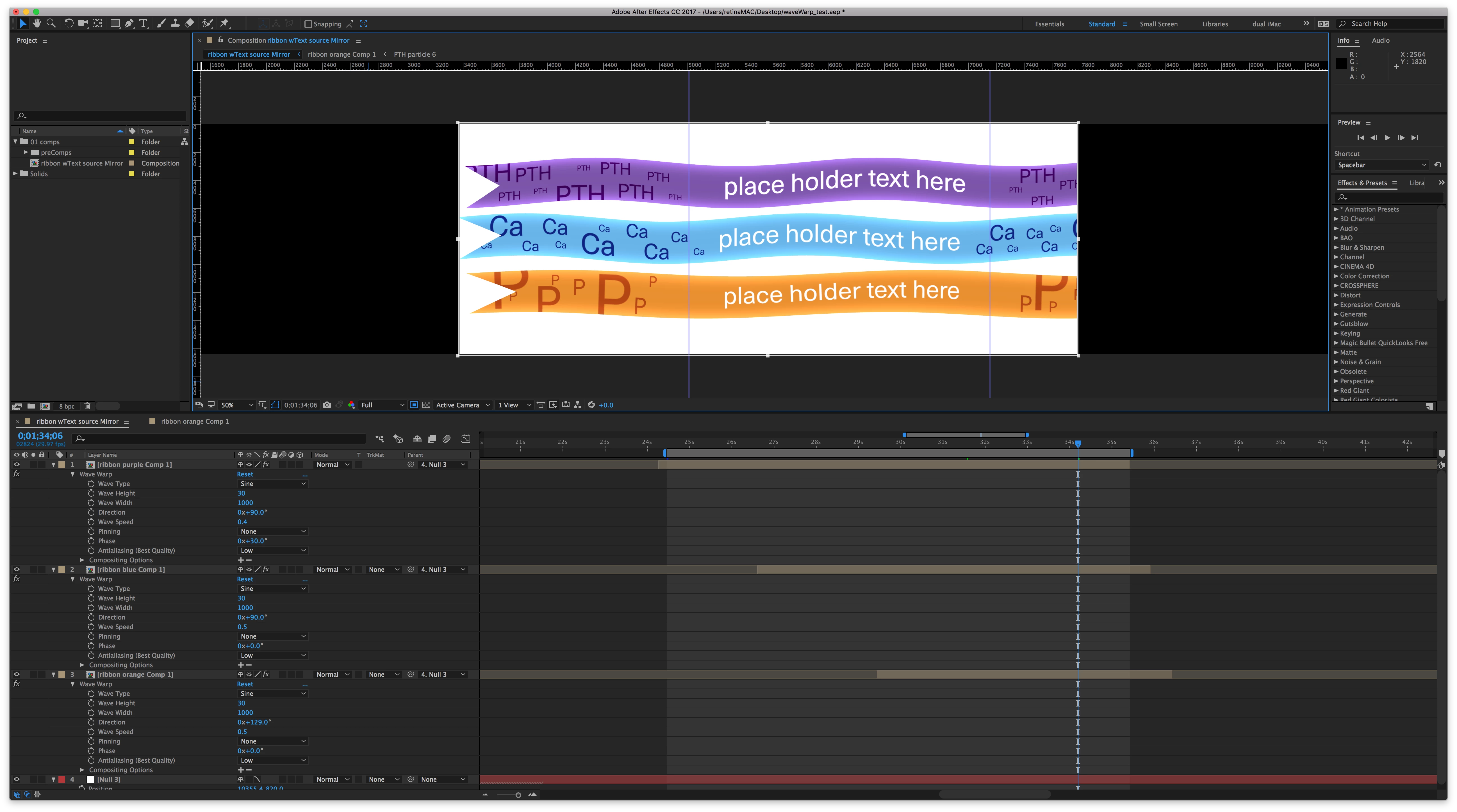

    The project is animating ribbons. The master comp is big; 11508 x 1640. In that comp are 3 preComps, each are 6000 x 250 that consist only of solids and text. In the master comp I apply wave warp to each of the ribbon preComps.  When I set the antialiasing to low the ribbon preComps are visible. When I set the anti-aliasing to either medium or high the ribbons disappear. I have attached 2 screen grabs. Another element is that these layers are set to continually rasterize - which I need to have on if my other effects (which are not part of this sample) are going to work. If I turn off rasterization then the ribbon preComps are visible at all antialiasing settings.
