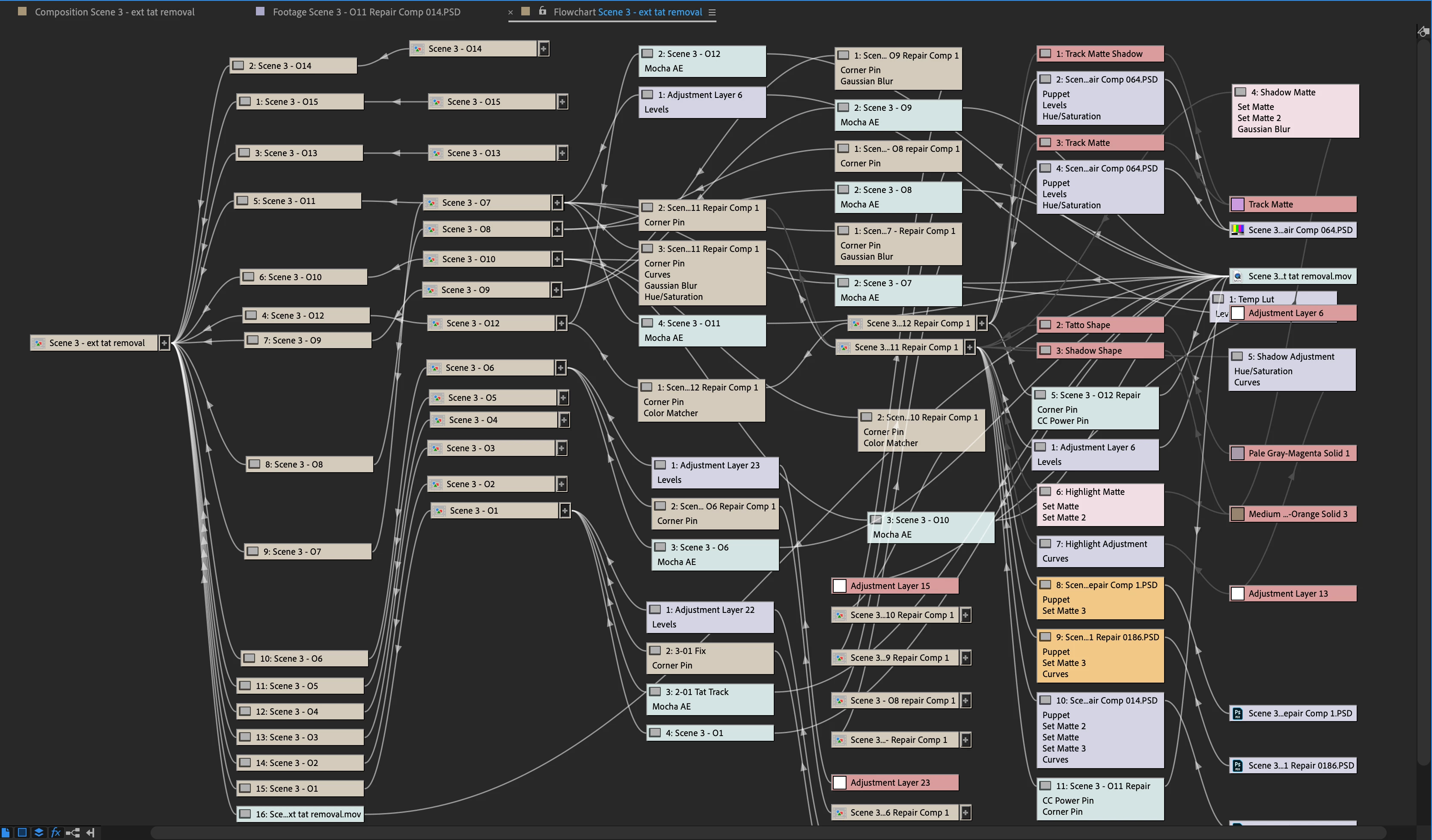

I've been on a VFX project for a feature film since February. A couple of weeks ago the Producer wanted me to make some changes in a shot. There are only about 50 frames that need fixing. Here is a screenshot of the Project panel.
The shot (Scene 3-10) that needs fixing is 0:03:11 - just over 3 seconds. The shot that it comes from is 2:17:02 - just over 2 minutes seventeen seconds.  If I take a look at the whole shot the editor sent me this is how complicated the comp is and I have only expanded half of the nested comps that make up just Scene 3 in this 6 scene project.

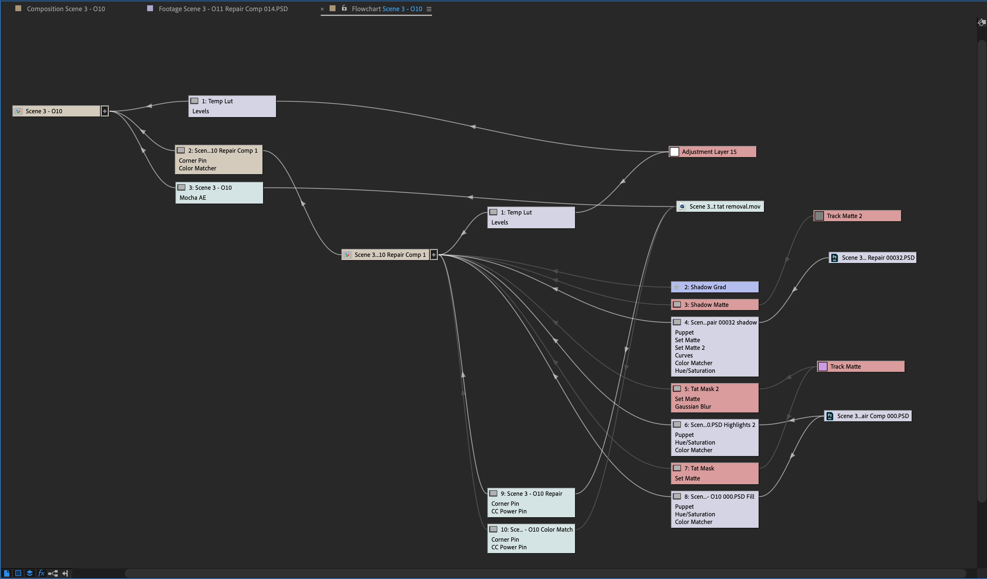

Doing the repair only required me to dive into this array of layers and effects:
All I had to do was open up 3_10 Repair Comp, go to the Track Matte 2 layer and adjust a half dozen hand rotoscoped mask keyframes on two masks, move back to Layer 4 - adjust the settings and add some keyframes to curves, then open up the Scene 3 00032.psd and do some more clone and healing brushwork, then return to Layer 4 and fine-tune a half dozen puppet pin keyframes and adjust the timing of opacity keyframes to fix the glitch in the roto.
The repair took about 20 minutes to render. If the editor could use an image sequence instead of a Pro-rez file I could have just sent the 50 frames and the render would have taken about 4 minutes. If I had everything in one comp the render could have easily taken several hours and the likelihood of a render failure goes way up.

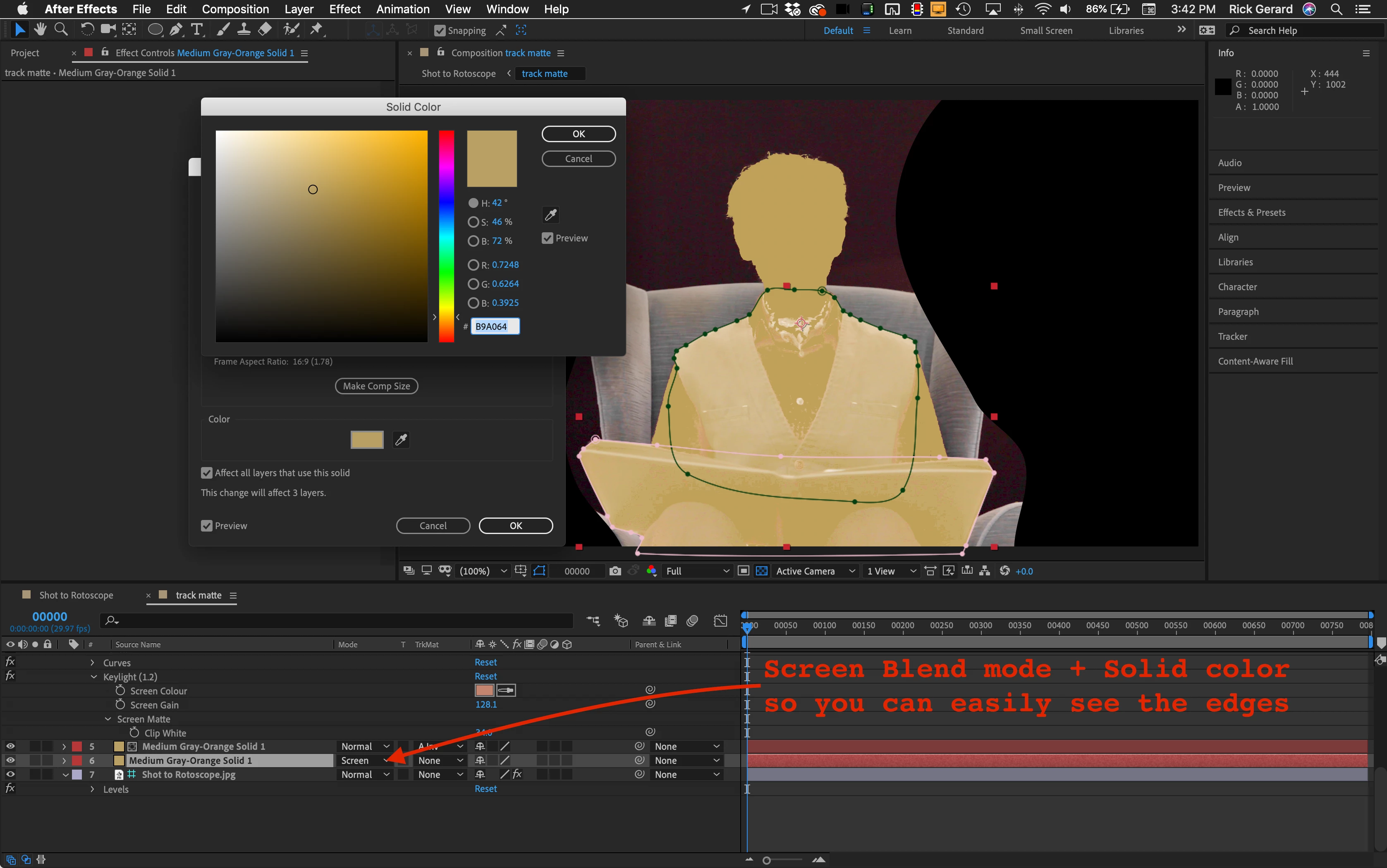

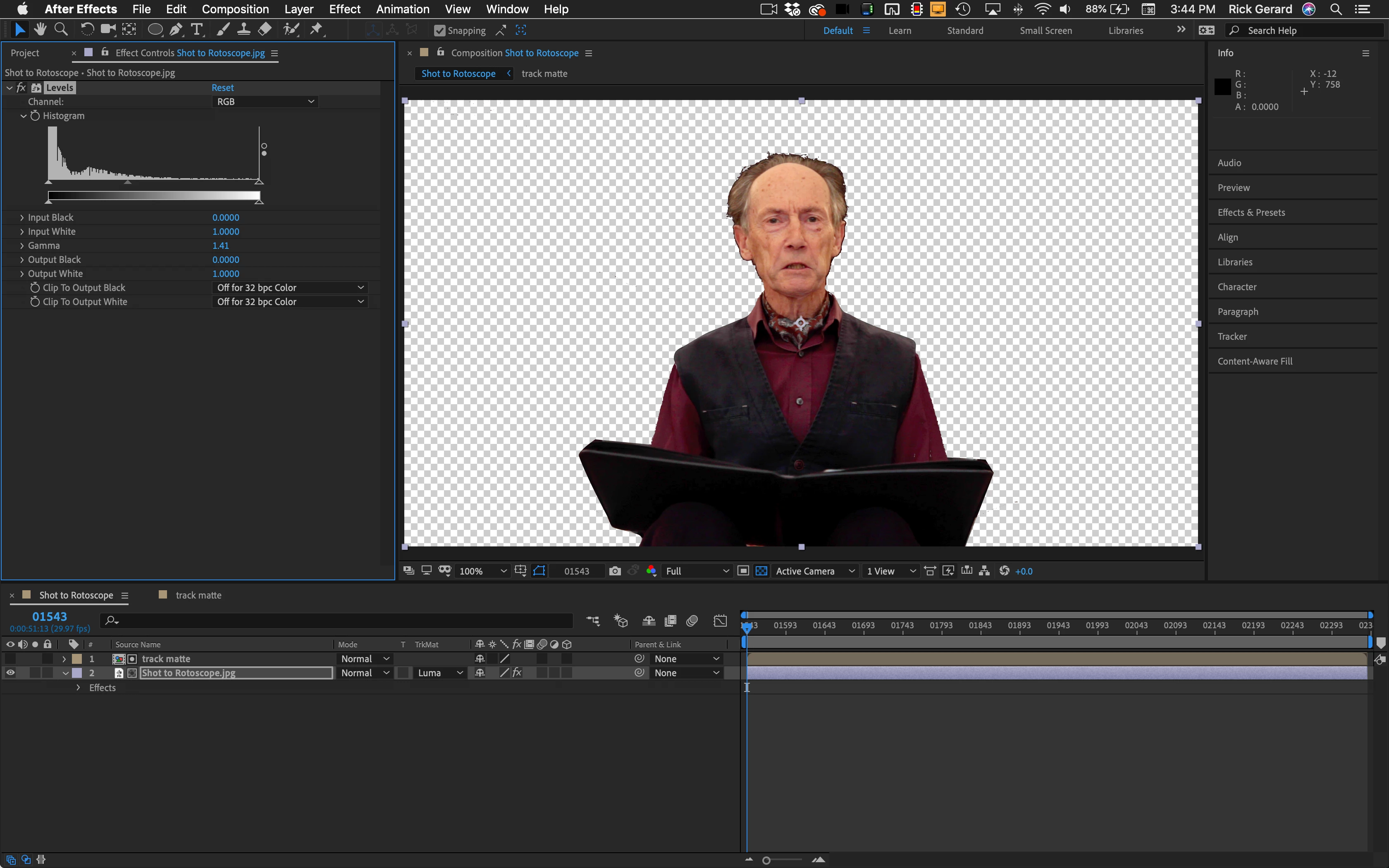

The efficient way to rotoscope is to figure out ways to save time and use as few keyframes and mask points as you can. Your shot is one that is perfect for a procedural matte to pull clean edges from the chair and the actors hair with a procedural matte, then combine that with a cuple of simple masks and a track matte created with a very simple mask path on a solid to fill in the holes left by the procedural matte. Take a look at this animated gif:

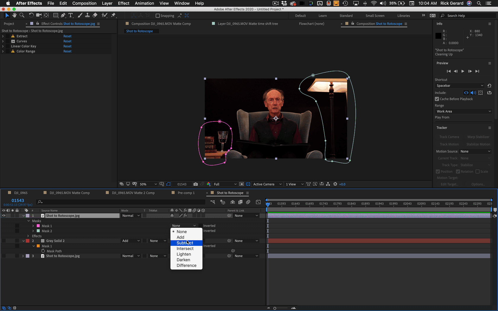

The first thing I did was duplicate the footage layer and insert a light gray solid that I can use as a track matte between the duplicates. I then selected just the top layer and tried extract + Curves, Linear Color Key, and Color Range key to remove the black background and give me some good edges. Color Range produced good detail on the hair. Rotobrush probably would also pull good detail on the hair but using an effect to create an alpha channel from the black background was far fastrer.
The last step was to set the blend mode to screen so I could easily see through the layer and draw a very quick mask around the holes I needed to fill. If there is not very much movement in the shot then you're done. The only part of the project that requires precise masking are the edges of the black book. The rest is taken care of by the procedural matte on the top layer.

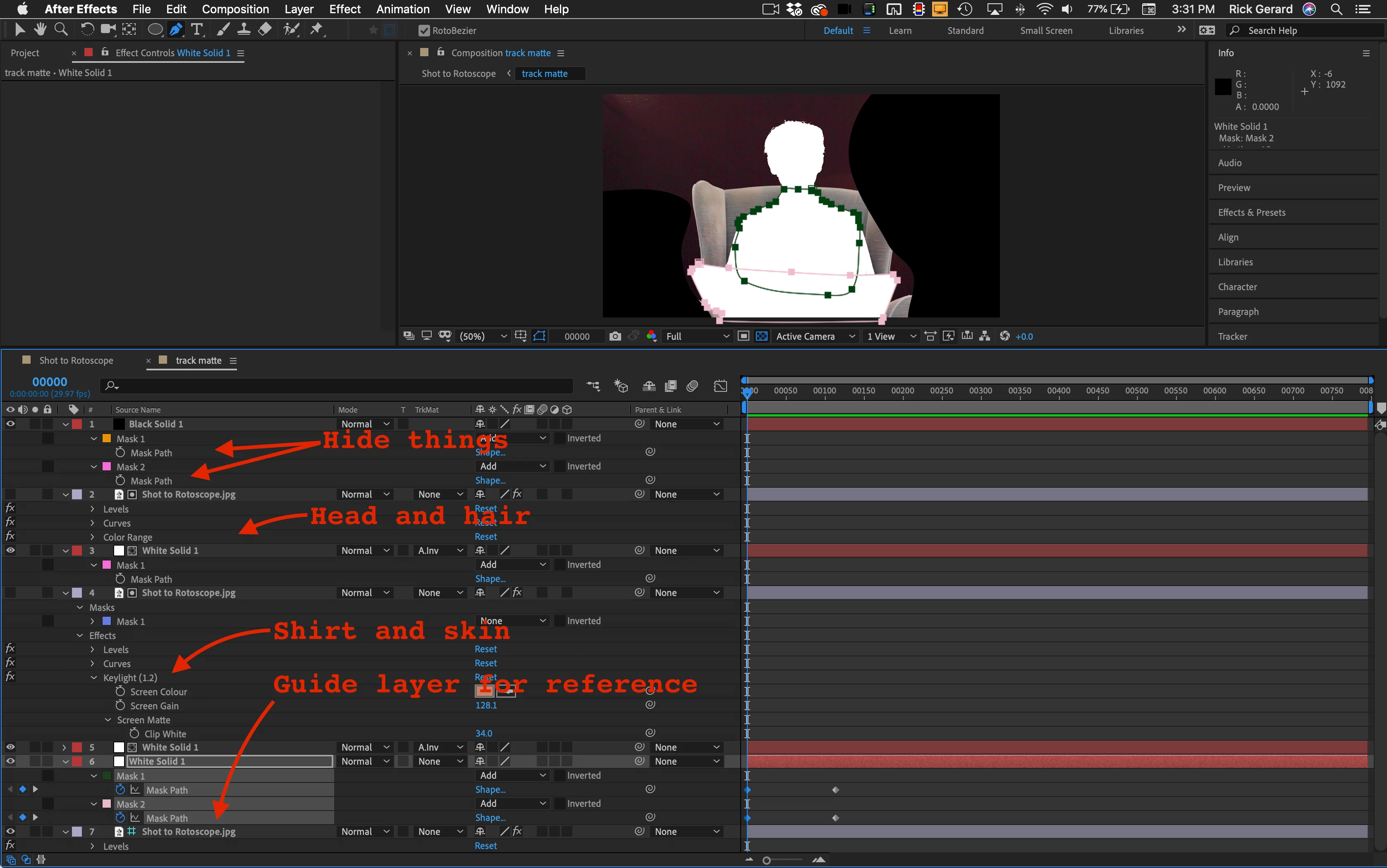

Here are some screenshots showing how I would use color range to create a matte for the head and hair, then on another layer Keylight to create a matte for the sleves and neck, then animate just a couple of masks on the body and the book to roto this scene. Two procedural mattes to find the difficult edges and one solid with just a couple of animated masks would do the trick. There are litterally hundreds of ways to create procedural mattes. Most shots that require roto can be simplified if you combine techniques. Planning and executing the shot is the most important part of creating a workflow that takes hours instead of weeks or months. About 15 years ago I worked on a project with about 40 other artists. My 90-second shot took me about 200 hours to roto because the roto work was an afterthought.
The screenshots with notation:
The Project File for reference.
