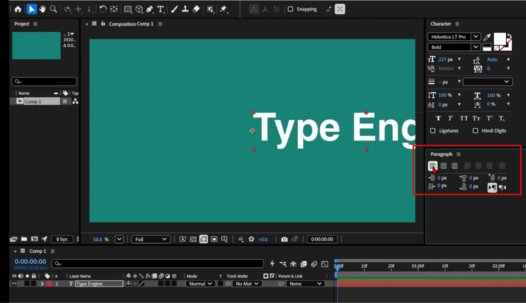

Left & Right Sides of Paragraph
Left aliment moves the text to right side of comp and right aliment moves the text to left side of the com. How to understand this? Video is attached as well.

    Hey Maha,
    Thanks for the question! This usually happens because paragraph alignment in After Effects is controlled by the anchor point, not the composition.
    For example, left align keeps the left edge of the text fixed to the anchor point (so the text extends to the right), and right align does the opposite. If your anchor point is on the “wrong” side, it can feel like things are reversed.
    Try moving the anchor point to the left side of the comp and it should behave as expected.
    Hope that helps!

    Kevin-MonahanCommunity ManagerCorrect answer
    Apr 27, 2026 5:44 PM UTC
    Hey Maha,
    Hope that helps!
    Kevin

    Thanks for the explanation.
