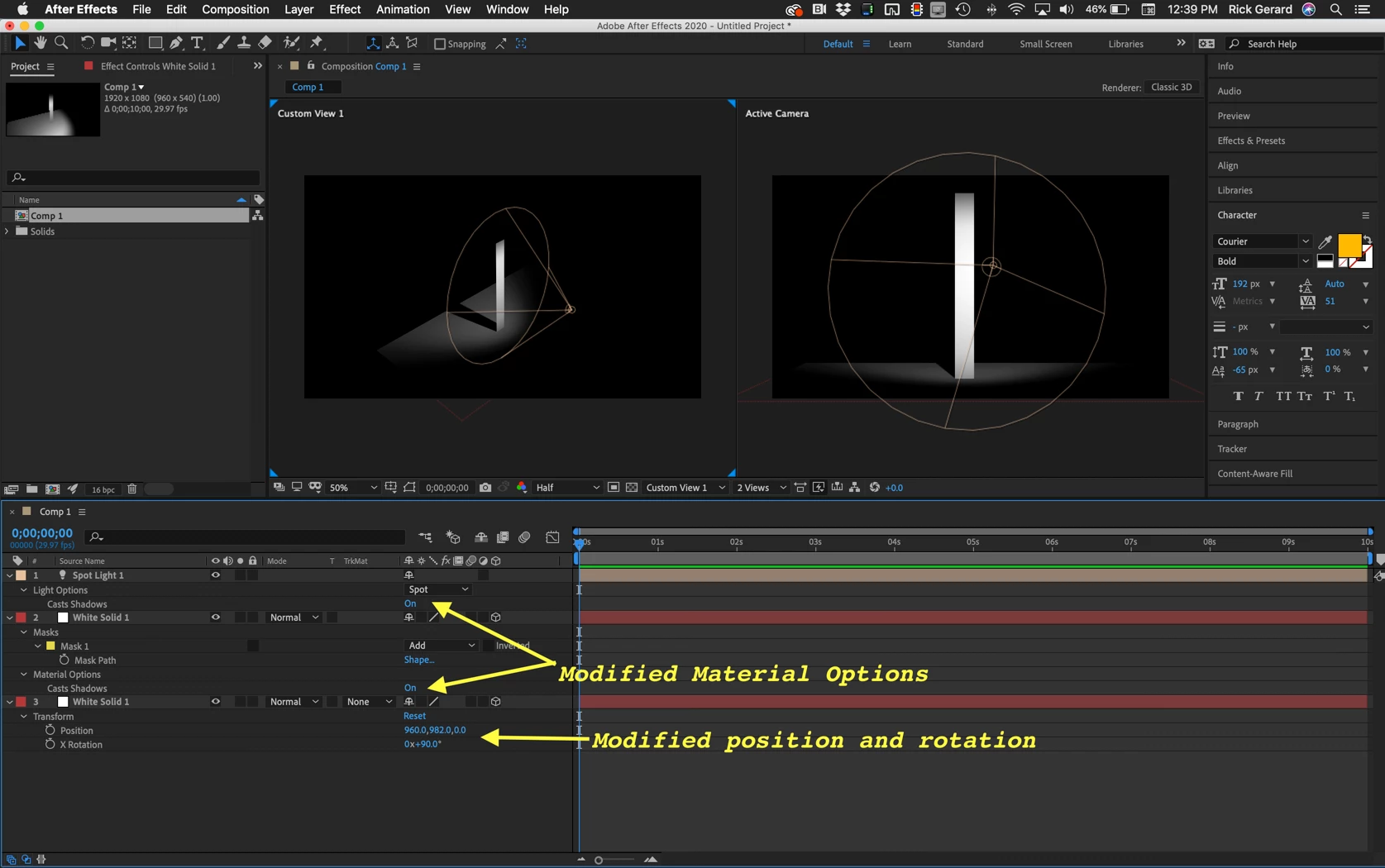

Questions like this without a screenshot showing us the modified properties of your layers are almost impossible to answer. Try this:
  • Create a new comp using one of the Composition presets that give you square pixels and make sure the comp is set to use the Classic 3D rendering engine
  • Add a light gray solid to the timeline and make the layer 3D then duplicate the layer
  • Select the bottom layer and press R to reveal the Rotation Property and rotate the layer 90º in X then move the layer down near the bottom of the composition
  • Select the Rectangle tool and create a vertical mask on the top copy of the solid so it now looks like a tall pole passing through the other solid
  • Add a point light or a spotlight to the scene
  • Set up 2 views in the Comp Panel and set one of them to Custom 1 and make sure the other is Active Camera
  • If you don't see a shadow press UU to reveal all modified properties of all layers then fix the properties you see so they look like this:
This screenshot shows all of the modified properties of all layers. In order for a layer to cast a shadow, cast shadows must be turned on for the light and the layer casting the shadow. Cast Shadows is off by default, but if you turn it on AE will remember the setting next time you make a layer 3D or add a new light to the scene. The color of the layer that is receiving the shadow is also important.

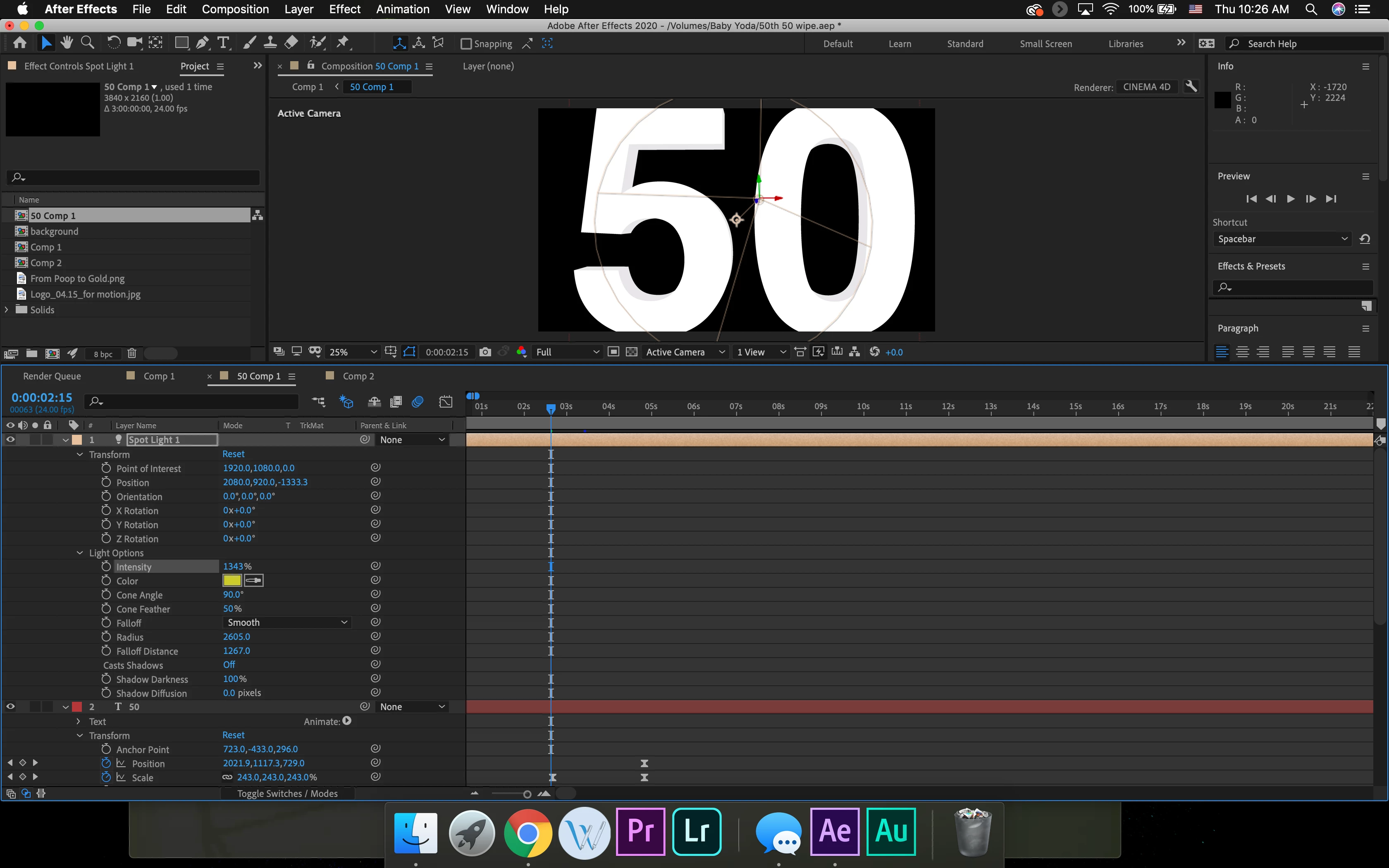

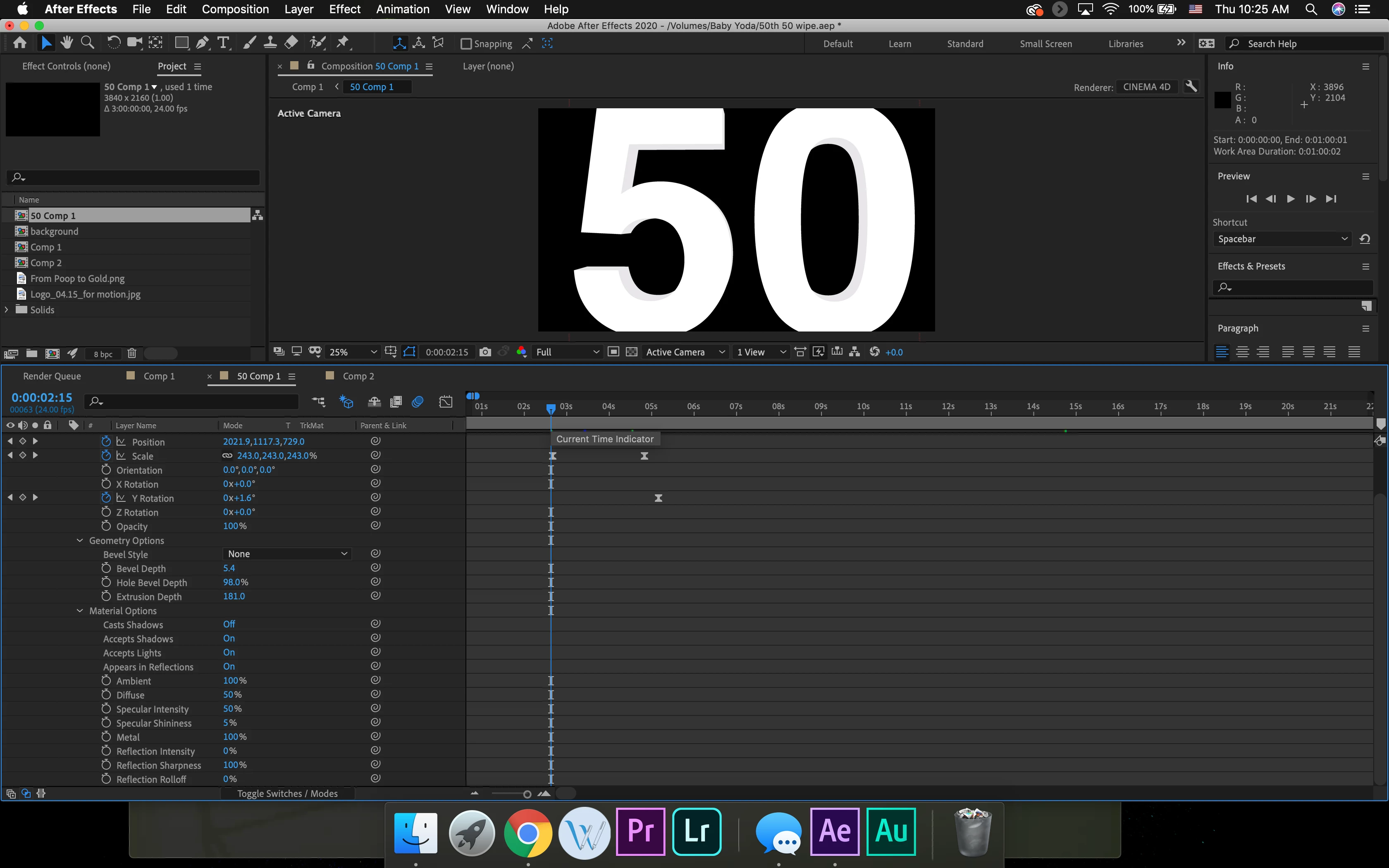

I followed your steps, and they work great in other files except in this particular file. Attached are the screenshots.  The problem is that I'm not seeing this light anywhere.
Mylenium
March 26, 2020
Your timeline is set to "Draft 3D" which of course will not give detailed shading and only a simplified version. Turn it off and everything will be back to normal.
