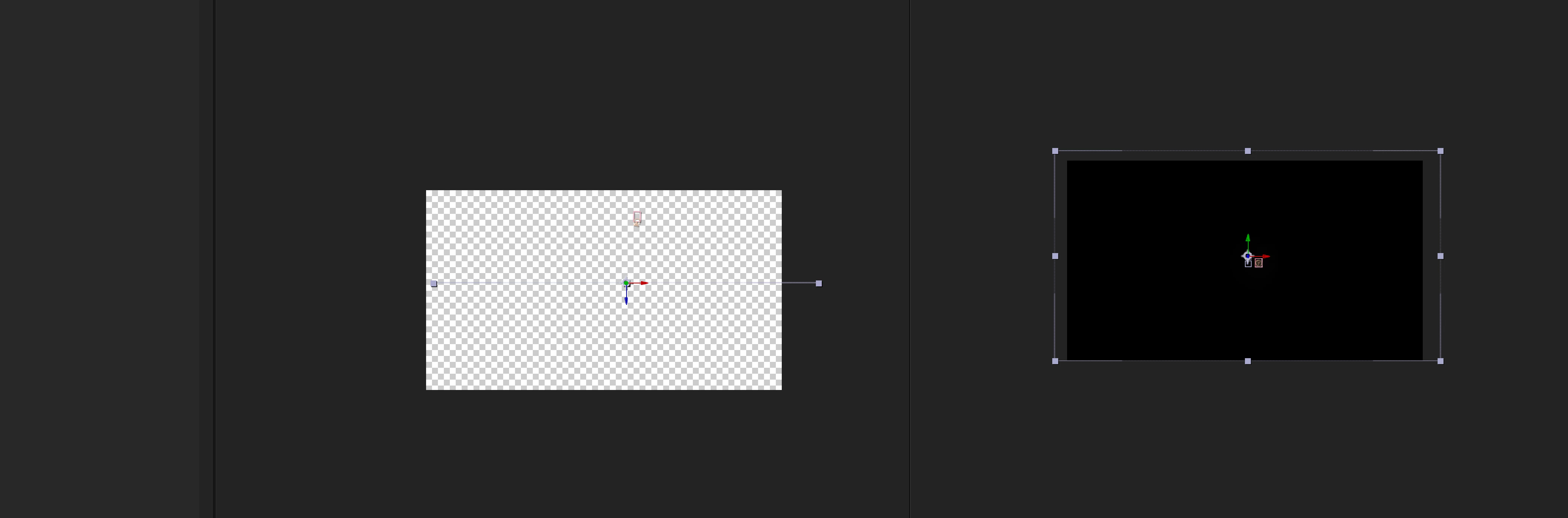

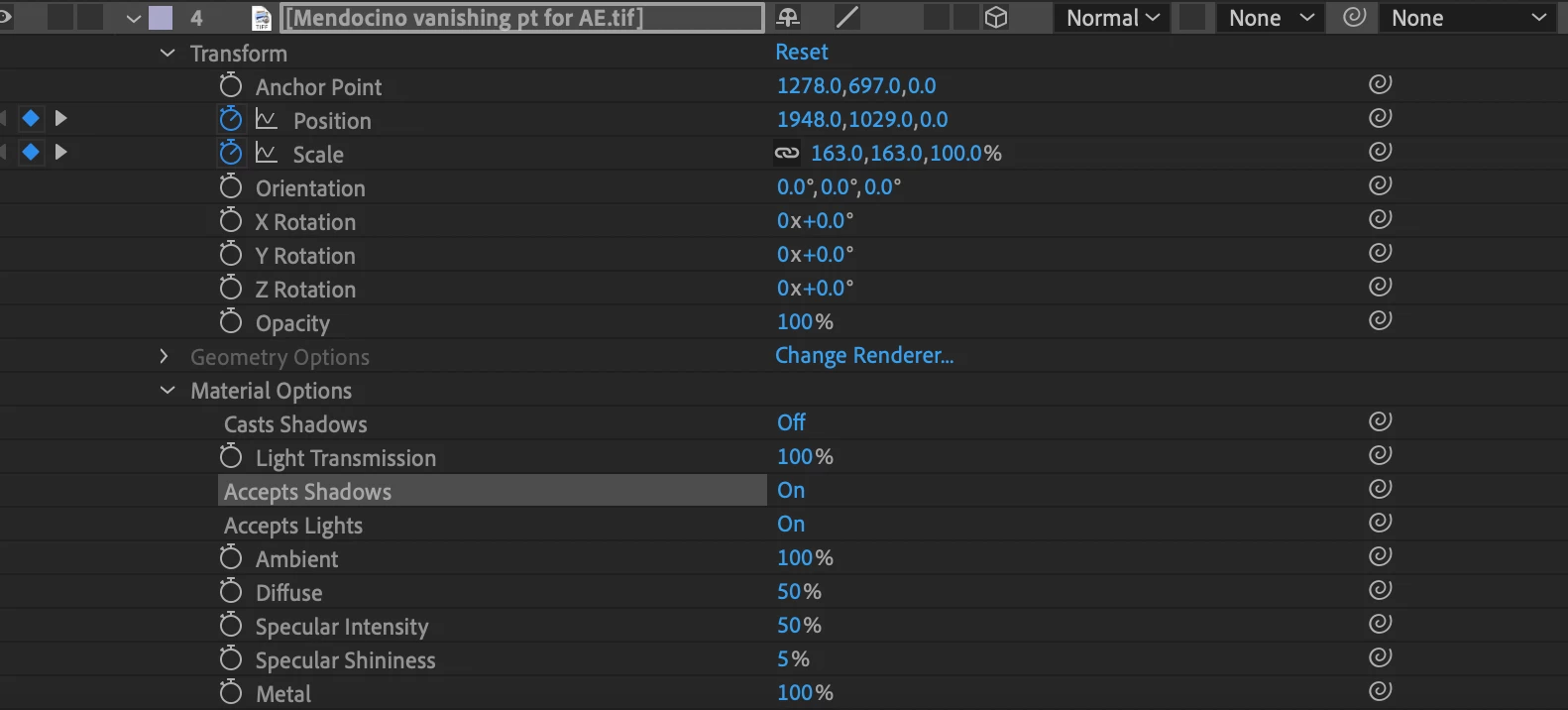

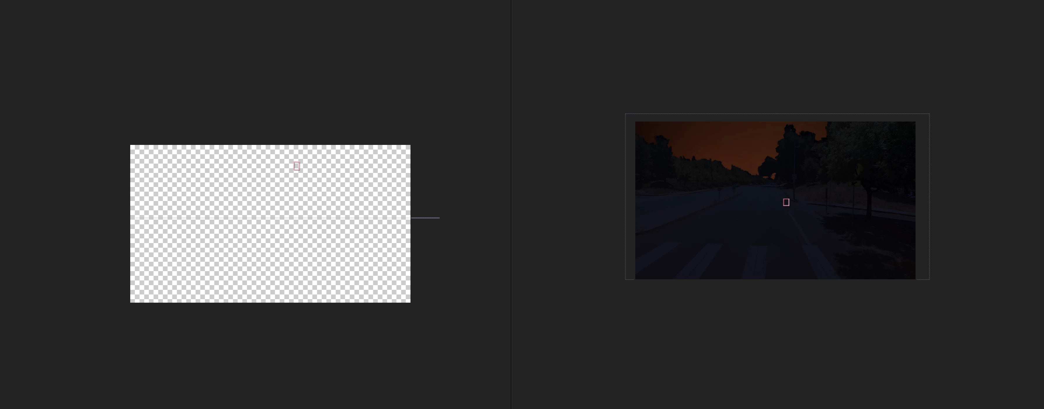

Whenever I try to light a scene the scene goes BLACK. Material is set to ACCEPT LIGHT.  If I turn off MATERIAL ACCEPTS LIGHT the scene shows but without a light.  The SPOTLIGHT does not work. The POINT LIGHT DOES work if it's right next to the layer and the intensity is set to 400%. AMBIENT light works. It's just the SPOT and PARALLEL lights that don't work.
SPOT is the most frequently used light.
They had me move my MEDIACORE filder in case my plugins were causing the problem (they weren't) and clearing my Media Cache (didn't help). They said they could not replicate on their end.
I am using a TIFF background and trying to use a single spotlight (I know it's dark—it's for a feature documentary I am doing called The Fire Cats).

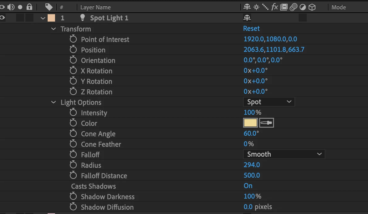

Your cropped screenshots are leaving out critical information. Is there a camera? Are you looking at the Active Camera View? The wireframe for the spotlight is not showing so the left view, which I can only assume is the top view does not show where the light is.  You are showing all of the Spot Light's material options and transform properties. Falloff, Radius, and Falloff Distance are not at the default values. Falloff is set to Smooth, the Radius is only 294 pixels and the Falloff distance is only 500 pixels. The spotlight is at 663.7 in Z, the layer you are trying to light is at 0 in Z so the spotlight is probably behind the layer. Even if it was pointed at the layer the distance between the light and the layer is more than the Falloff Distance and the Radius so the light can never reach the layer.
Try this. If there is a camera in the scene, temporarily turn it off. With the spotlight selected press the U key twice to reveal all modified properties. Drag a selection around all the properties in the timeline, right-click and reset everything. Press the U key twice again and you should see no properties revealed, and if the tiff layer is still at comp center you should see light on the layer.
Your light is not showing up because the layer you are trying to light is farther away than the falloff distance and it is probably behind the layer you are trying to light.

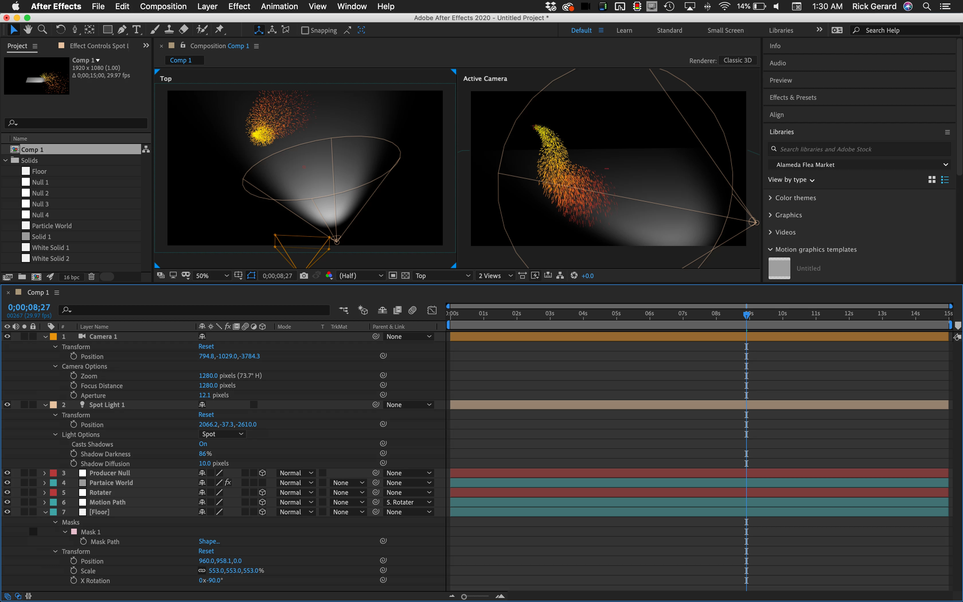

In the future, when you are troubleshooting a comp, the first thing you should do is select the layers giving you problems and press the U key twice. If you cannot figure out the problem by resetting things one at a time, then post a screenshot like this one. Everything you need to know to duplicate this setup except for the Particle World layers is shown.
