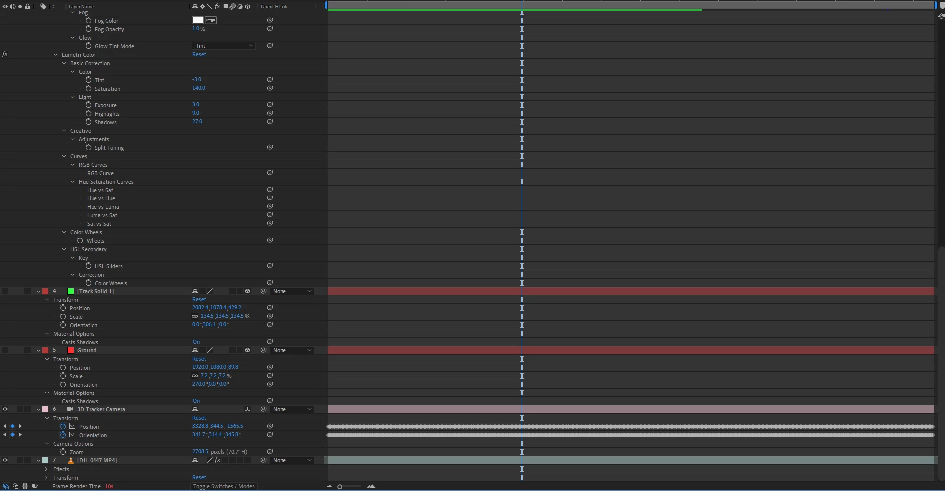

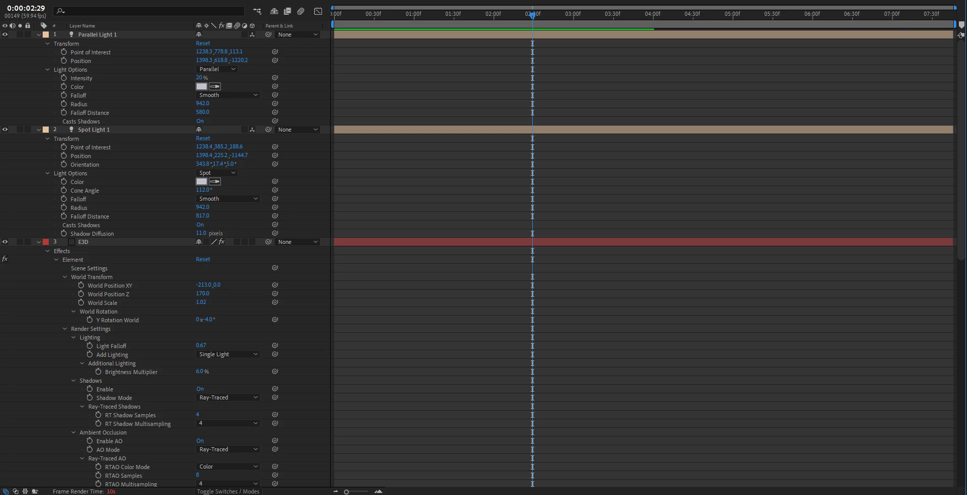

Sep 26, 2023 3:07 PM UTC
Thank you for the swift and detailed response.
Workflow Description:
  1. I started with a basic tracking of my clip.
  2. Once the tracking was in place, I incorporated the 3D model using the Element 3D plugin.
  3. After positioning and adjusting the 3D model as desired, I introduced the lighting to the scene.
Post these steps, I noticed the lighting anomaly that I initially described. I followed the troubleshooting steps you outlined:
  • Went to the last frame before the lighting issue starts.
  • Selected all layers and pressed the U key twice to review all modified properties. I paid special attention to any keyframes or new layers that might initiate on the subsequent frame.
  • Moved one frame ahead to where the lighting anomaly occurs. From here, I systematically turned off layers, checking if any of them might be obstructing the light source.
  • I also went through effects and other modified properties with keyframes, disabling them one by one to identify if any of them might be causing the lighting issue.
Regrettably, I wasn't able to pinpoint the root of the problem with the steps provided. As requested, I've attached screenshots of my timeline for a better visual representation of my workflow and the layers in my composition.
I'm hopeful that this additional information will shed some light on the issue and appreciate any further insights you might offer.
