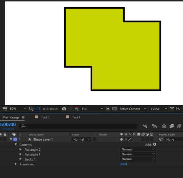

1 - I made two shapes in the same shape layer, which I can then give the same stroke. The problem here is obviously that I can't place a whole animation worth of vectors in one shape layer. Can I achieve this effect without putting every shape in the same layer?

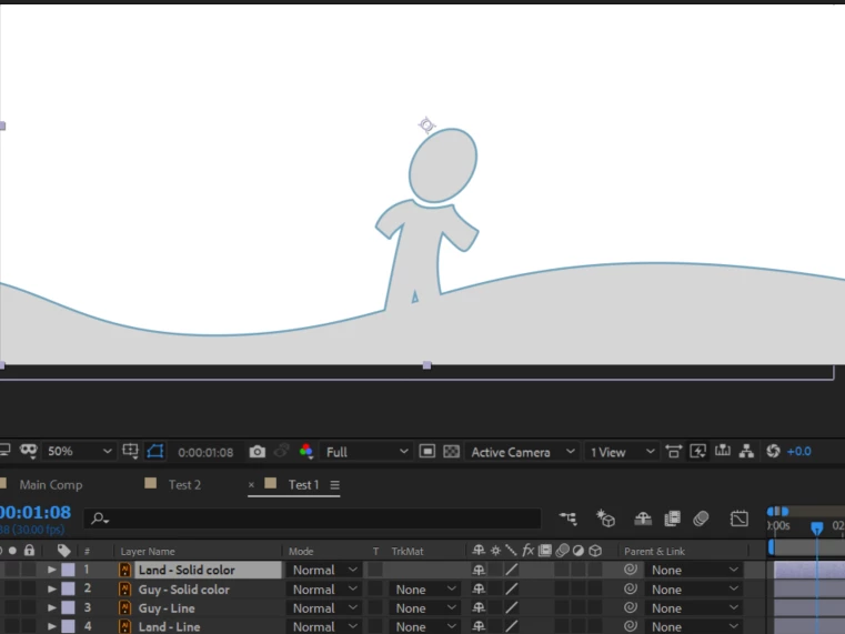

2 - I made every Vector twice. One layer on top with a solid color (made it gray here for clarity), and one at the bottom with an outline. It works, but not perfect either:
A) I have to make two layers for every single object in the animation.
B) It will probably be very hard to make the Line do any fancy stuff besides what I can achieve by moving the shapes around.
