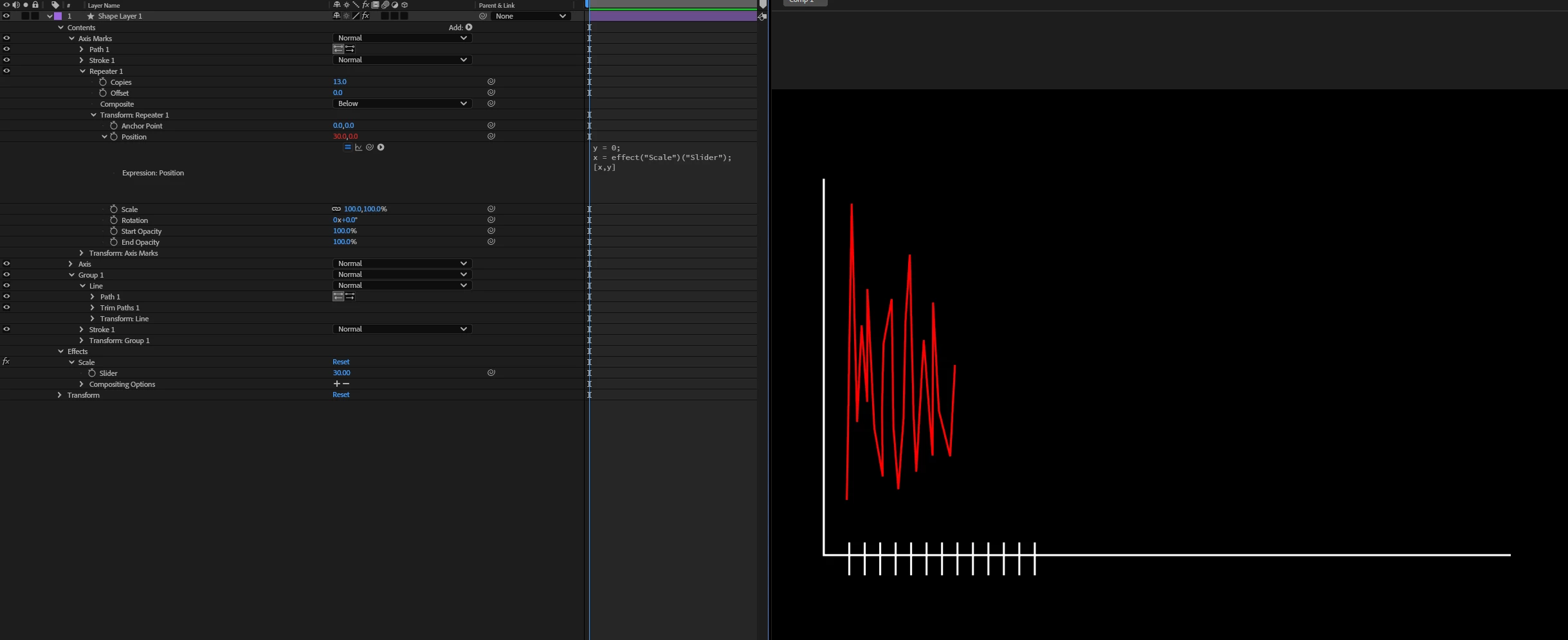

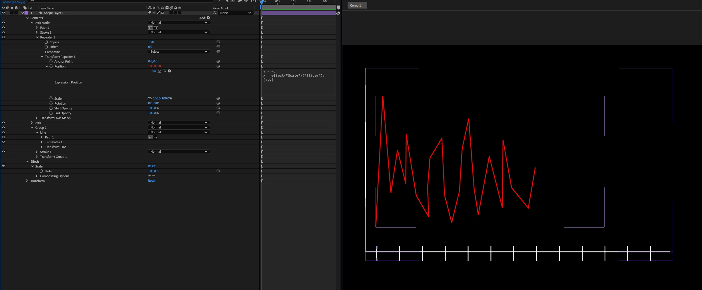

I had a quick play around with this.
Not sorted a Dot just yet, but you can see how the slider manages both the line’s scale (in a group so that I could keep the stroke below the transform) and the repeater’s distance for the X axis marks.

I think I’d do this with the full line sketched out, and use trim paths to draw it on, and then keyframe the width scale of the line so that it shrinks.  And scaling on the axis can be linked to the keyframed animation.  Dragging over the labels and repositioning the dot might be a little more time consuming, but for the dot, you could probably just link it’s width to expand as the line’s width shrinks with a linear expression.  Nothing too taxing really.
