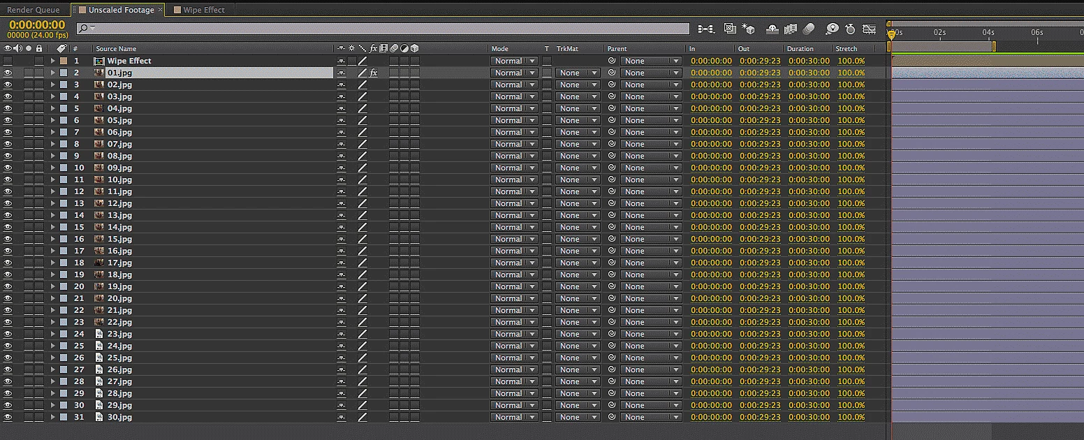

Hi, I am trying to set up a project where by i can drop multiple stills images into a comp and have a linear wipe go through them one by one, all controlled by expressions.

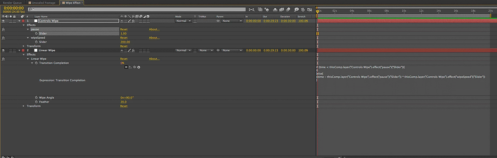

So I have a comp with the images in it and another comp with the wipe effect in it. Inside the wipe effect comp I have 2 layers, a null with two sliders and a solid with a linear wipe effect.
The first slider (called pause) controls the length of time before the wipe effect begins and 2nd (called wipeSpeed) controls speed of the wipe:
if (time < thisComp.layer("Controls Wipe").effect("pause")("Slider")){
}else{
((time - thisComp.layer("Controls Wipe").effect("pause")("Slider")) * thisComp.layer("Controls Wipe").effect("wipeSpeed")("Slider"))
This works great I can apply a set channels effect to each image layer that takes its alpha channel from the comp with the wipe effect.
