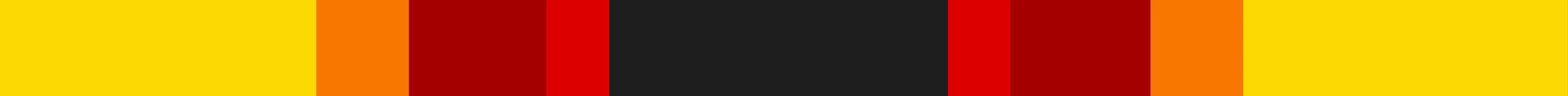

The thing is that I have a keyframed animated linear wipe on several rectangles that are mirrored so they act as a "curtain" and reveal the video underneath when they open from the center. I have keyframed the In & Out animations. The problem is that I can't find a way to add a wiggle effect on the linear wipe that works only in the span of time when the curtains are open.
All info I can find is related to keyframe the wiggle effect with the slider control. Is there a way to add a wiggle to an already keyframed linear wipe?
