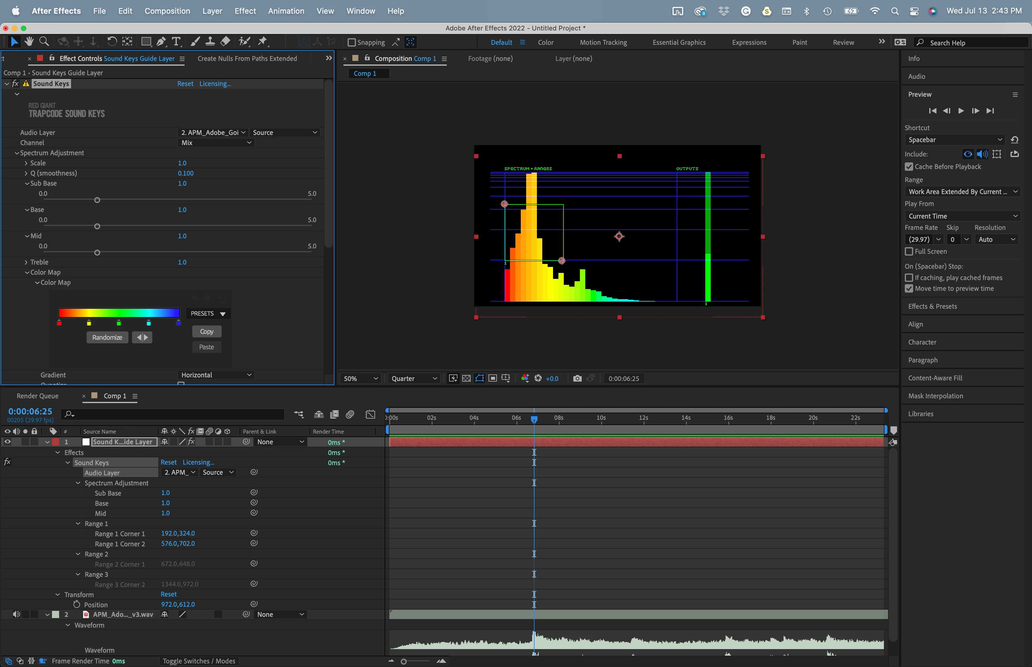

The other option is to invest in the Trapcode Suite and use Sound Keys. It has the ability to isolate frequencies, modify them, and pick ranges graphically. Here's before adjusting.
Here is after expressing the bass and sub-bass and raising the mid. The rectangle shows the selected frequencies I am going to sample.
If you do a lot of this kind of stuff and you get paid to do it, Sound Keys will pay for itself very quickly. It is part of the Trapcode suite at Boris FX.com.
