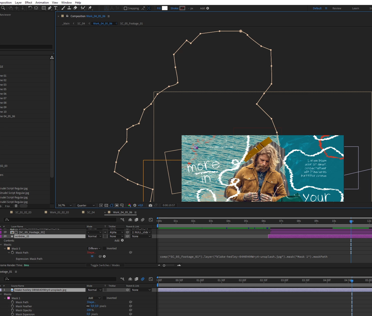

I link mask Path from nested composition. And the new mask becomes larger than the parent one. How I fix the size mask without scaling layer?

Paths are based on layer size, not comp dimensions. If you scale, move, or rotate a layer, a linked or copied path, the position of the new path will not match.

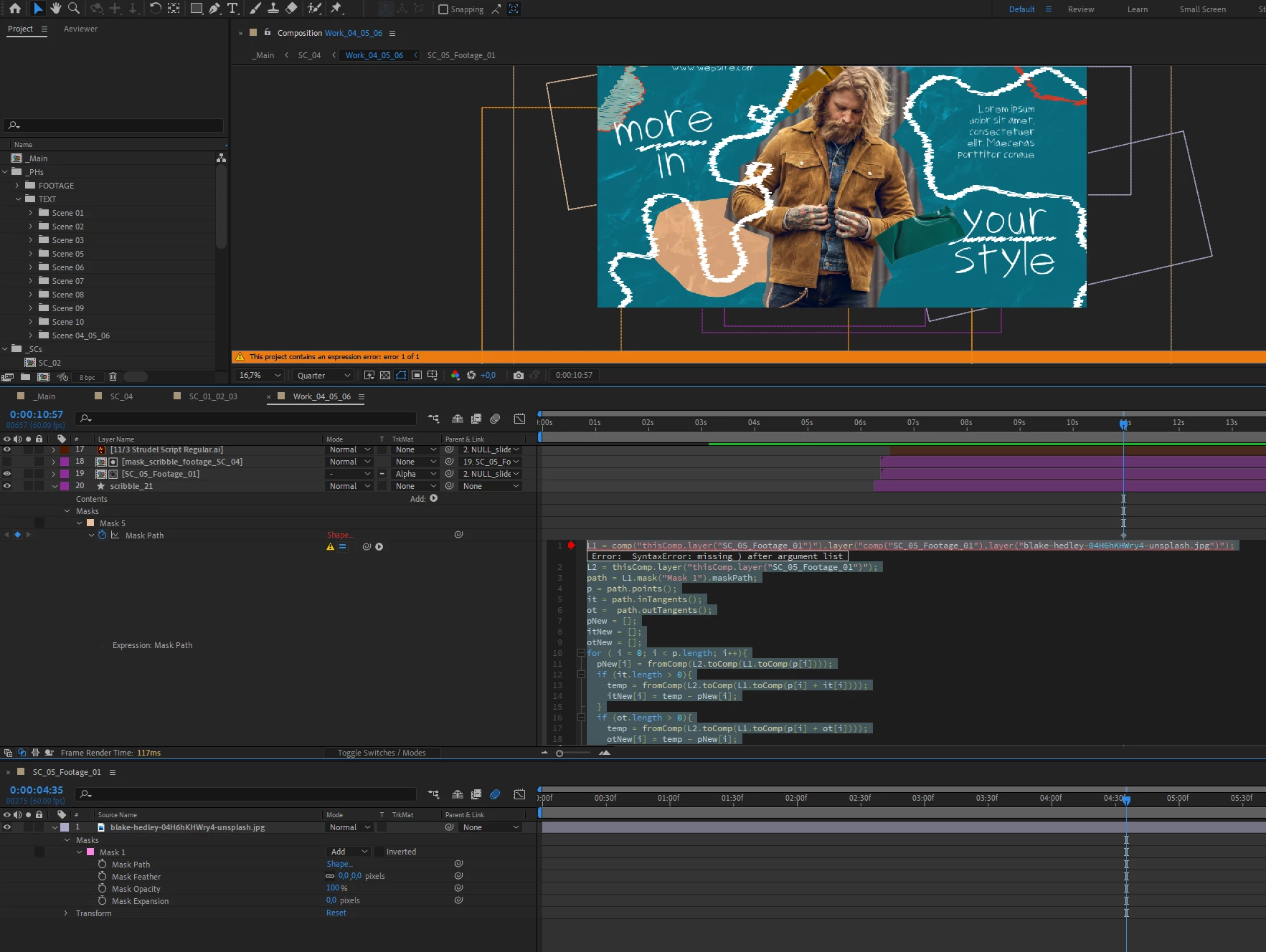

Dan EbbertsCommunity ExpertCorrect answer
February 14, 2023
So I ran a little test that seems to work well. You set L1 to the layer in the precomp with the mask you want to copy and you set L2 to the precomp layer in the main comp. In the main comp you would create a shape layer by clicking anywhere with the pen tool and paste this in for the shape path:
L1 = comp("zipper 1").layer("zipper 1.avi");
L2 = thisComp.layer("zipper 1");
path = L1.mask("Mask 1").maskPath;
p = path.points();
it = path.inTangents();
ot =  path.outTangents();
pNew = [];
itNew = [];
otNew = [];
for ( i = 0; i < p.length; i++){
  pNew[i] = fromComp(L2.toComp(L1.toComp(p[i])));
  if (it.length > 0){
    temp = fromComp(L2.toComp(L1.toComp(p[i] + it[i])));
    itNew[i] = temp - pNew[i];
  if (ot.length > 0){
    temp = fromComp(L2.toComp(L1.toComp(p[i] + ot[i])));
    otNew[i] = temp - pNew[i];
createPath(pNew,itNew,otNew,path.isClosed())

Thanks for the answer, but I couldn't repeat it in my project:
