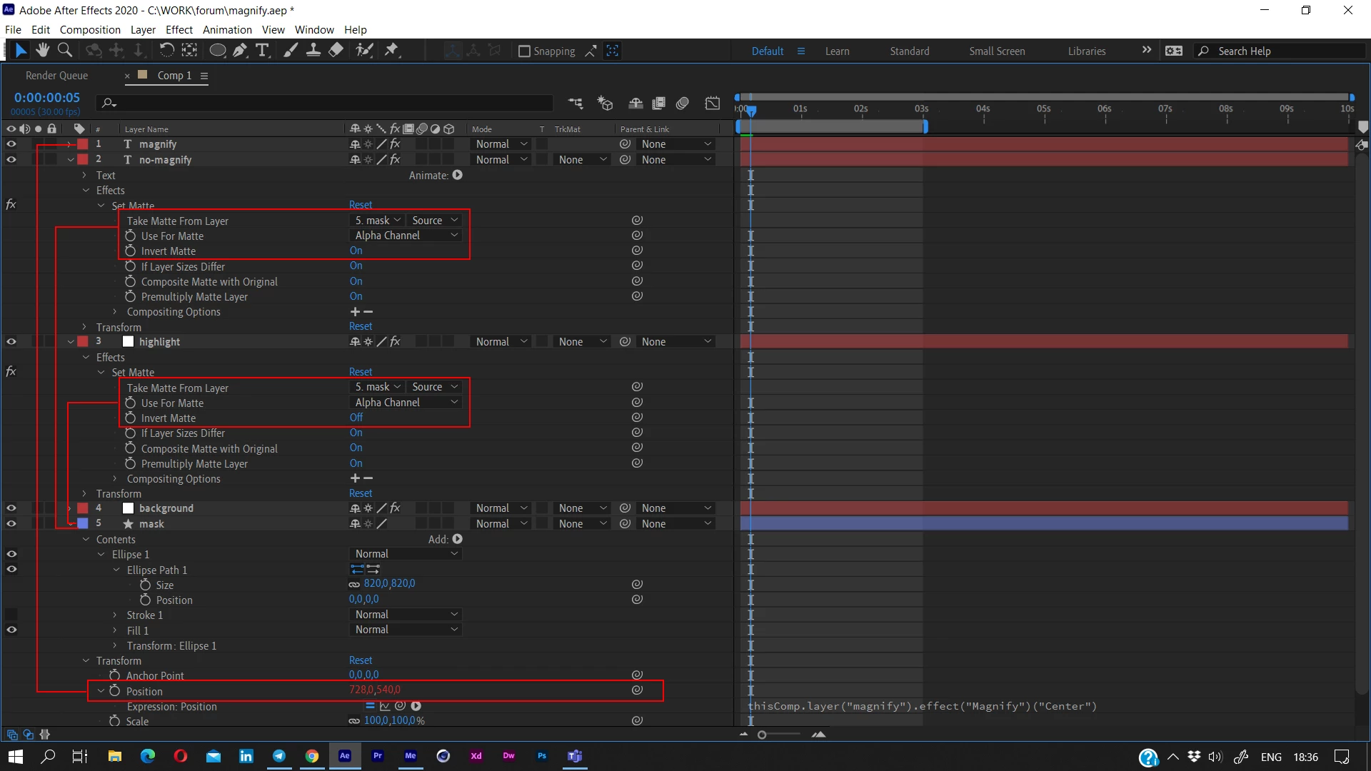

Anna Lander
October 27, 2020
I would suggest to double the text layer and use "Set Matte" effect for non-magnified text (inverted alpha) and highlight (alpha) with the same source layer (mask shape). This case you can control just 1 additional layer (mask), connecting it to Magnify effect center like Rick told before.

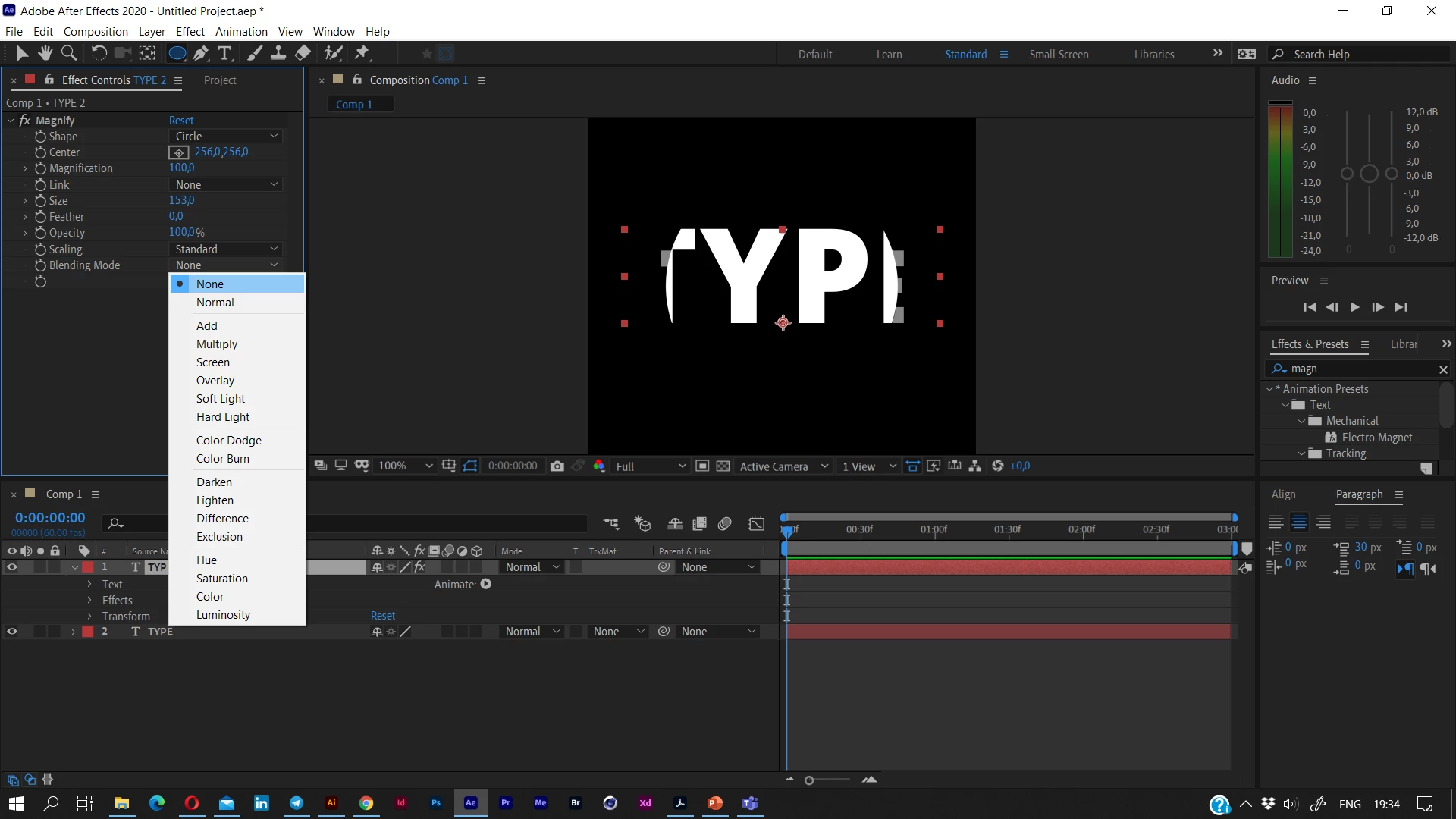

September 25, 2020
This also worked out. Thanks for your support! Actually I applied the magnifying Effect to typography. In the the magnified circle there is still visible the original sized typography next to the enlarged one. Is there a possibilty to make it dissappear?
Anna Lander
September 25, 2020
change the Magnify's Blending mode to None
(the second layer is added just for clarity, it's masked to show the outer part comparing the magnied one)

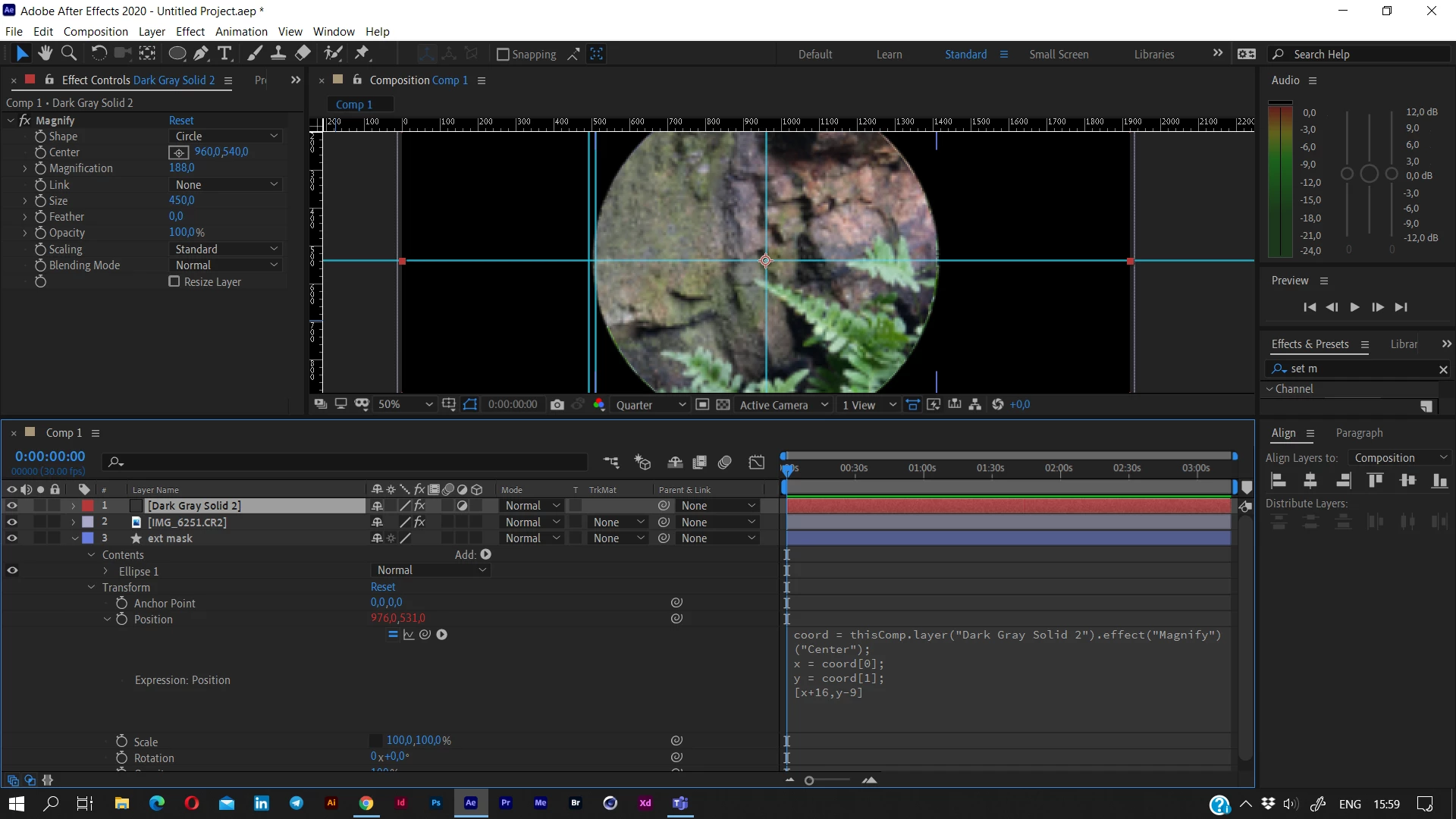

Anna Lander
September 22, 2020
yes, it's strange but the shapes slide a bit even if we connect the properties directly.
Here is what I tryed to co-ordinate them:
1. Created 3 layers —
  • Adjustment layer with Magnify effect (my settings are Center 960,540: Radius 450, Magnification by taste)
  • Image layer
  • Shape layer (Circle) for a mask with the same radius as the Magnify area (in my case Size = 900,900).
2. Applied Set Mask effect to the Image layer with Shape layer selected as a mask source (cause Shape layer is more controllable by expressions then the Mask path).
3. Linked the shape position directly to Magnify effect center.
After linking the shapes the slided a bit, so I edited the expression to correct it (see a screenshot)
PS. Null works the same way, the only difference is that you link both (Magnify center and Shape position)to Null and adjust 2 expressions.
