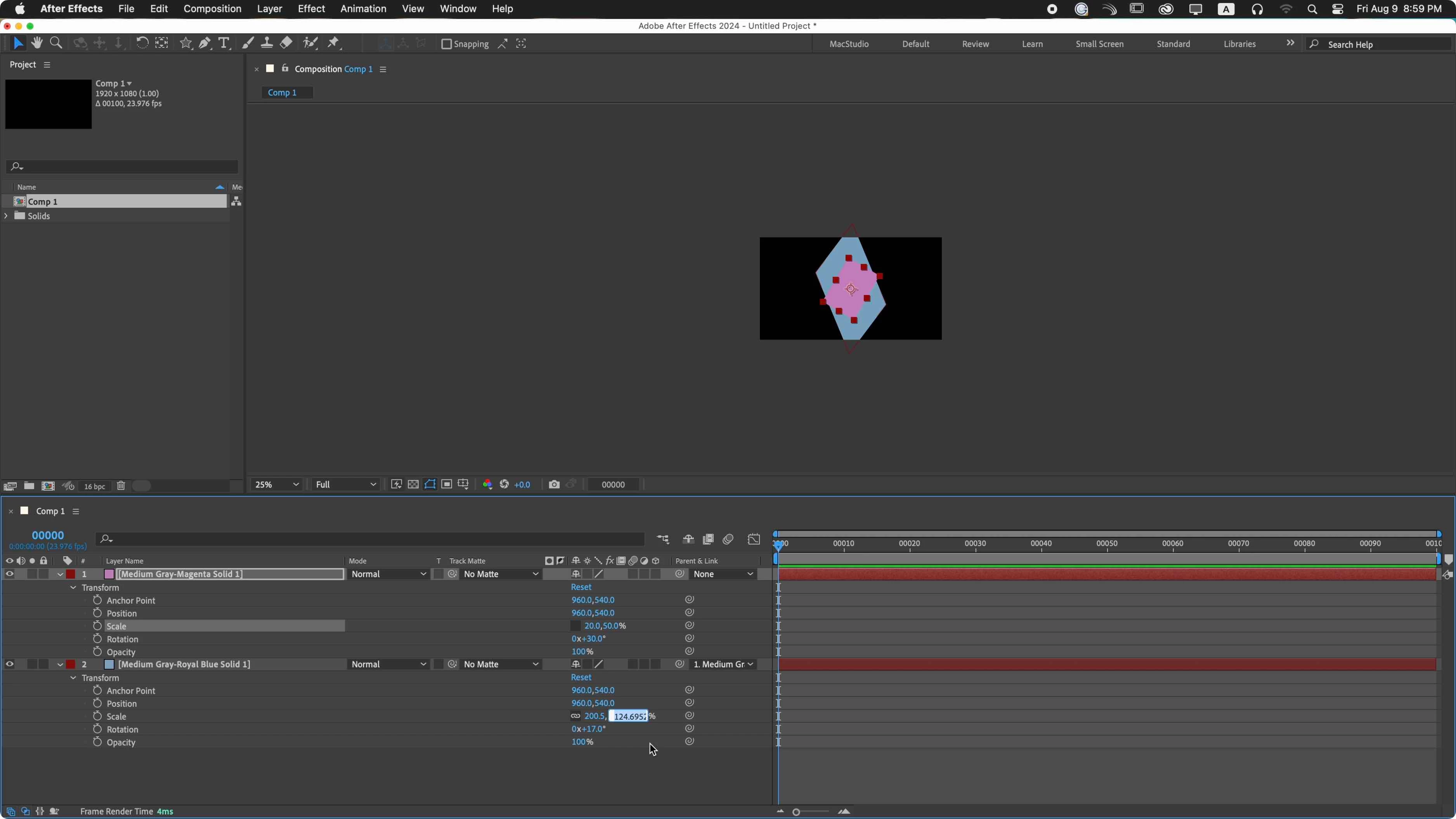

linking layer deforms child when parent layer has non-uniform scale + rotation
just noticed my duplicate later keep shifting when i link layer to hero layer.
tried on simple comp and i can repeat, so reporting as bug.
when i link a layer with non-unifrom scale and rotation, the child layer rotate and scale to change shape. when i unlink from the parent, it deforms again and won't change back to original shape.

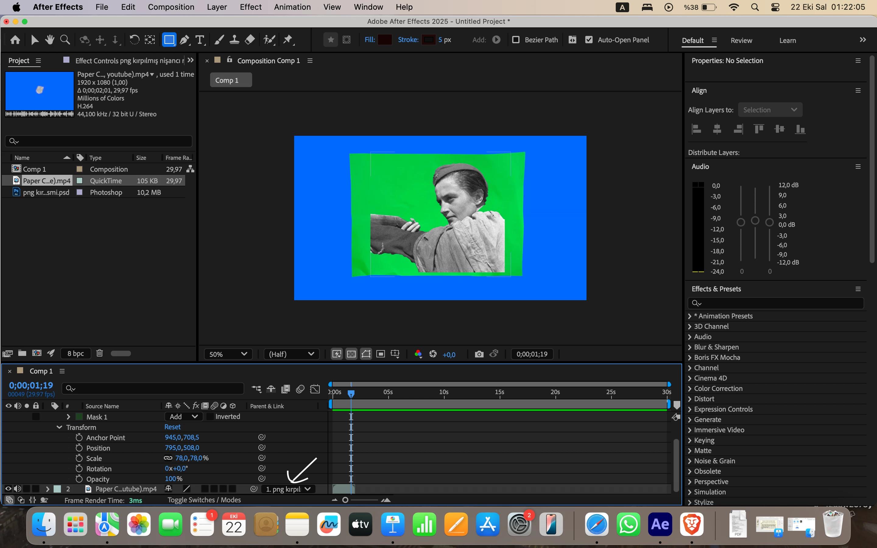

I will create a greenscreen with Parent and Link. Everything is ready. However, when I linked the photo to the greenscreen layer, the Parent and Link layer did not detect the greenscreen. No matter what scale I tried, it didn't detect it. Even if I fixed the color settings, it still didn't detect it.

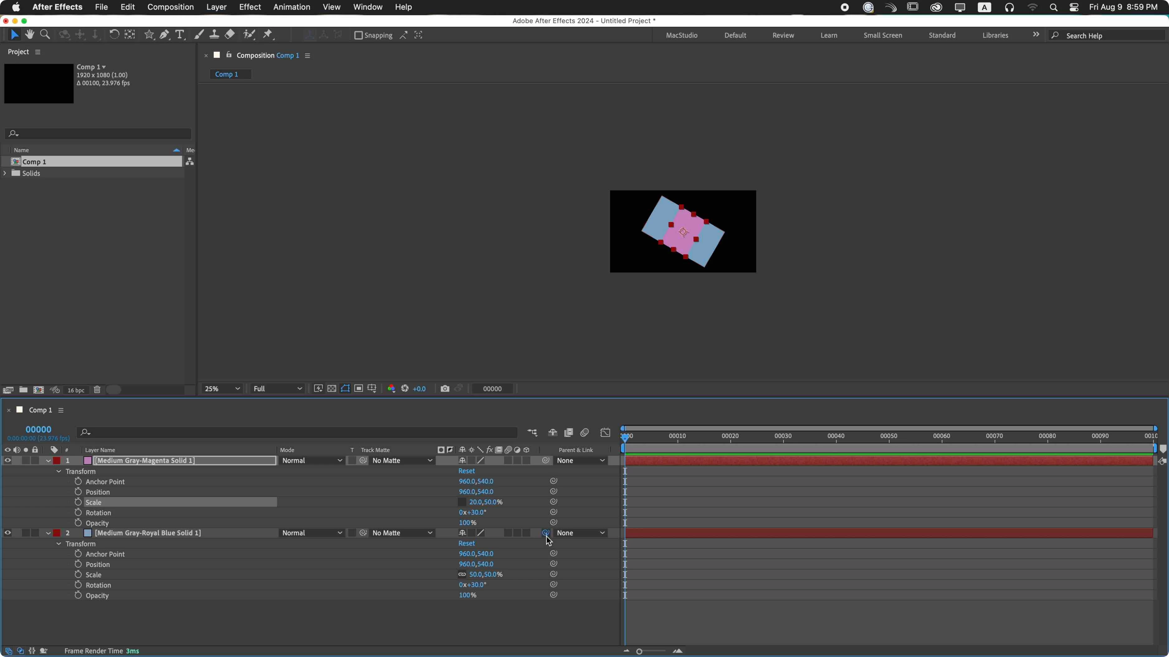

Roland Kahlenberg
Aug 15, 2024 7:58 PM UTC
This thread also has the solution and it's laid out quite clearly, if you haven't solved it - https://community.adobe.com/t5/after-effects-discussions/child-layers-distorted/td-p/10652220
Very Advanced After Effects Training | Adaptive & Responsive Toolkits | Intelligent Design Assets (IDAs) | MoGraph Design System DEV
takashi vfx
Aug 10, 2024 3:40 PM UTC
Thanks for the link. Now I kinda remember I had to precomp the layer before linking or use another null.

takashi vfx
Aug 10, 2024 6:14 AM UTC
linking layer to other layer as parents shouldn't change the shape of child layer.  not sure if you are familiar with after effects.

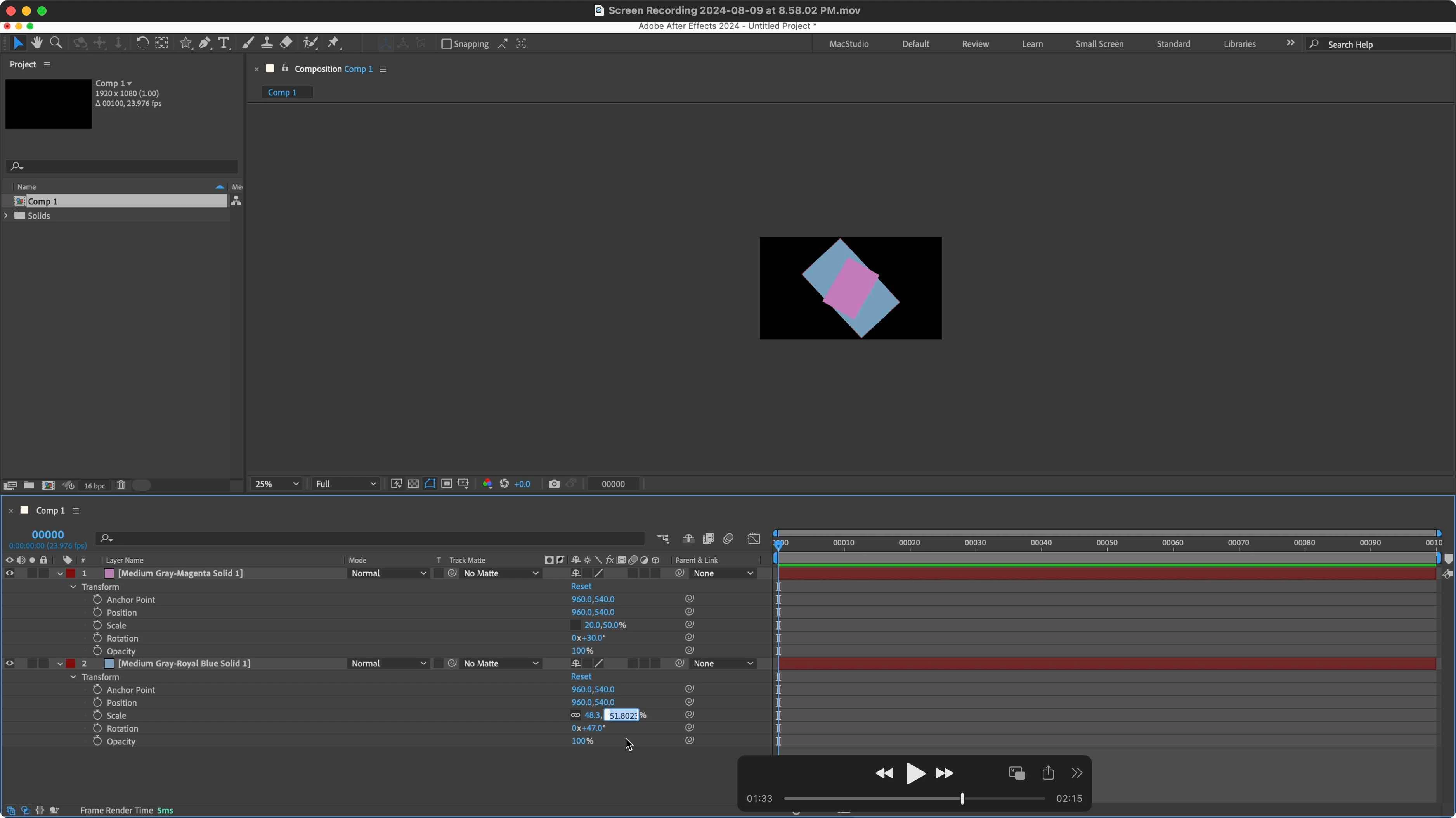

Aug 10, 2024 6:02 AM UTC
I don't think it's a bug. Since the calculations involve percentages,
they aren't necessarily reversible.
It's like if you have $100 and you add 20%, you get $120.
But if you then remove 20%, you end up with $96, not your original $100.
It must be somewhat the same thing here.
